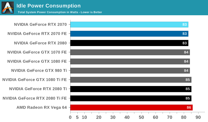

If your usage didn't change between PC and Mac Mini M1 then your PC was mostly idle with a consumption of about 83W.

I will attach a chart here showing the drop.
