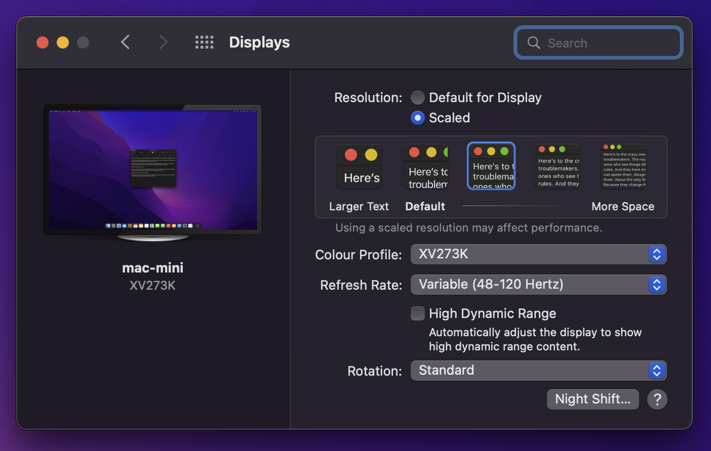

Update here everyone, I have just updated my macOS Monterey and I found something in my Display setting panel which I uploaded below:
It seems that I can set my XV273K with Variable Refresh Rate, just like ProMotion feature?
Reactions: 410 and Boomhowler
Krevnik
macrumors 601
Sep 8, 2003
4,101
1,312
Yes. Apple did have talks at WWDC about supporting AdaptiveSync (VRR) in macOS 12.
joevt
macrumors 604
Jun 21, 2012
6,967
4,262
The XV273K has this in its EDID:
Code:
  Vendor-Specific Data Block (AMD), OUI 00-00-1A:
    Version: 1.1
    Minimum Refresh Rate: 48 Hz
    Maximum Refresh Rate: 144 Hz
    Flags 1.x: 0x00
