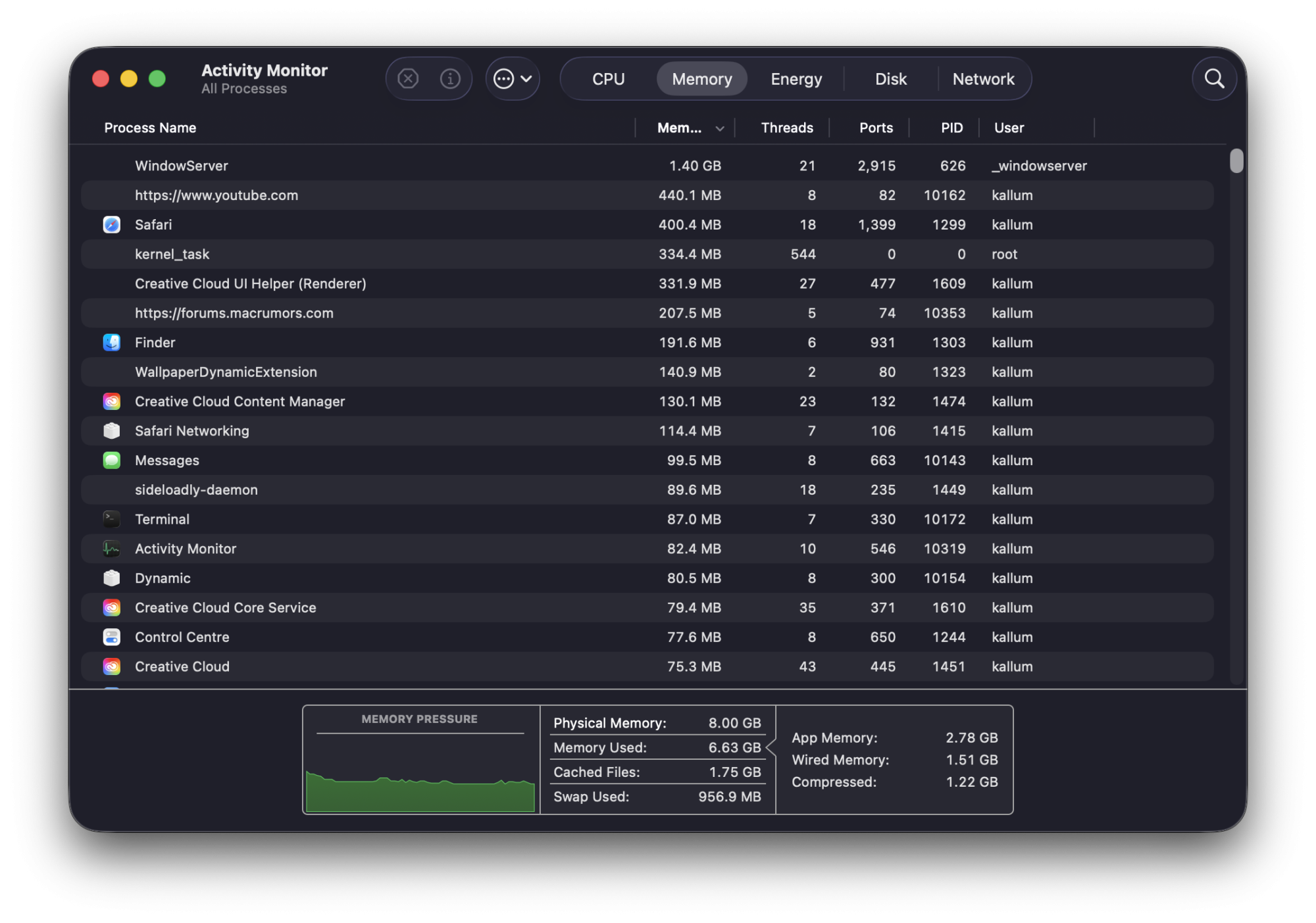

think I'm gonna try a fresh install since I updated to it
