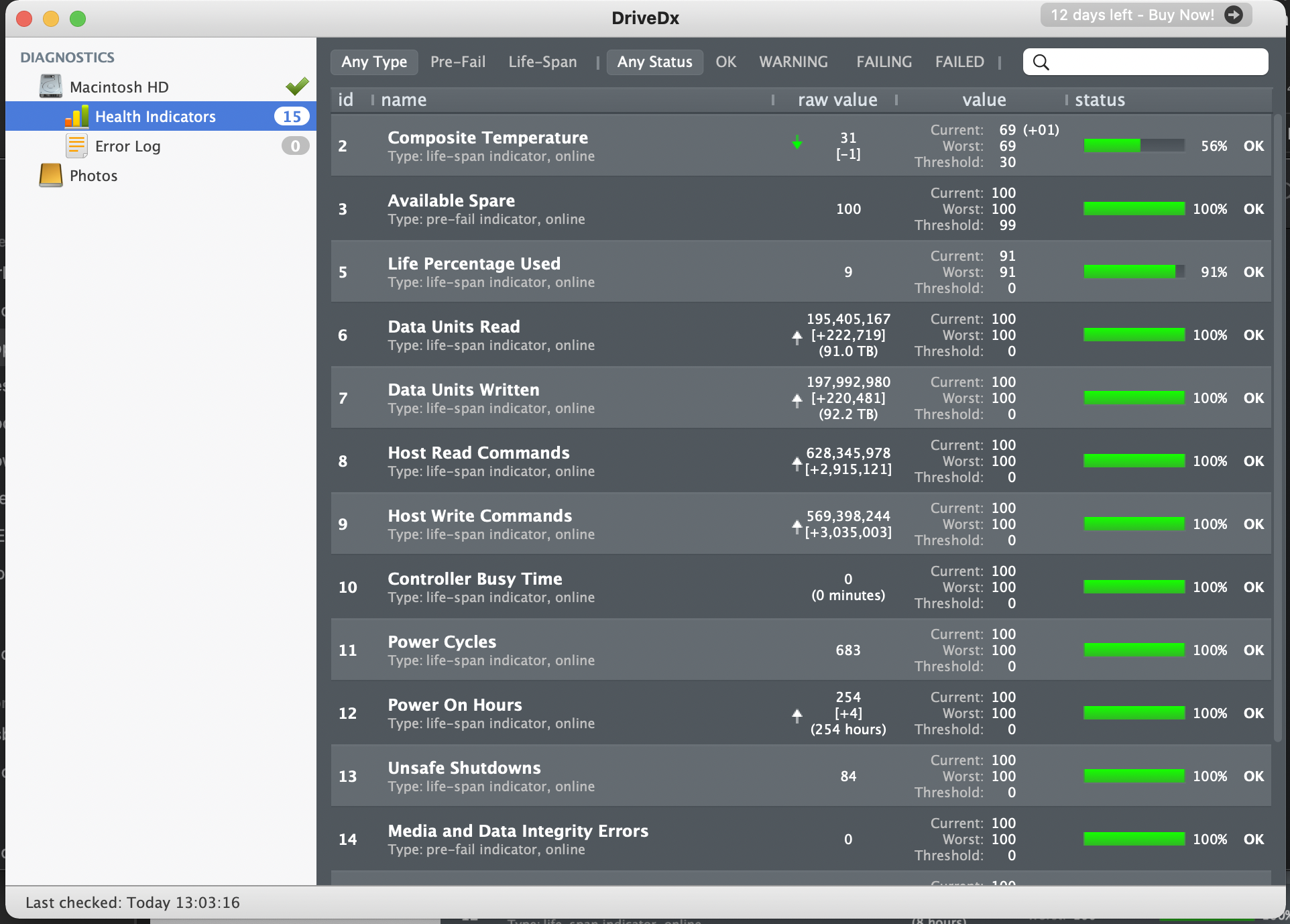

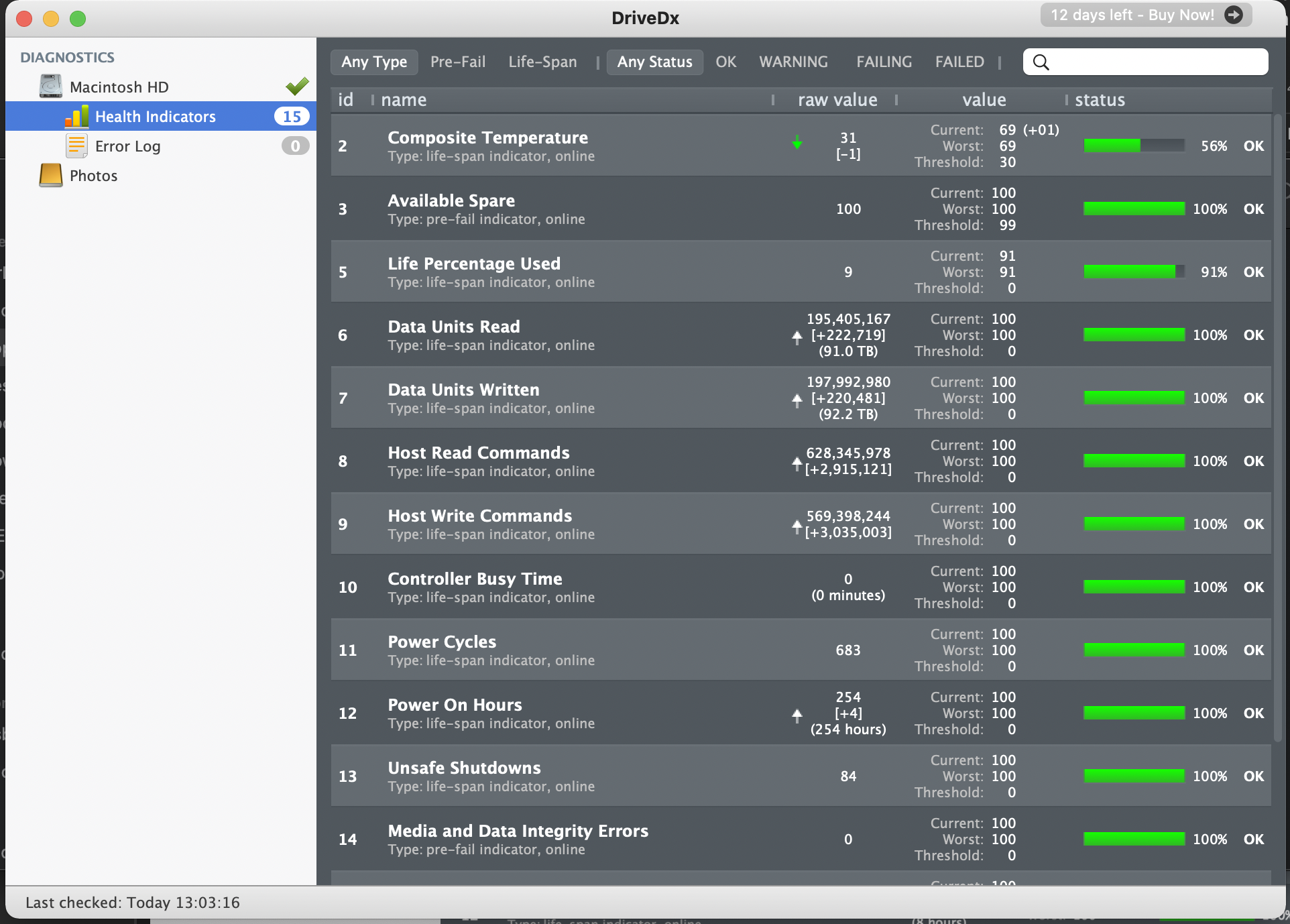

I am at 92TB written and I've had this machine for only 30 days so far. I too am worried about using my machine with Lightroom and other editing apps for fear of doing damage to my SSD before an update is released. But I also can't avoid using these apps indefinitely. Quite frustrating.
Thank you!!! if the laptop lasts more than 4 years with normal wear and tear I would be happy!
I have a 2011 MBP that I replaced the HD to SSD about seven years ago and it is my daily driver. It is getting long in the tooth, but for what I do, it works like a charm. Knock on wood no video or MB issues... knocking really hard right now lol
Reactions: tollickd
What’s your SSD size?
And how the percentage is calculated?
Somebody posted in other thread that he has -10% with 150TBW. On 256GB machine.
And and yous is 9% for 90TBW.
Whats the math?
