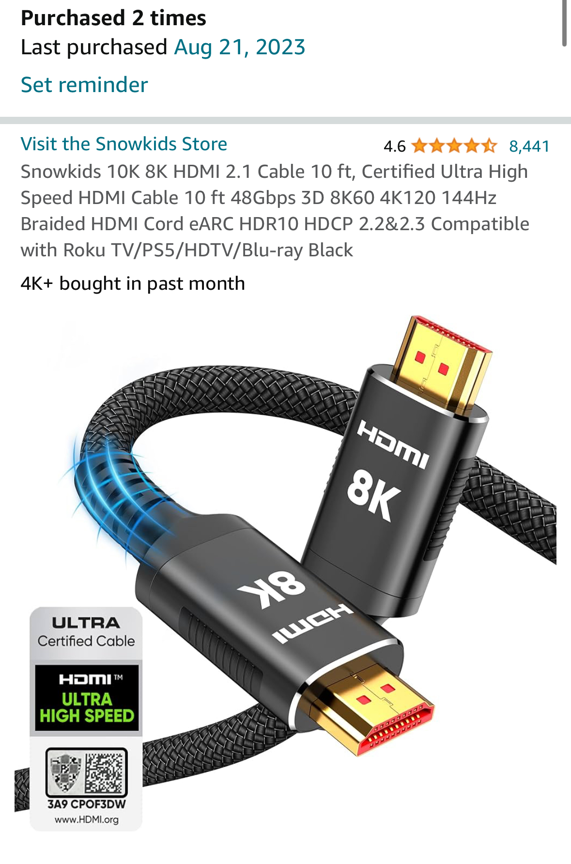

Was it certified with the appropriate logo on the box?
Unfortunately I threw away the box but this is what I bought from Amazon. It does support 4k 120hz in my Xbox Series X, gaming laptop etc. hence I have no issues using it with other devices with full HDMI 2.1 capability with zero issues only except my macbook pro m1 pro.
Snowkids 10K 8K HDMI Cable 2.1... https://www.amazon.com/dp/B09HXPCN1M?ref=ppx_pop_mob_ap_share

When a cable is certified it is usually shown in the Amazon listing pictures and description. Don't see it.
Understood, but what does that have to do with only the MacBook not acting up versus all the other devices that output just as fine? Just trying to ask a genuine question here as all the other devices were perfectly compatible by outputting 4K at 120 Hz even, whereas the MacBook wasn’t even able to output 120 Hz at 1080p.

Ok, actually it seems like I did buy some cables with a certified logo. See the attached photo.
Let me see tomorrow if that was the cable I used or if not I will try to use it and see how it goes. If it still doesn’t work likely Macbook m1 pro is just not capable of a true 2.0 hdmi.
Different hardware, different port electronics. Eliminating the cable as a variable just allows isolating the problem to the 2 ends of the cable.
