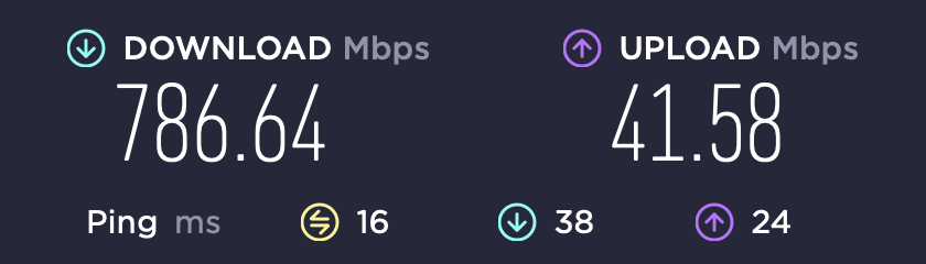

Not sure if this is embarrassing or not... but the Apple technical expert didn't spot it either.
A few months back I took a subscription to Express VPN so I could watch UK football matches that weren't being broadcast in the UK. Connection was really flaky so I cancelled, and deleted the app. Unknown to me, the app left a VPN setting in Network Settings. Deletleted this and normal service has been resumed. Still not quite as fast as the old MBP but double the speed i had before.

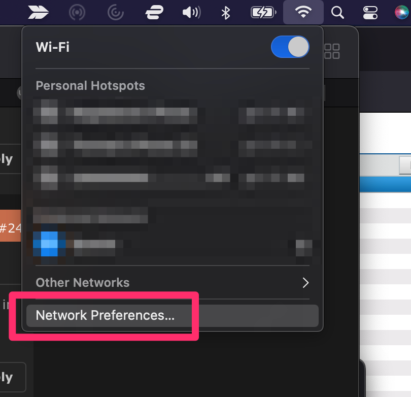

Here's what made my MacBook Pro M1 go from lagging Wifi to insanely quick connection. It feels like the site is loading before I even press enter:
Step 1
Step 2
I hope it helps!

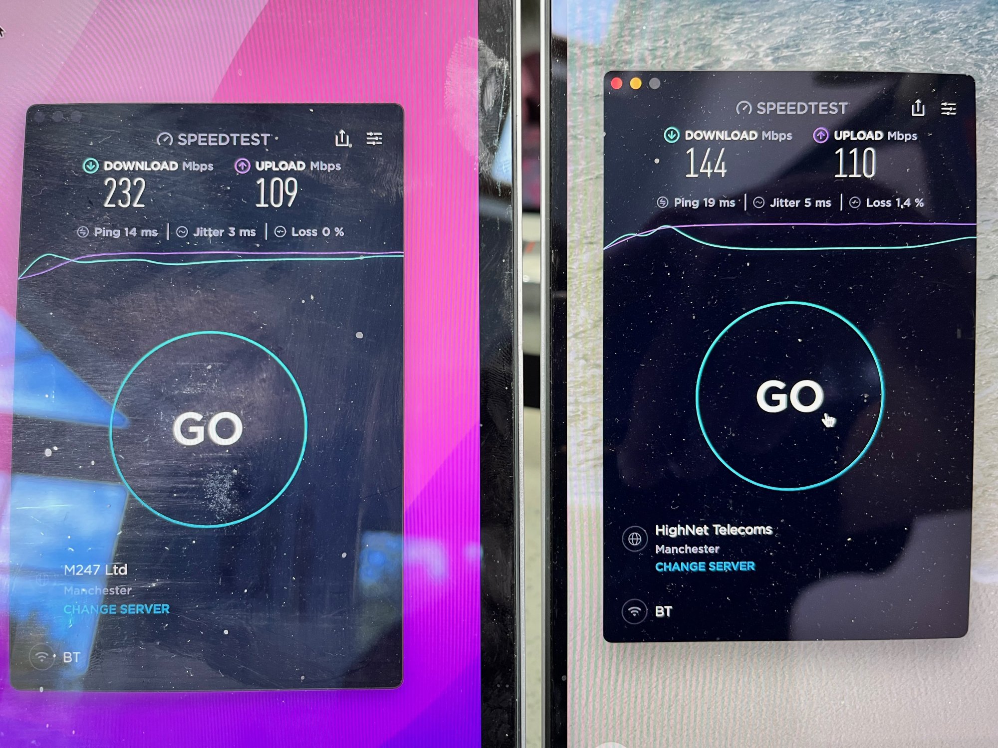

Side-by-side test.
2017 15" MBP on the left, M1 Pro on the right.
900 Mbps fibre connection, 5 metered from router
Any ideas?

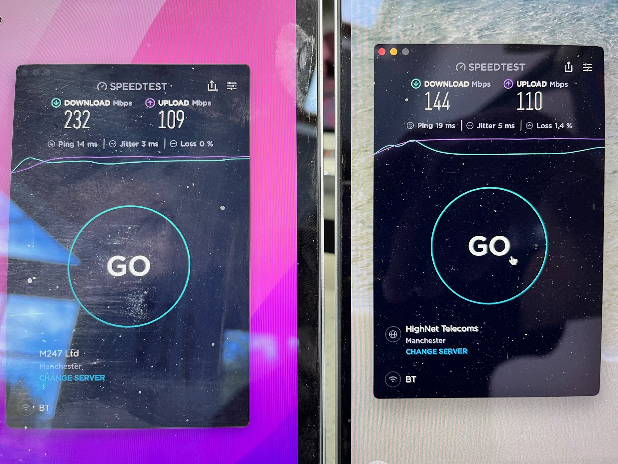

Side-by-side test.
Any ideas?
Going through different servers if you look at the bottom. Do you get the same result if they go through the same server?
I could run the test through the same server, but that wasn’t a one-off. I’ve run the test a dozen times over the last few months. The M1 has never once even come close to the 2017 Pro

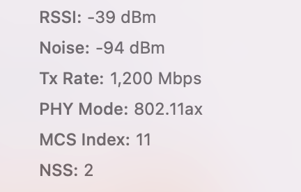

I'm too having WiFi issues with the M2 Air. Is the only device giving me trouble.
Sometimes I just notice that internet is really slow and then check the connection (Option + click on the WiFi icon).
At that point two things happened: the TX Rate is under 250 Mbps (and doesn't change) or the Mac is not longer using the AX protocol and is back to AC.
For the first case a restart fix the problem, for the second I need to forget and reconnect several times until it
pegs to the correct one. 😵‍💫
Working well now:
Any ideas, please?
You haven't reported safe mode boot results. What happens if you login on a new user account.

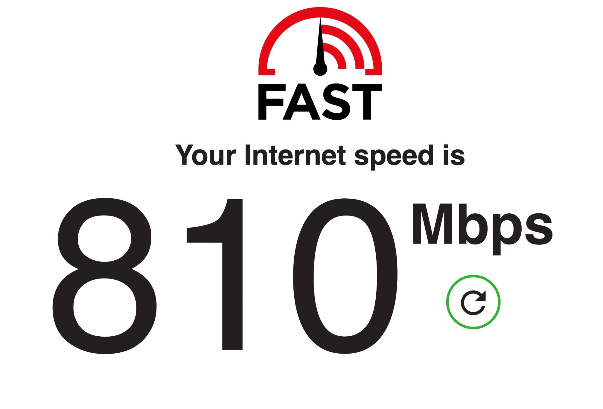

Turn off AIRPLAY RECEIVER! Went from 200 Mbps down to 800 in an instant.
