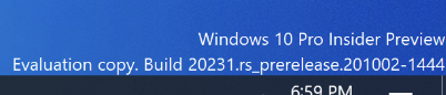

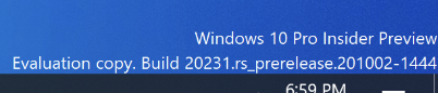

Here is my need:
Install Win10 (WoA) via Parallels.
Enter my activation key - and have the version without watermark in lower right corner on the screen that says:
Are you saying that you dont have this?
I stopped Windows Update - but at certain point you have to allow it on Insider Preview - or they will stop working.
I saw no option to control the Win Updates (despite Pro version) - so thats why I stopped using WoA.
Finally - for me only VHDX image worked. I tried to install regular WoA ISO (pre 20231 build) on Parallels - but it gives error on booting.

Oh yeah, I still have the watermark because I'm still on a pre-release version. Once it's licensed, then you have the ability to stop the fast beta channel and move to one of the slower beta channels. I'm staying on the slow insider ring just because all of this is still working in beta anyway. I'd rather utilize a newer build of Windows.

You can activate it with a Win10 Pro key, and the eval copy message should go away, but all the builds we get for WOA have an expire date, even if you turn off insider builds.
