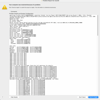

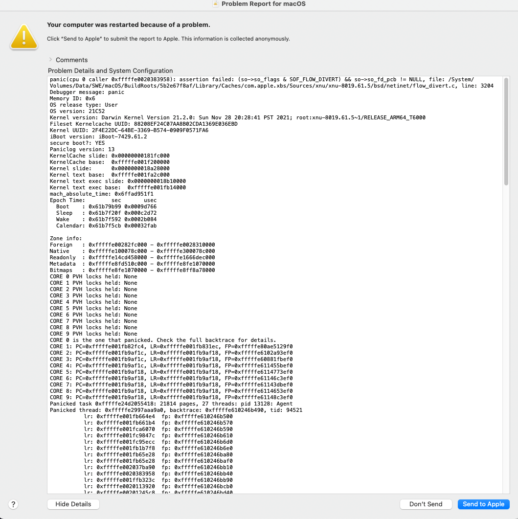

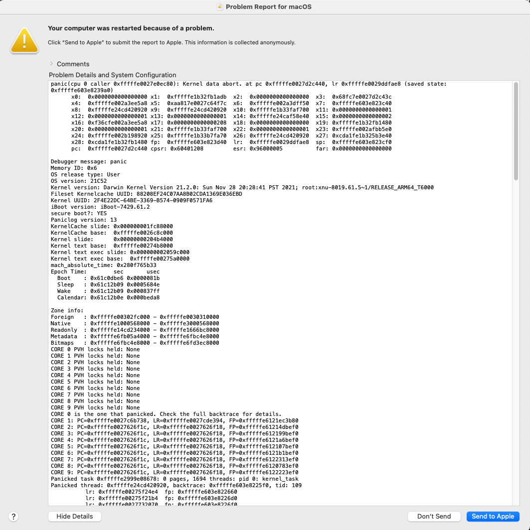

Hey folks,
I left the MBP M1Max for about 30mins while I had dinner. Only Safari and Edge were open with a youtube video paused. I came back at it was at the login screen. Panic were common last week when I had a thunderbolt 3 dock attached and the computer went to sleep.
Is there anyway to decode these panic logs? I tried to talk to AppleCare chat support but they didn't know how to read it.
This will be kernel panic #6 since mid November. :\

You have the core 0 panic and the log also include the id of the task too.
