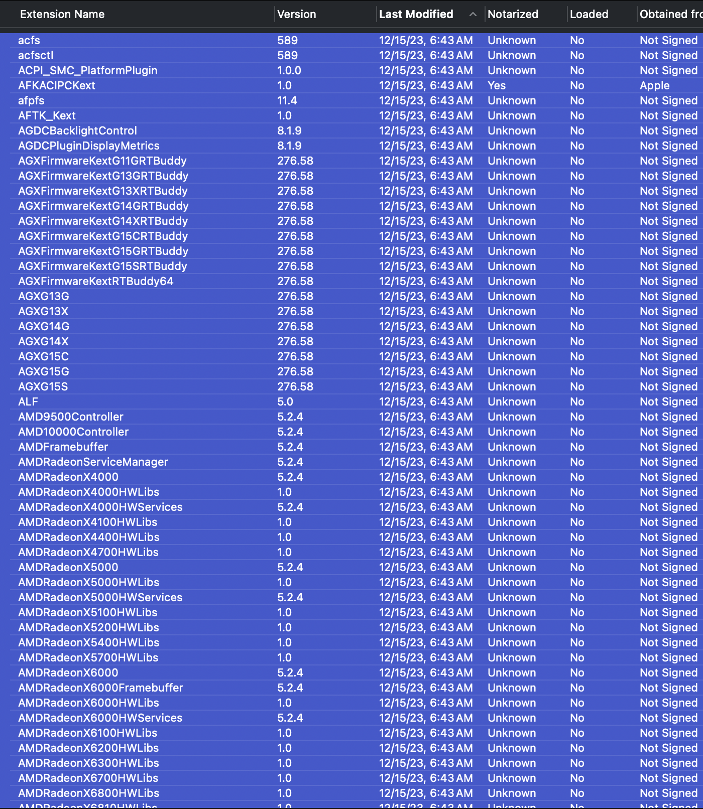

Can you go into Applications -> Utilities -> System Information
Once you open the app, on the left side under Software will be "Extensions". CLick on that and sort them by "Last Modified" - usually all the extensions that come with macOS will all show same date/time for when you last did an OS upgrade/update.
Any extensions that aren't bundled with macOS may have a different last modified date. What do you see? Any suspect third party kernel extensions?

Hi, so on my old Intel iMac I did not install any new software's before doing the time machine restore onto the new mac mini. Everything had been left behind for years so it was just a transition from one computer to another.
I went ahead and looked up the extensions and the screenshot I provided is only half of a large list of the same date being 12/15/2023. Which is I believe around the time I got the new iMac mini and started to use it.
The second chunk of extensions with a different date are on 01/01/2024, so there are only two main dates in here.
