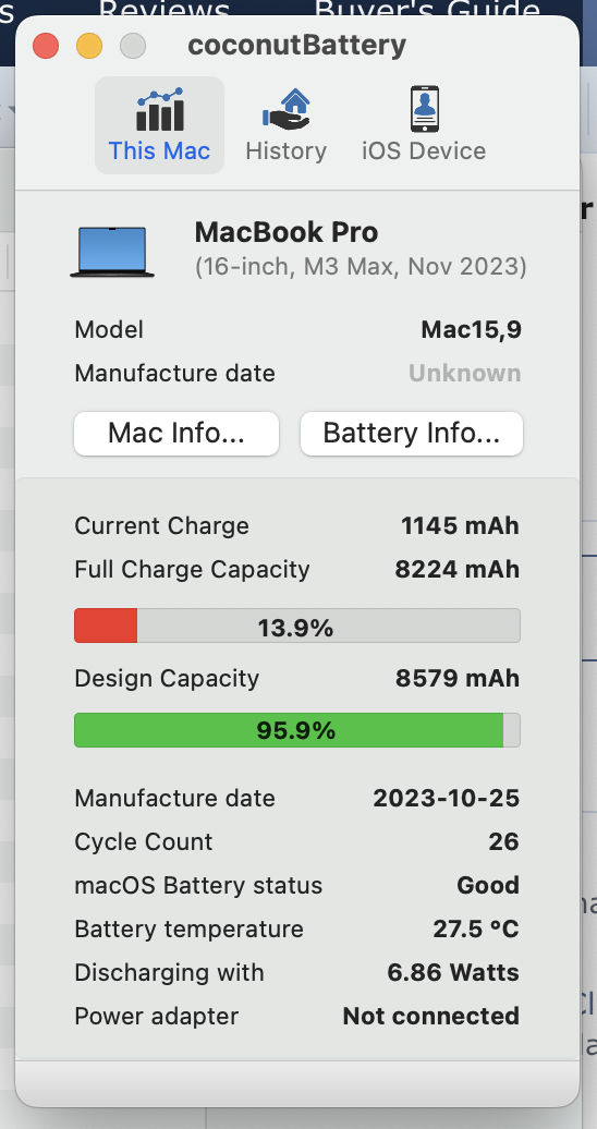

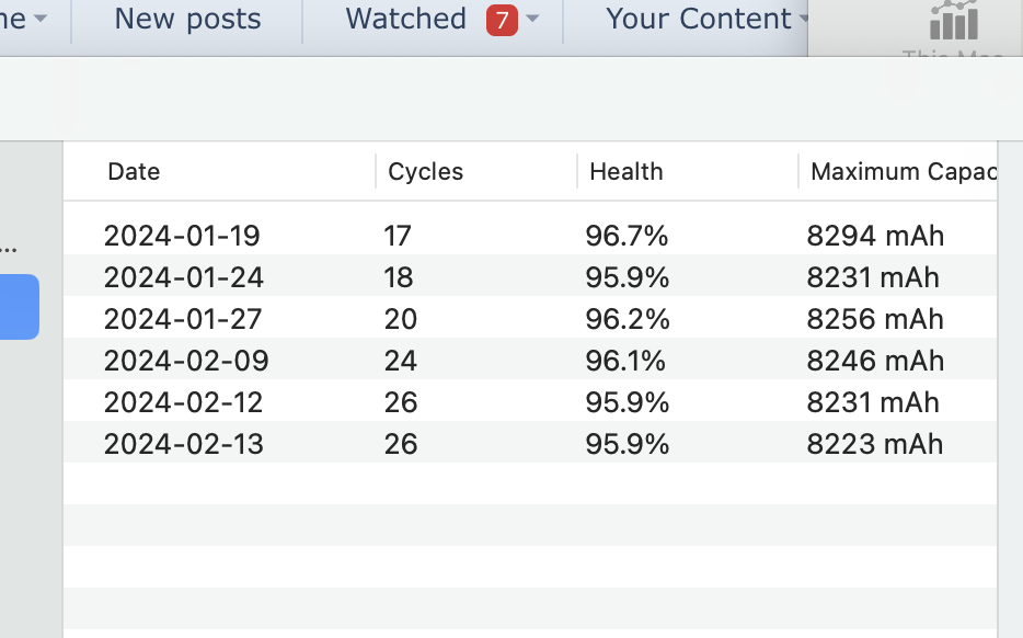

Hey all
Need a little help resting my mind on what might be a non-issue. I've tried apple support and they cant grasp what i'm saying.
Got a M3 Max 16/40 64gb/1tb which i bought brand new in November and on installing coconut noticed the full charge capacity has dropped to 96% since i had it.
I have no idea what it was out of the box but it seems to be stable fluctuating around 95-96%. If it stays like that for a year or 2 i'm happy but if i drops 4-5% every 3 months obviously thats no good.
My question is, is this a the norm? I'd expect 100% from new dropping a percent every couple of months. Never paid any attention with my 2015 model which i also bought from new..
Started to run AlDente Pro last month capping at 80% and the figures are mirrored on that.
Thanks in advance

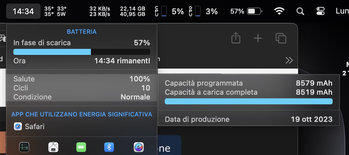

You can also go into System Report and look under Power. There should be a health rating there below the cycle count. Coconut battery gives me 94.5%. System Report is giving me 97%.
I don't know which one to believe, but I'm pretty sure Apple won't honor anything based on Coconut Battery.
Reactions: MilaM
There is, that says 99% which to be honest i'd expect and be fine with after a few months of heavyish use.
Good point. I totally forgot that MacBooks now show battery health in settings.
Here are my numbers from the M1 MacBook:
Cycles: 59
Battery health (macOS settings): 100%
Coconut Battery: 95 %
The number from the Coconut app changed a bit since my last post 🙃.

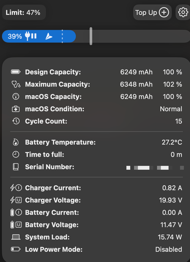

Use the calibration in AlDente Pro or just run it down yourself and back to 100%.
I've seen batteries swing up to 5% and 2-3% is not uncommon.
The microchip on a lithium ion battery makes capacity estimates based on continually observing voltage behavior through use. Over time, if operated in a constricted range then that estimate loses some accuracy.
All that said, batteries can come out of the factory with a bit less or more capacity than designed. So it could simply be the case you got a somewhat under capacity battery rather than it dropping like a rock.

Just a follow on to this, its jumped up to nearly 98% this morning. Panic over i think, i'll keep my eye on it and report any big changes.

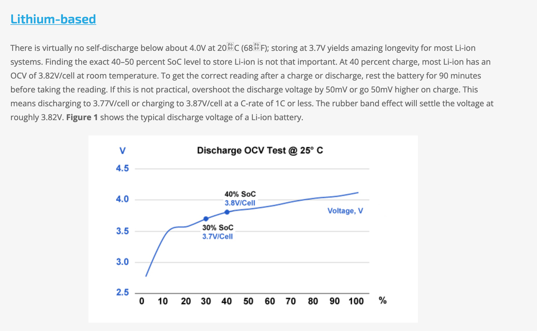

Using aldente and keeping the battery at roughtly 40% when I don't need it has been doing quite well.
If you didnt know, 40% is the ideal charge level for storing a Li-Ion battery. 40% and cool.

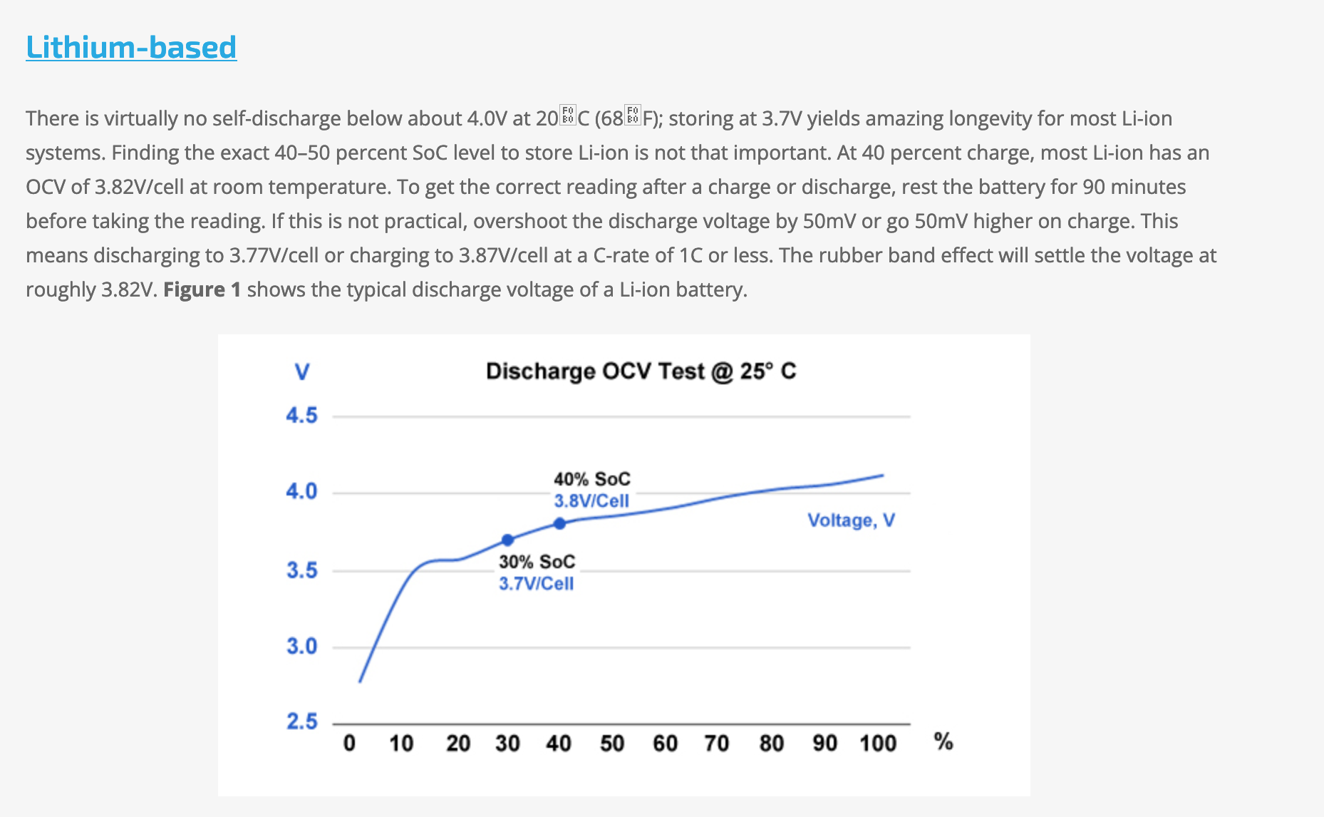

Where did you see this? Battery university claims 3.92V per cell, which translates to 65% on their charts.
"In terms of longevity, the optimal charge voltage is 3.92V/cell. Battery experts believe that this threshold eliminates all voltage-related stresses; going lower may not gain further benefits but induce other symptoms"
3.921,200–2,00065%
Reactions: macroumers
3.921,200–2,00065%
It was on the same website, how to "store"Li-Ion:
Reactions: HDFan
It looks like what I quoted, when following the associated link for associated issues, may just be for EV usage - they mention 3.92V being a threshold for graphite accumulation on anodes.
So I stand corrected - unless there are other issues for active usage vs. long term storage, but I can't find anything.
