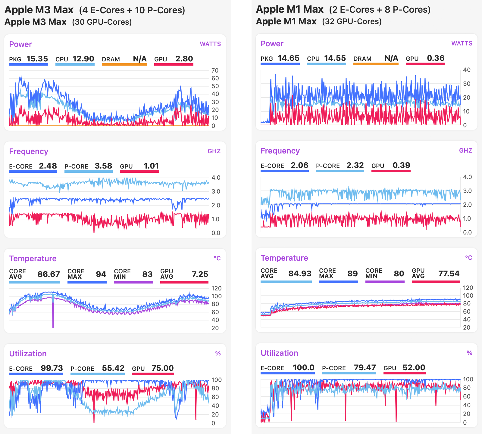

Here are screenshots of what I’m seeing... the width of the graphs represents about the first 5 minutes or so of the export. Note the “sine wave” temperature of the M3 Max compared to the gradual rise and relative flatness of the M1 Max temperature, and the substantial and prolonged dip in the M3 Max’s performance cores utilization, compared to M1 Max that, although fluctuating, generally stays around 80%.
During the remaining few minutes of the M3 Max’s export (after this screenshot was captured), the temperature and CPU usage both level off at just a little bit lower than where they are at the right edge of this chart (still fluctuating, but averaging about 90 degrees C and 60% CPU).

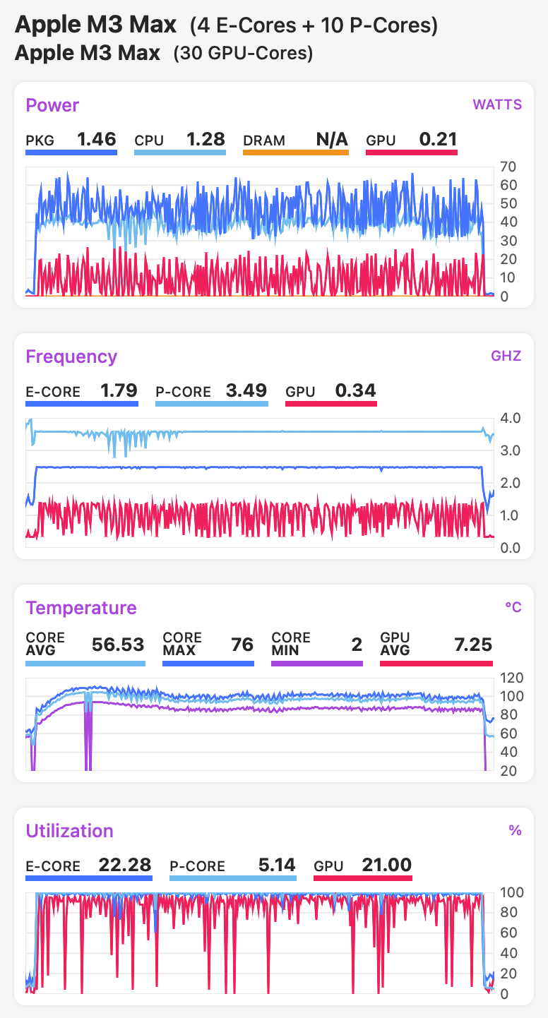

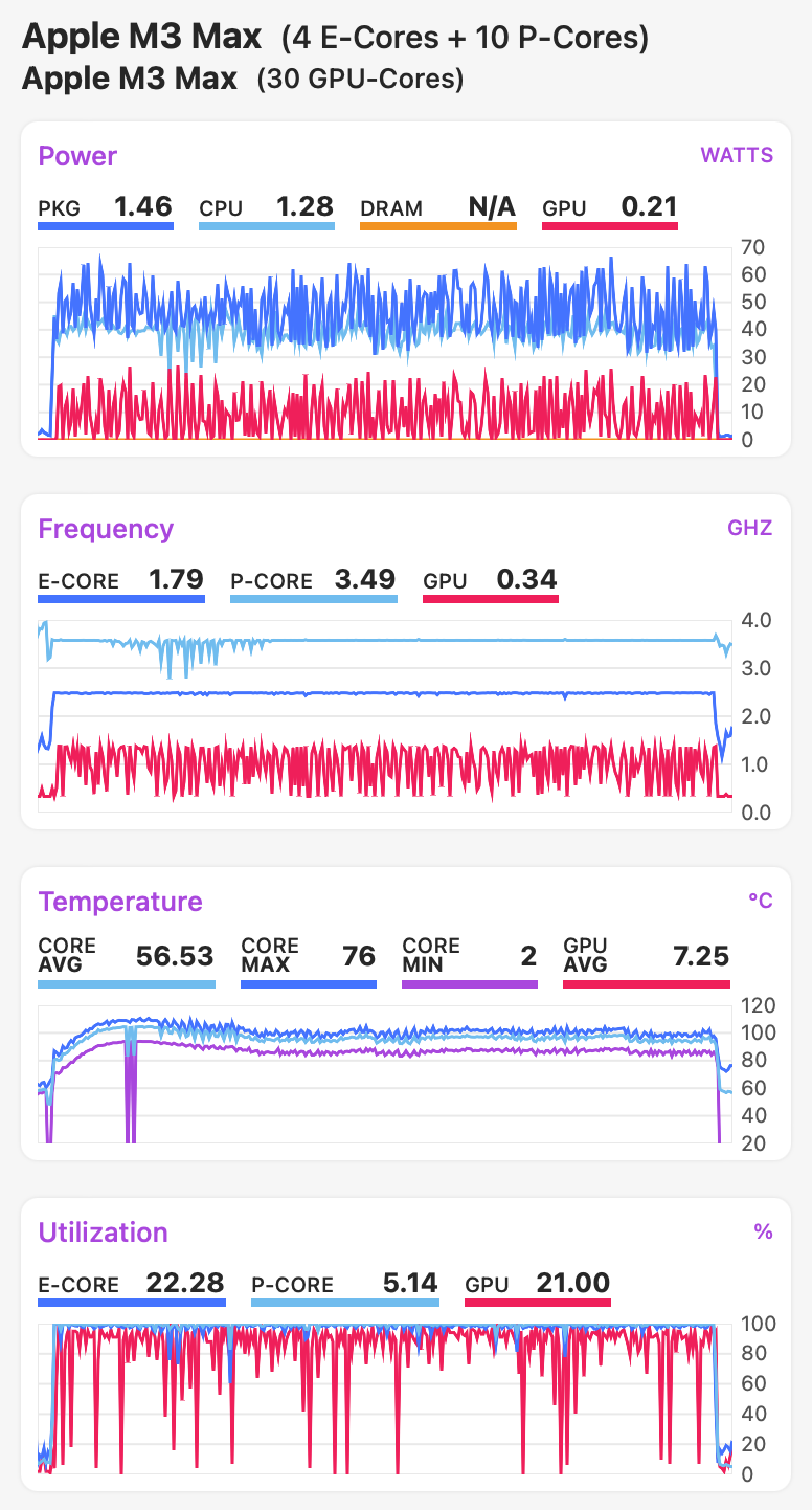

Ahhhhh.... your comment prompted me to try the export with LRCC (which I generally don't use because it's not conducive to my particular workflow). Those same 500 images exported in a bit over 5 minutes (which is the speed I was expecting), and the CPU/GPU were nearly fully saturated the entire time, without wild swings in temperature and utilization that I saw during the LRC export.
