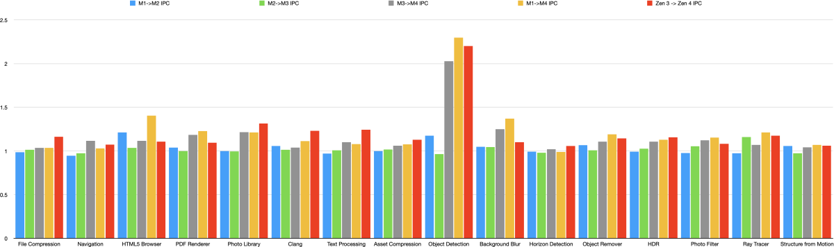

I'm a little tired so this is probably obvious, but how does this show it? Is it that the Intel Core i7-12700T has the AMX but the Intel Xeon w5-3435X doesn't?
The Xeon has matrix accelerators, and it also has AVX-512. One would expect the Xeon to run circles around M4 in math-heavy tasks because of AVX-512 alone, especially since single-core boost for the w5-3435X is 4.7 Ghz — 5% higher than M4 (let's ignore the tests that use the matrix coprocessor for now). But the passively cooled iPad is faster in every single single-core subtest. That is absolutely incredible.
diamond.g
macrumors G4
Mar 20, 2007
11,438
2,664
OBX
As an aside, does Xeon actually hit boost clocks in single core when using AVX512? I could have sworn AVX512 caused Intel CPUs to throttle. My searching is giving mixed results on this.
Not hitting peak clocks when running AVX-512 is pretty much the only explanation I can muster for it doing so poorly on these tests. Apple only has four 128-bit SIMD units, so the most M4 can retire per clock are 512-bit worth of ALU operations. But the Xeon should be able to do twice or even three times more.
I think what this demonstrates is how wide vector instructions are a dead end. What is even a point of having 512-bit processing paths if you have to slow your core down to a crawl to use them? That is just dumb design.
