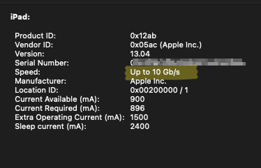

I thought the new M4 iPad Pro was supposed to be USB4/Thunderbolt. When I connect it to my computer (after selecting "Trust"), System Information shows that the iPad is connected using the USB 3.1 bus. I have it connected to my Mac Studio M1 Ultra Thunderbolt 4 port. What gives?
iPads have never connected to Macs for syncing over Thunderbolt- it’s always a USB connection. Thunderbolt connectivity is for devices like docks and network adapters.

This intercepts a question I had about cables. So even though the spec's say it is a Thunderbolt/USB 4 port on the M4 Pro it connects even to a Mac Studio Thunderbolt port as a regular USB connection. I can connect it to a Thunderbolt hub would that make any difference. I have certified cables in both Thunderbolt and USB-4.
Syncing with a computer will always happen as a USB connection regardless of the cable you use. Adding a dock in between won't change that.

It still does not make sense to me that the connection is a USB 3.1 connection. The specs indicate Thunderbolt/USB4 for the new iPad Pros. Even if the support is for a USB connection to the computer it should be USB4 then shouldn't it?
It's not how any of the M1/M2/M4 iPads with Thunderbolt/USB4 have worked, so presumably this is intentional on Apple's part.

Thanks...was hoping for much faster transfer speeds. I guess USB 3.1 will have to do.

Tested Thunderbolt 4 transfer Speeds using the $140 Thunderbolt 4 genuine cables. And it’s 800MB/sec well below the Thunderbolt Spec.
Besides as a person who grew up buying 100 CD’s at a time and burning “back up” CD’s to save my Data.
I’ll gladly just Restore my iPad Pro from a previous back up.

Even when you connect two TB4 equipped Macs, you still have to tell at least one of them to do something before they are really connected with anything Thunderbolt. I am talking about target disk mode which turns the Mac into a dumb drive, or Thunderbolt bridge networking.
To my knowledge the iPadOS can do neither of these, so connecting it to a Macs will fallback to a USB3.1 (10Gbps) instead. I myself have been backing up my M1 12.9" to Macs since the beginning, always used a TB4 cable, the speed is more than fine, especially when compared to Lightning (USB2.0 480Mbps...). I imagine for most usage the 10Gbps is fine.
Then I think a TB4 speed out of the iPadPro starts to be meaningfully useful when transferring video file frequently, which should happen quite often for people who uses FCPX on iPad, or shoot with the iPad camera and wants to transfer the files back on a Mac.
