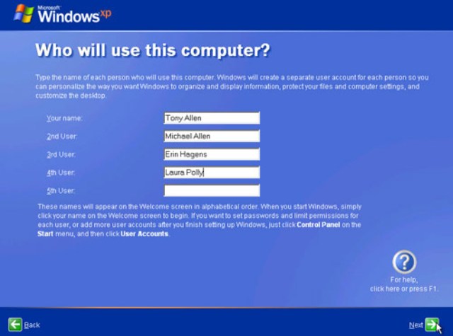

Hum, no. Most Linux distros force you to set the root password but only present an optional unprivileged user creation screen. Users are free to run as root all the time. HP-UX sets the root password during an ignite and nothing else.
Windows NT though since Windows XP has forced the creation of a user during install IIRC. OS X also forces it, but allows you to run it as part of the admin group.

With Unix /Linux /OS X with only one account set up that is administrator account but will need authentication out side user level . With windows with only one account you administrator / root and can do any thing with out authentication .
With windows to go on the internet you need standard or guest account (most home user do not do this) to force malware and behavior of the OS do not have permission to download or install programs .
With Unix /Linux /OS X you can go on internet with administrator account do to it need authentication root access to download or install programs in system level or making modification in system level .

Any of the Linux and OS X I use prompt for password when installing and removing programs or accessing system stuff like deleting or modify system files for good reason has security feature and deal with malware.
Note I was saying windows does not prompt for password when installing and removing programs or accessing system stuff like deleting or modify system files using admin account that most home users use.

I think the point nec207 is making is from a consumer end user standpoint. While in Windows logged in as administrator I can basically uninstall/reinstall programs to my hearts desire. If someone jumps on my computer while I am still logged on they can really do pretty much anything they want. When on most common linux distros (ubuntu, fedora, opensuse, etc) you are going to be prompted for a password when uninstalling things or making changes to system files (assuming they can even get that far). This is really besides the point though since we are talking about viruses/malware on the computer.
I think nec207 and KnightWRX are on two separate pages here.
