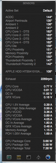

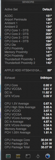

Just bought the 2012 Mac mini 2.3 i7 I think it runs seriously high. Playing steam games I can hear the fan kick in high, and when I look to see the temp its at 200°F at times. Sometimes I look and see 160- 170°F. I think that's a bit hot don't you? So whats a safe temperature for the 2012 mac mini, and whats you're about to fry your CPU temp? Does anyone know?
Hardware runs better, if we think higher temperatures are not ok? Why?
So whats a safe temperature for the 2012 mac mini...? Does anyone know?
The temperatures are fine as long as you can read the CPU/iGPU temperature via GUI-based tools on a display. That's a sign the integrated GPU works and has no problems with heat.
Those are normal mac mini temps. They are totally fine. 200F is 94C from memory. My i7 2.6GHz peaks at 100C when the CPU is maxed out. Most people I know run at that temp too. They are built to handle that temp.
There are a lot of threads on heat issue. The issue has been beaten to death with very minimal (none I remember) threads on minis falling dead from heat stress.
Philipma (forum member) did a lot of work/tests on this around December 2012.
I have run an i7 2.0GHz 24/7 for over two years and regularly run it at 100% CPU. It is just fine.
Stay cool.
