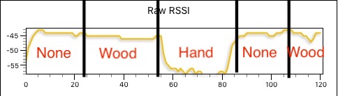

Hmm… What BT peripherals are you using? And where are they located with respect to your BT dongle mounted under your desk?
FWIW the line of sight issues I’m testing involve hands, legs, etc. IOW materials with a high percent of water. If i place a 1/4” thick piece of dry wood between the keyboard and the BT dongle there is almost no change in the Raw RSSI but placing a hand in the same position lowers the Raw RSSI a lot more. And so far in my testing the Raw RSSI graph has been a pretty good indicator of when I see keyboard disconnects and flaky keyboard behavior (missing/delayed keystrokes, repeated keystrokes, etc.)

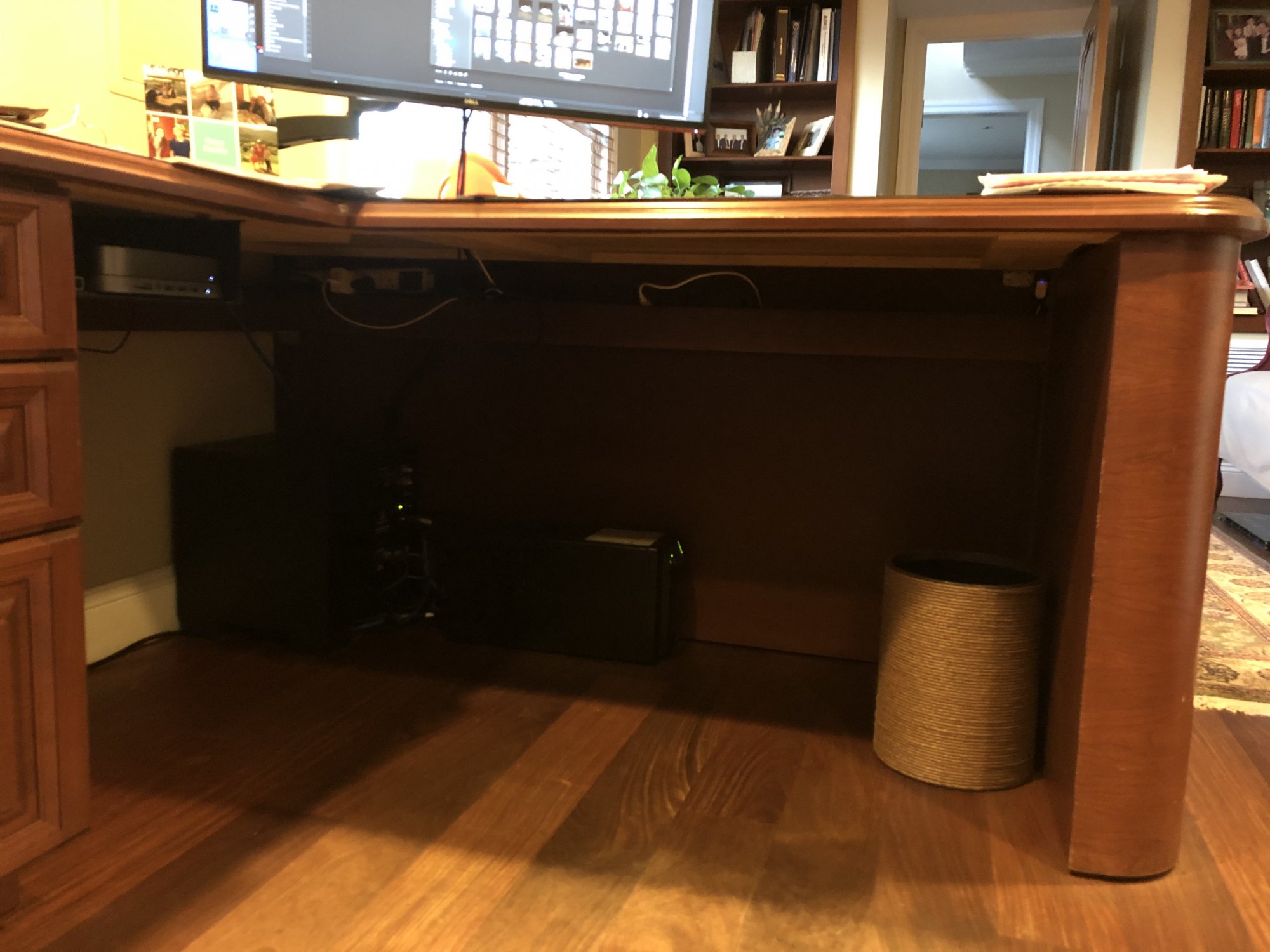

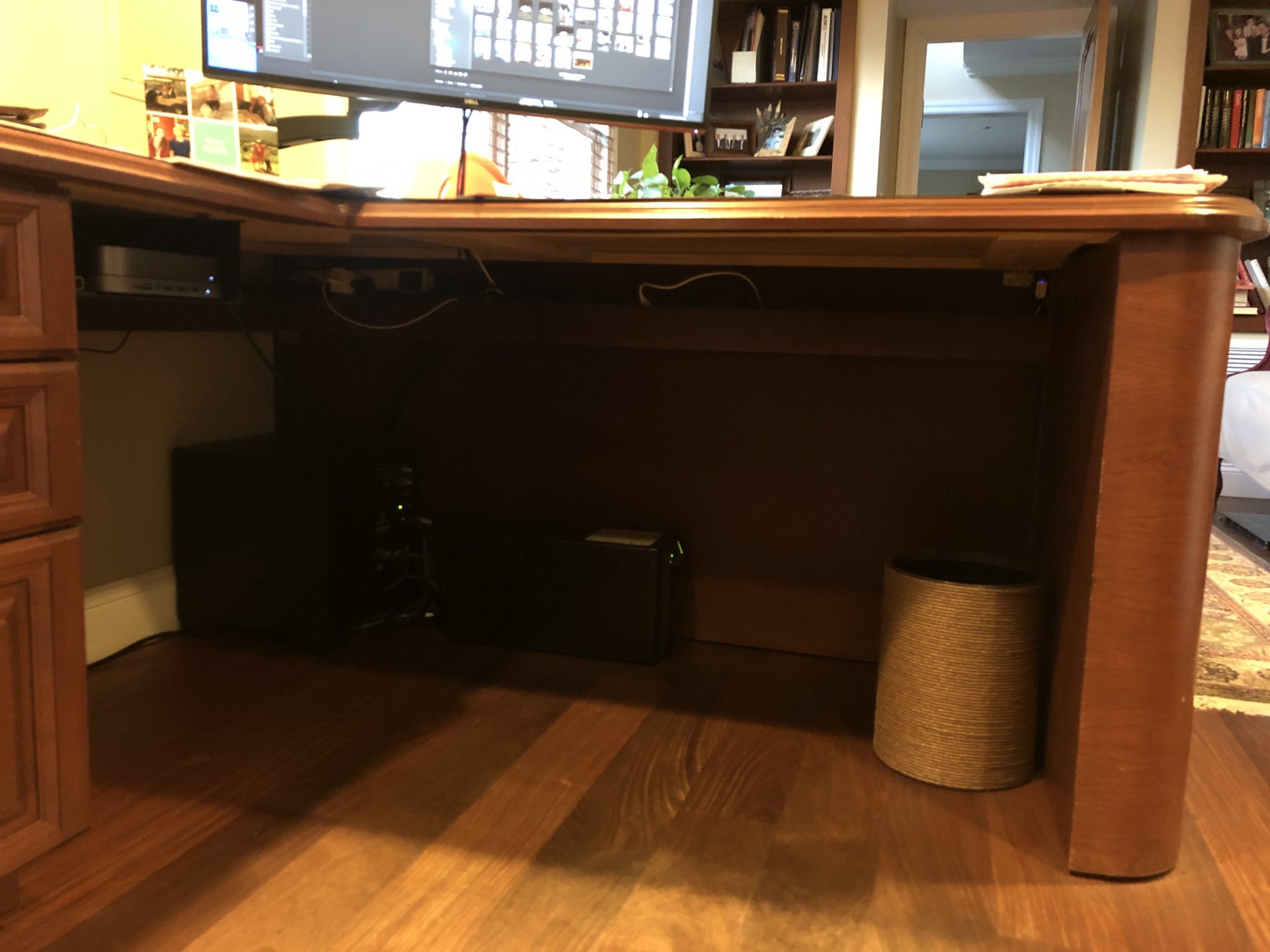

Dongle all the way on the right side underside of the desk. Magic mouse and Kbd. Bluetooth headphones. No issues.......
Thanks. Your photo helps a lot.
FWIW one of the interesting things I discovered in my Bluetooth keyboard testing is that I get the best Raw RSSI readings when the IOGear BT dongle is below the keyboards. I’m guessing this is because the base of the current model Apple Magic Keyboard is all plastic. And the plastic window in the older model A1314 keyboard wraps down underneath the round section that houses the batteries, etc.. Of course that doesn't apply if the keyboard is in my lap :)
In any case, since I taped the IOGear BT Transmitter to to top of my monitor I have not had any BT disconnects, even when my feet are up on my desk and I’m using the keyboard in my lap :)
Thanks again for posting your experinces — GetRealBro
Raw RSSI readings not necessarily the best real world indicator. Took me a while to get this right. Glad you found a path.
