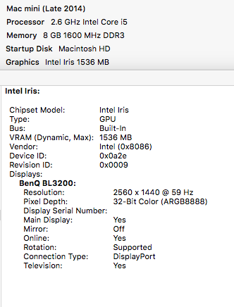

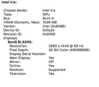

The answer to you question seems "no". The mini will output 2560x1440 but less than 60hz. I would say you will not notice any problem seeing movies. Any frame rate drop is likely caused by graphic power of your mini rather than the cable or the monitor.
I didn't have a problem with that resolution, using a cheap Displayport cable.
Also worked quite well using the HDMI cable that came in the box with the monitor.

2560x1440 @ 60hz will work with a MDP to DP cable plugged into the Thunderbolt port. The cable you linked looks correct to me.
The cheap DisplayPort cable and the HDMI cable I had both supported 2560x1440 :D
