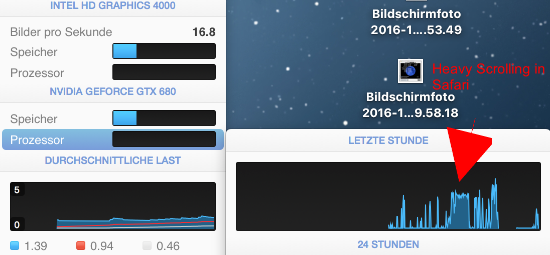

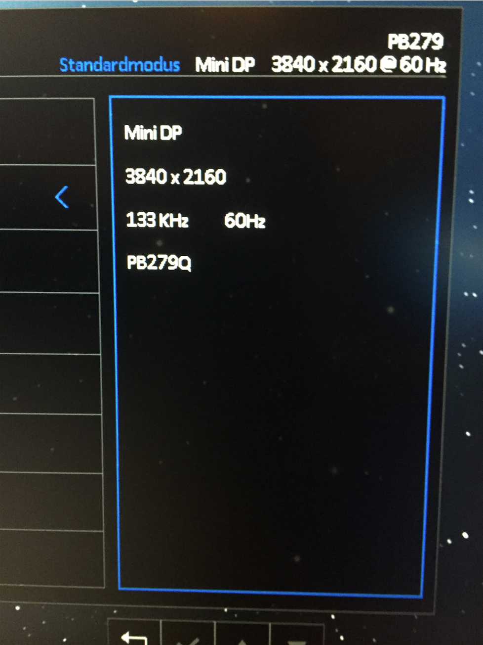

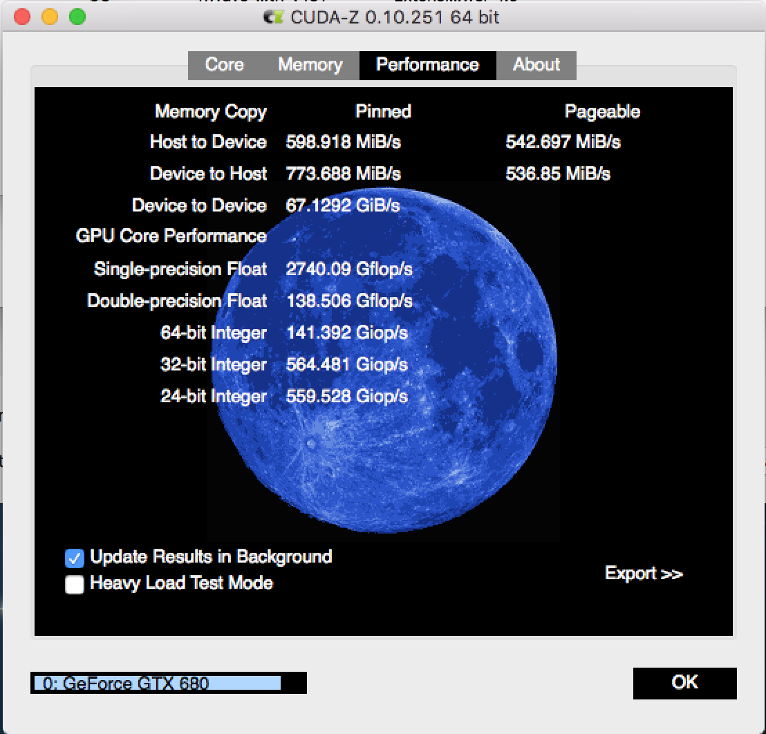

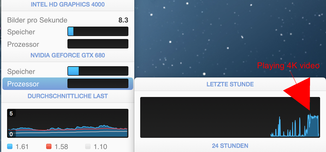

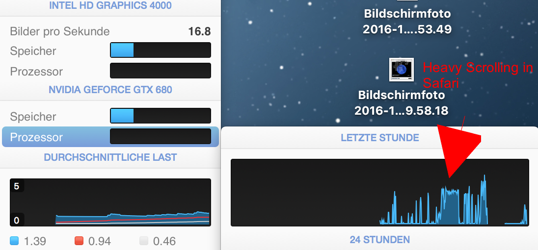

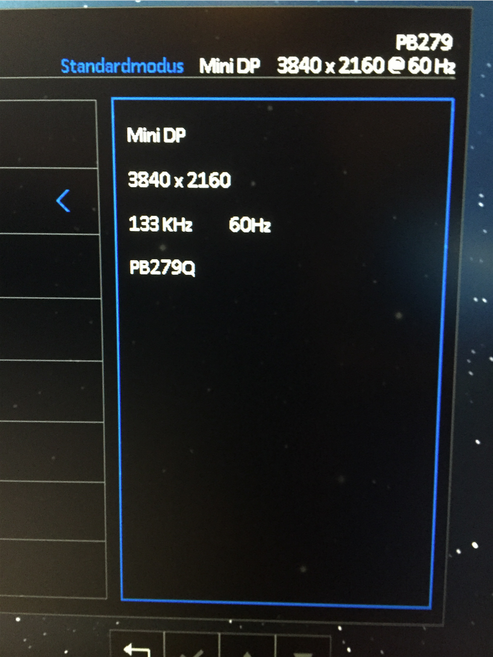

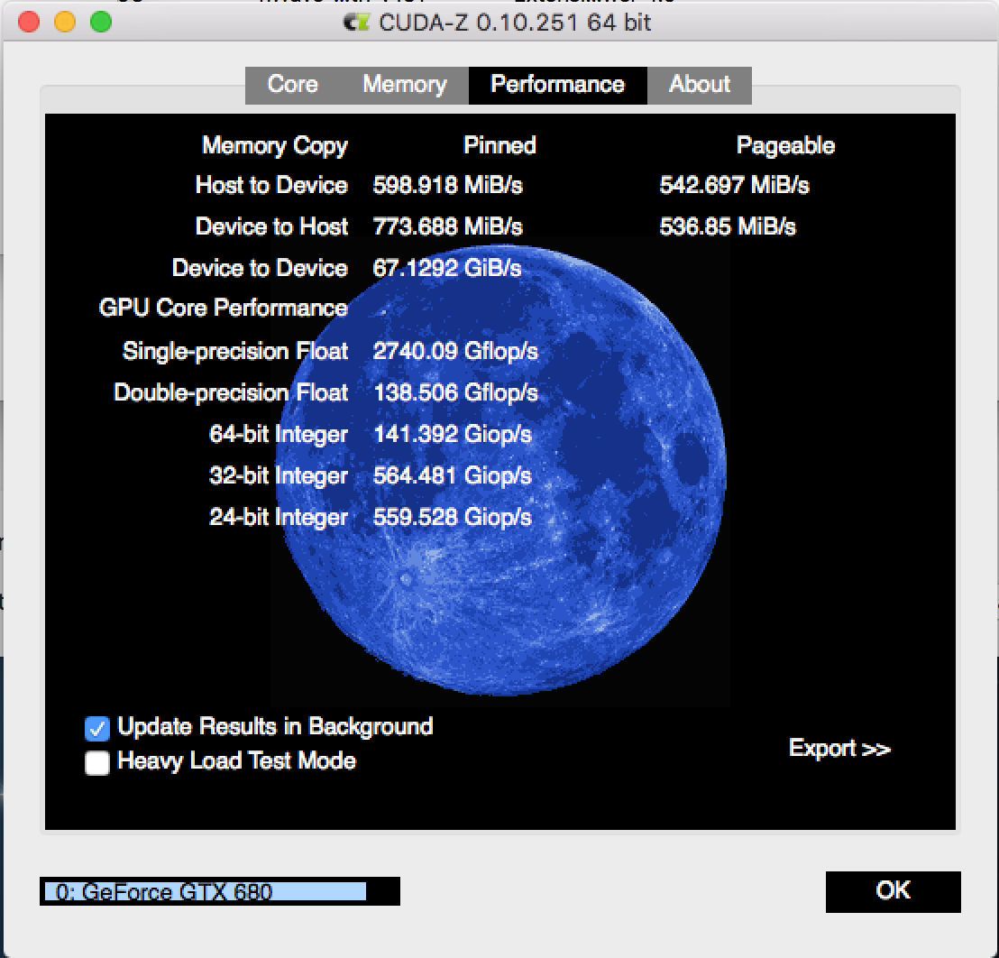

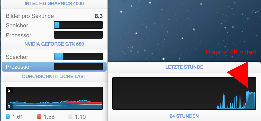

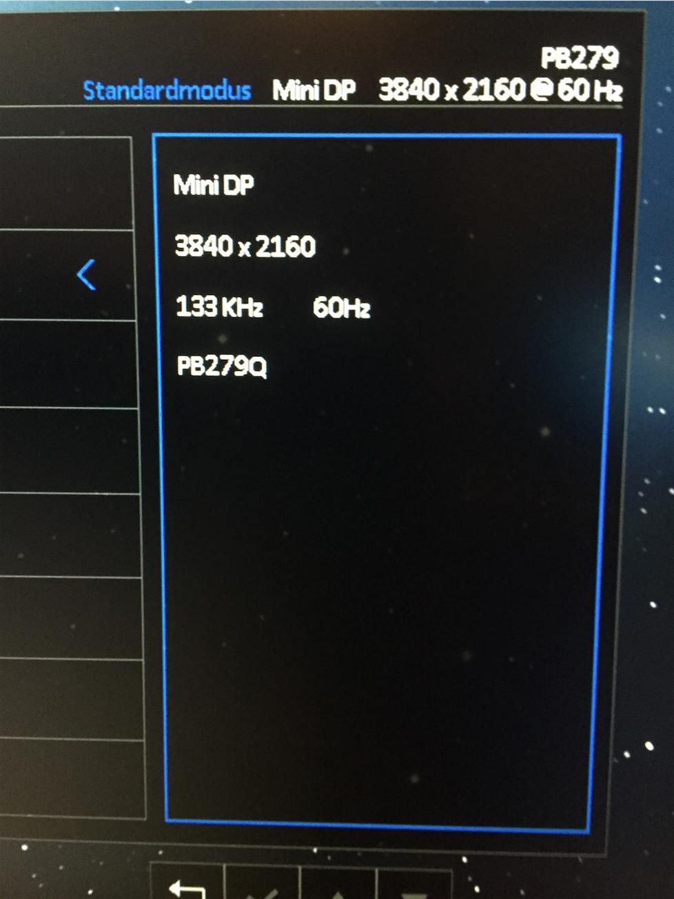

I can confirm that the 800 MiB/s of Thunderbolt 1 can display 4K resolution. I can even play 4K videos via eGPU with my Mac Mini 2012. Overall it's not as smooth as with an internal dedicated GPU in a Mac Pro, but smooth enough, and hey I have 4K @ 60Hz!
But I would recommend at a minimum a GTX 680 as eGPU. Scrolling in Safari or playing 4K footage requires 50% of the GPU capacity:

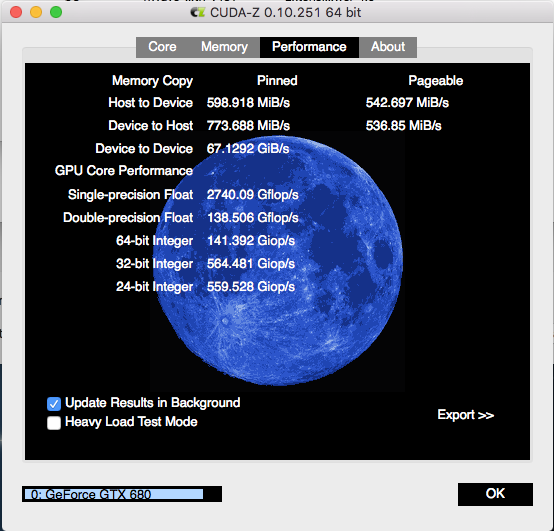

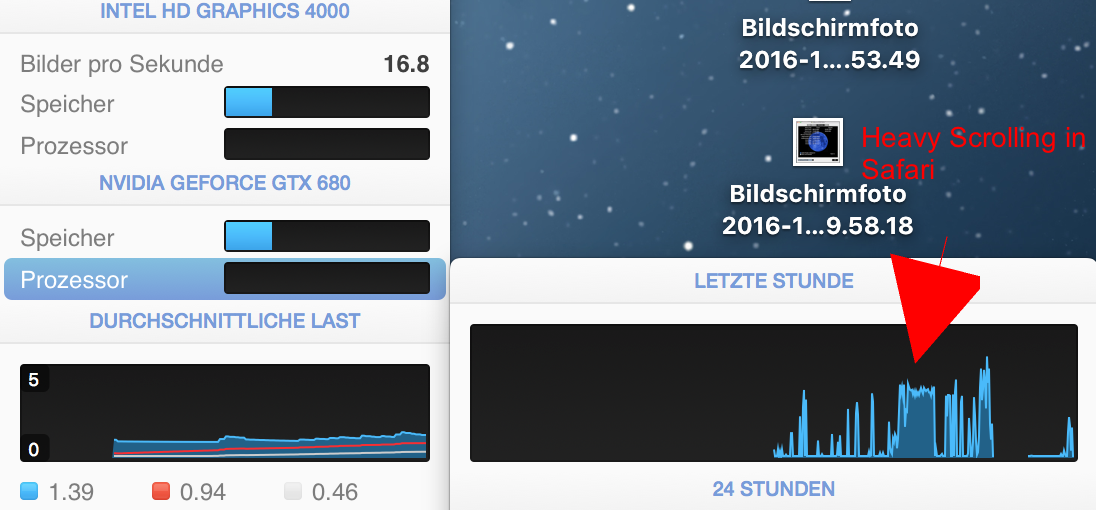

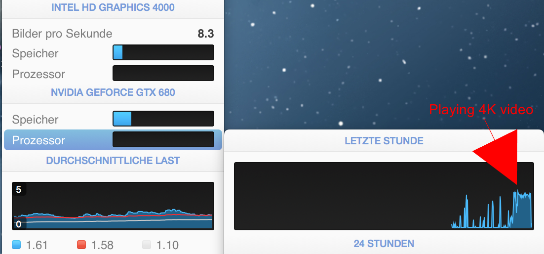

View attachment 662522 View attachment 662523 View attachment 662524 View attachment 662525
