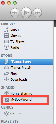

My vote would be for a NAS drive.
My Western Digital MyBookWorld 2TB raid NAS has all of the software built into it to be an iTunes sharing drive. You just log into it from any internet browser to it's IP address and enable or disable iTunes sharing. Put your music on the drive and every computer on my network automatically picked up the MyBookWorld in iTunes.
Easy Peasy.
iTunes over the web?

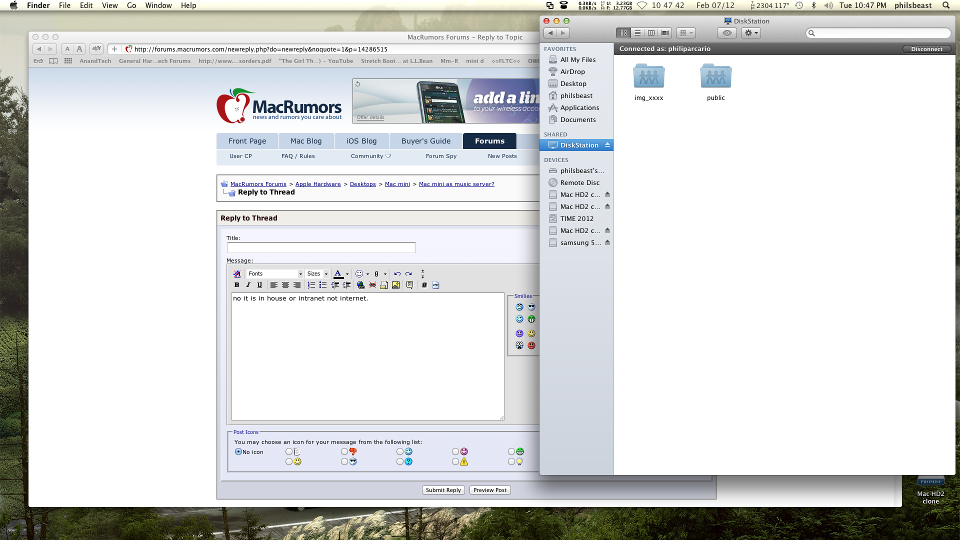

no it is in house or intranet not internet. my nas is from synology called disk station. I have a few hundred tv shows on it. my 4 mac minis all connect to it and can play a movie or a taped show. PLUS I have about 5000 photos and 25000 songs. the lowest cost ones run 150 plus an hdd. a really good one is about 500 plus 2 hdds

No, iTunes on my network.
Shows up automatically as a shared music drive inside iTunes.
This was just the option I used.
Read more about it http://www.wdc.com/en/products/products.aspx?id=280
Mid page click the horizontal Grey bar that says more features>
