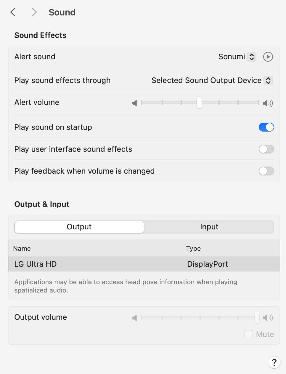

The situation has gotten worse. Now the Mac mini internal speaker is not even listed in the available sound output devices.

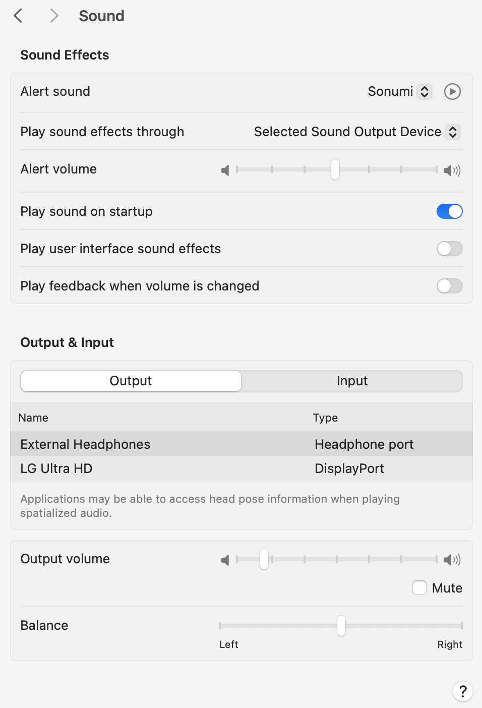

I'm expecting to have a choice and not be forced to use the headphone jack as my output just because something is plugged in there. FYI, this was never the behaviour previously. This only started a few days ago. Previously, it always gave me the choice of my output device, even if something was plugged into the headphone output. So, yes, that's what I expect.
For the sake of argument, I unplugged the headphones and now there is ZERO audio. The Mac mini speaker is completely unavailable. I can't imagine how this is not a bug.

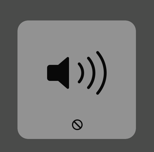

Here is what is displayed if I attemtpt to adjust the volume:

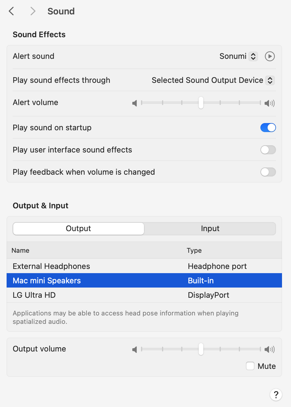

I updated MacOS to 14.4.1 today and this apparnenly resolved the issue of no internal speaker. Internal speaker has been restored as an option in sound settings.
If that particular problem comes back I will try some of the other suggestions (booting into recovery, resetting NVRAM or SMC).
Would still prefer to be given the ability to choose a default output device and have that setting stick instead of it defaulting to headphones on every reboot, but not a big deal.
