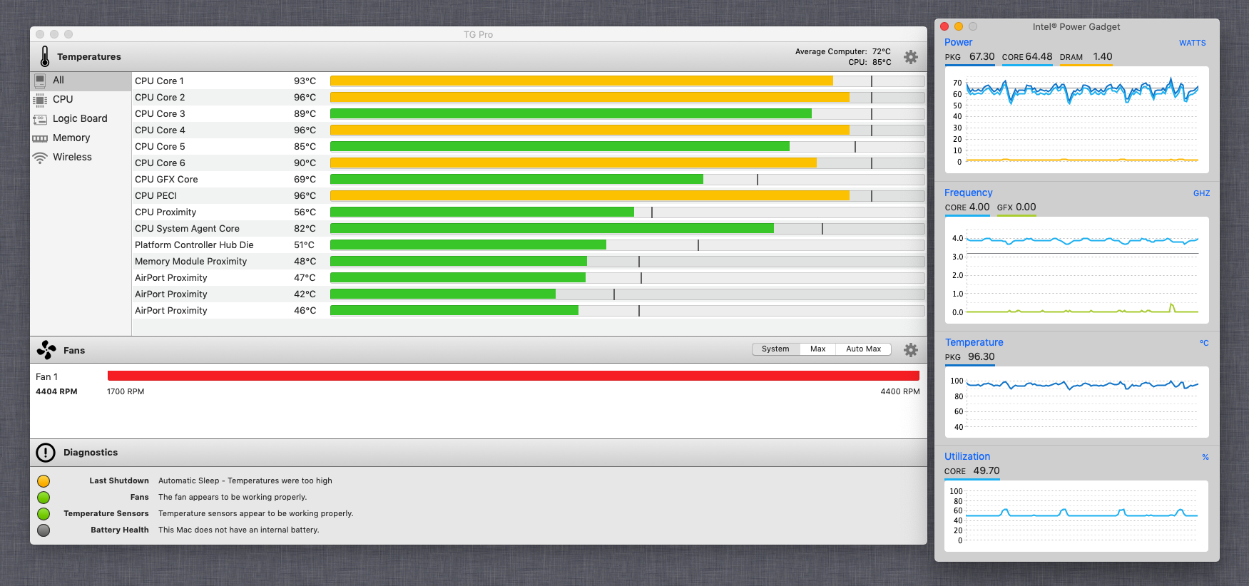

This may be just a little bit off topic but very related....
If anyone is interested in seeing the maximum heat, cpu speed (MHz), and Fan noise that you will ever see with your new Mini you can run this simple test. (Free)
Download Intel Power Gadget here: Intel Power Gadget
Download Temperature Gauge Pro here: Temperature Gauge Pro
Start both apps then run these commands in Terminal: (This is a MAX CPU Stress Test)
To start a 4-core test Cut and Paste in Terminal: yes > /dev/null & yes > /dev/null & yes > /dev/null & yes > /dev/null &
To start a 6-core test Cut and Paste in Terminal: yes > /dev/null & yes > /dev/null & yes > /dev/null & yes > /dev/null & yes > /dev/null & yes > /dev/null &
To end the test Cut and Paste in Terminal: killall yes
This test will push your CPU to the highest level it will ever achieve, and the max temps you will ever see, and the max noise your fan will ever make. The CPU will throttle at 100c and decrease in speed to stay below 100c, as designed. So no worry about damaging anything. It's actually very interesting to see just how well the Mini protects itself, and can give you some piece of mind.
The Fan will be pegged at 4,400 RPM which is maxed out. For those concerned about noise.
