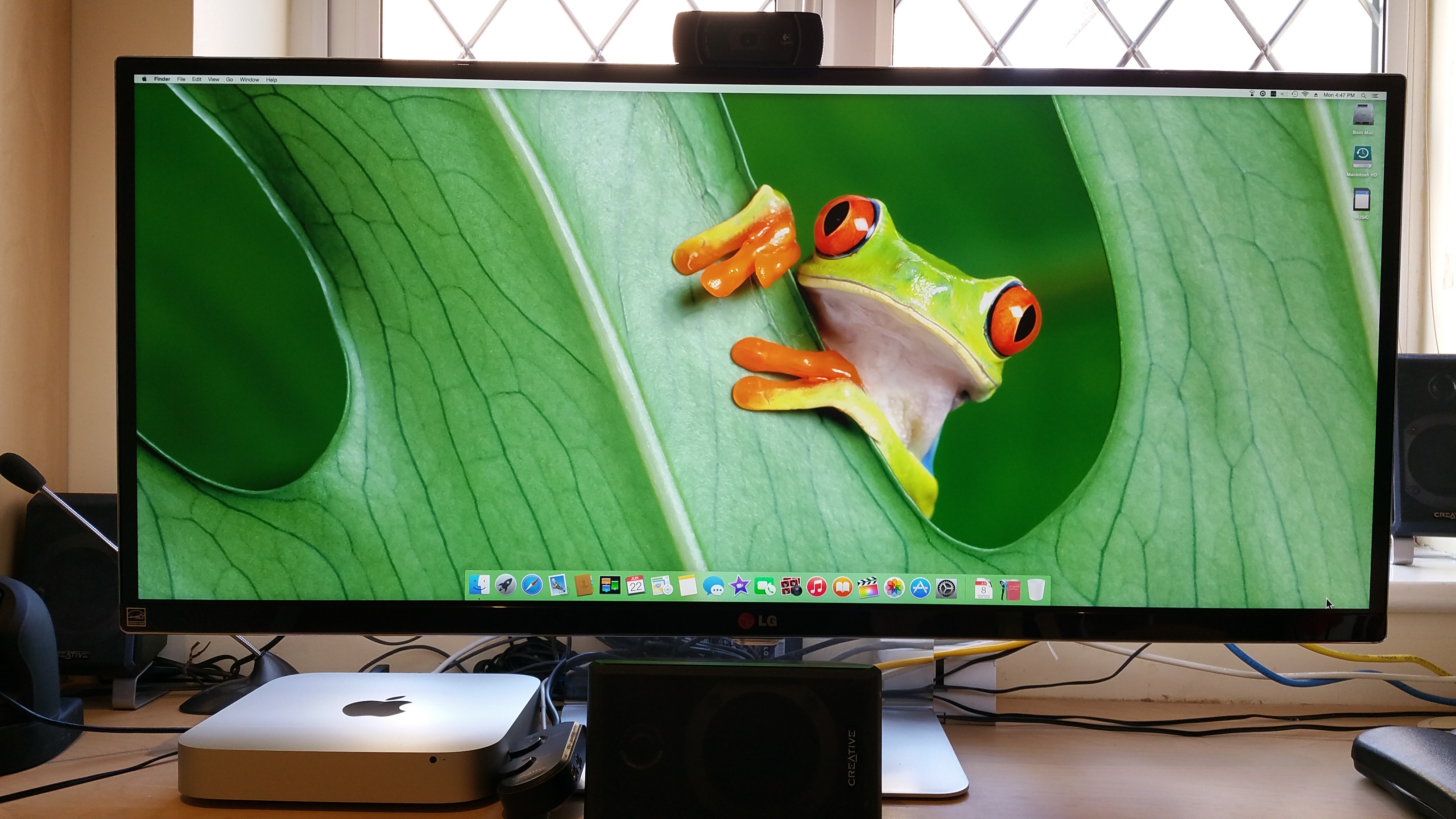

Here is a picture of my setup.

Yeah, I'm running a '12 Mini (technically a server model), 2.3 i7 QC, 16GB RAM, 1TB HDD [OEM] in the "upper" bay, MX100 512GB SSD in the "lower", two 1080 monitors, one off the HDMI, the one off the TB/DP port. Runs fantastic. :cool:
Doing general computing, serving up/editing video, running multiple VMs, Unity3D work, etc.

Yes the monitor is the LG and once you get used to an ultrawide display there's no going back.
It just makes more sense both visually and for workflow.
