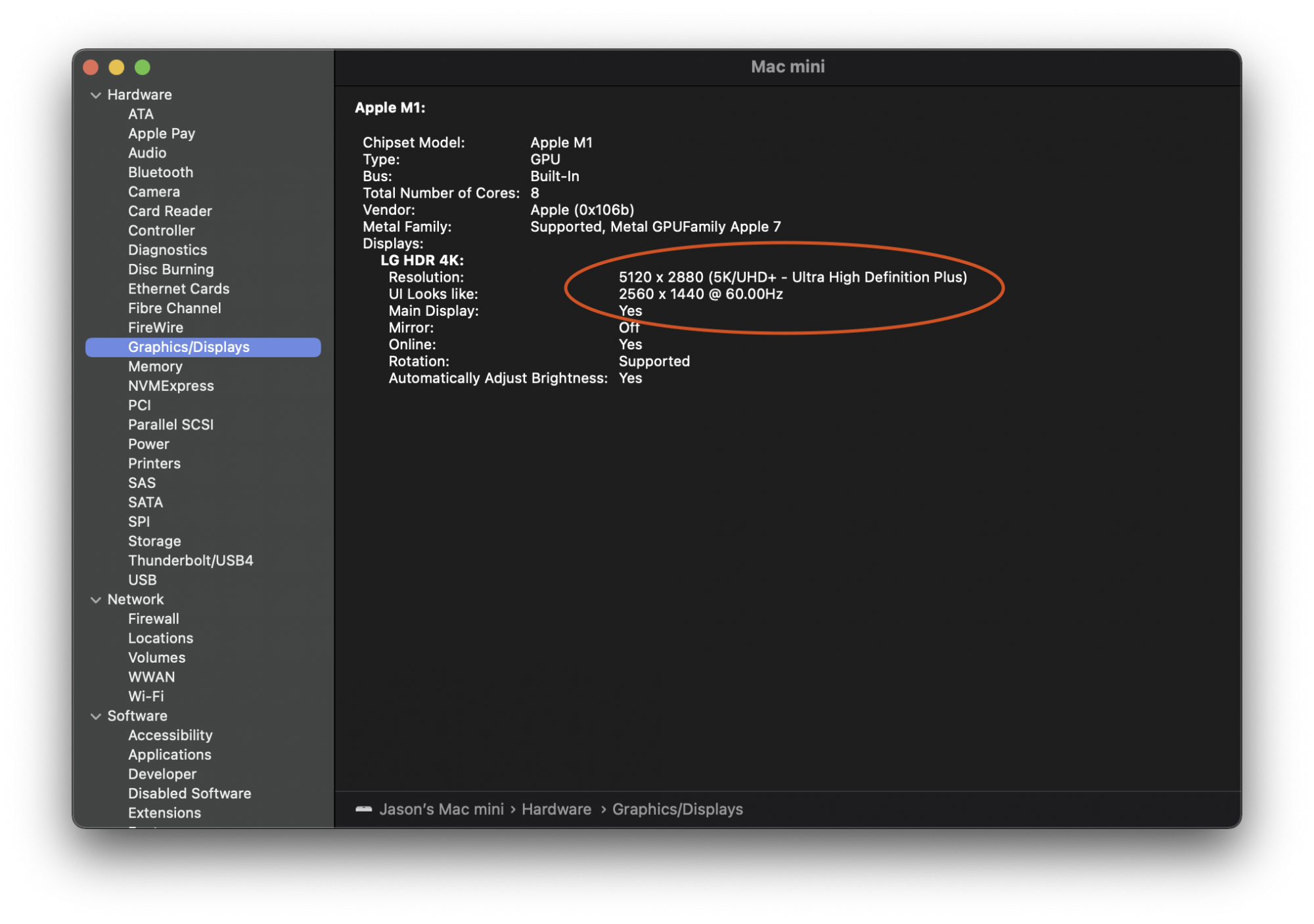

jasoncarle
Suspended
Jan 13, 2006
623
460
Minnesota
This is what I get when I press and hold "option" and click "scaled" on my 4K LG Ultrafine via HDMI
And this is what it says about my 4K screen in the System Report screen.

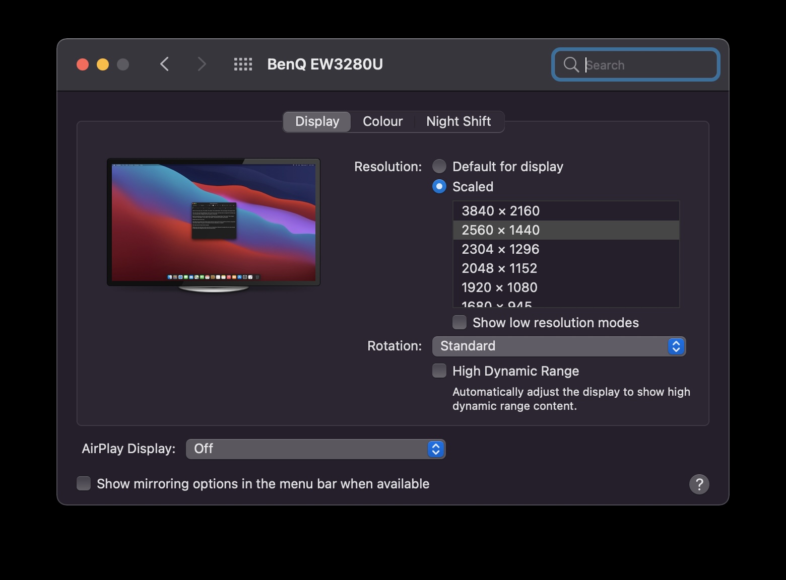

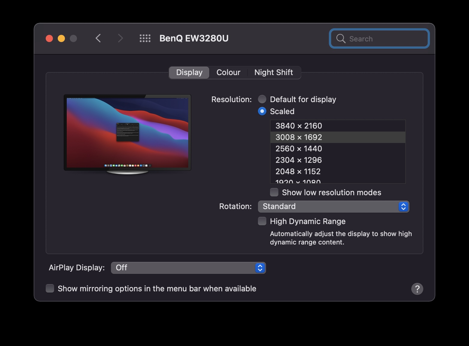

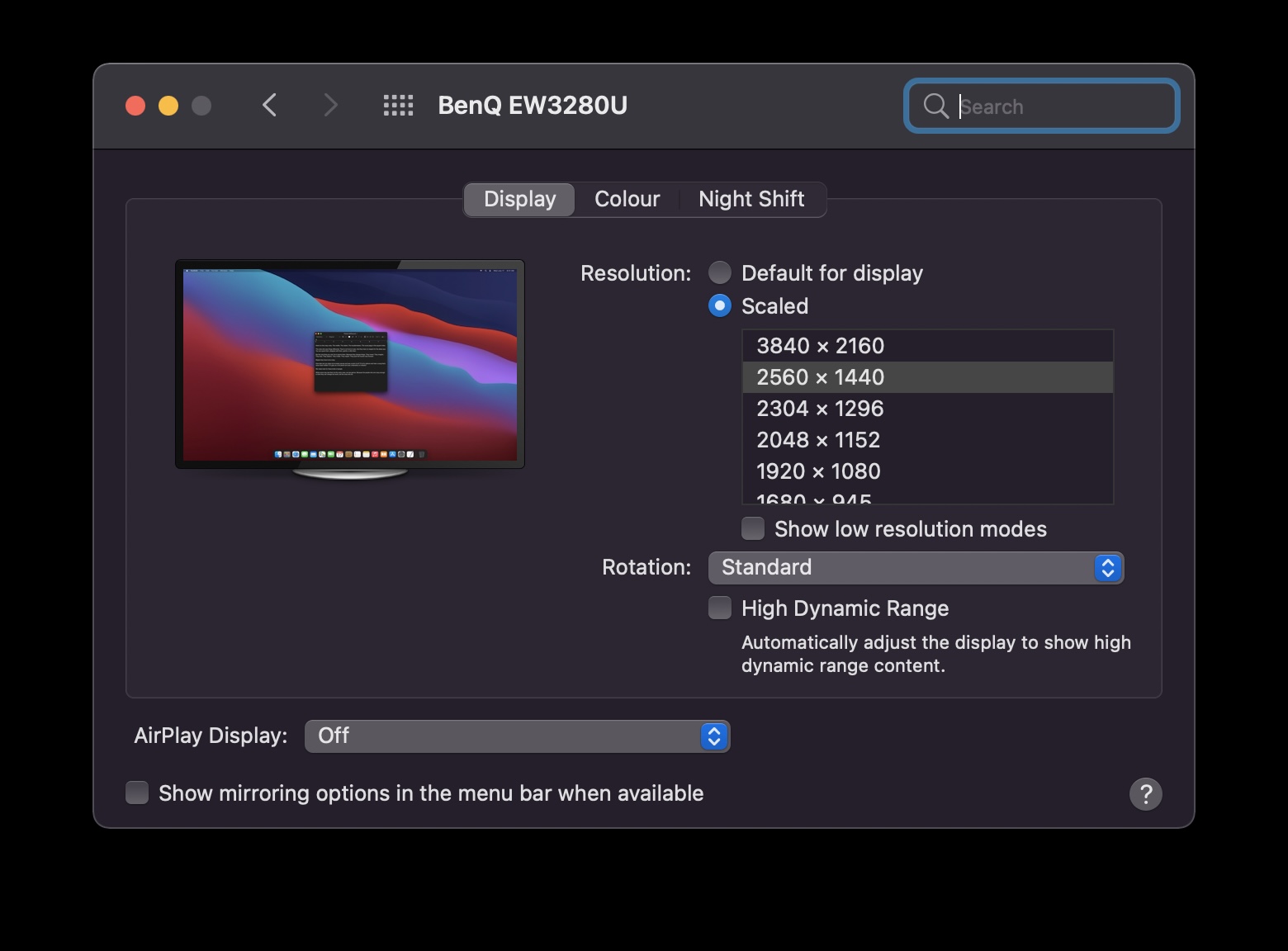

I bought a Benq EW3280U today and I'm having the same resolution issue on my M1 Mac Mini.
The perfect resolution "3008 x 1692" is only available via usb-c cable. But I'm getting a max of 30hz somehow and not 60 via usb-c. And the hdmi is 60hz but it's either too big or too small.
Pretty bummed out tbh. :( Does anyone know any fix to all these?
usb-c vs hdmi
