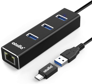

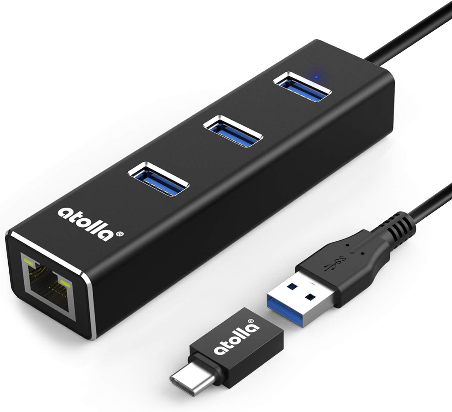

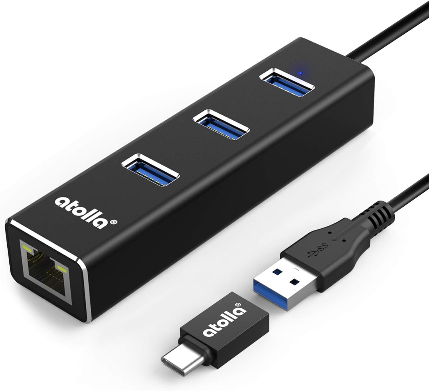

Airplay works fine for me when using a cheap Realtek RTL8153 USB 3.0 GB-Ethernet Adapter on Mac OS 14.0 with two Homepod 2 as Stereopair.
It is a Plug and Play solution, no need to install 3rd party drivers. Just remember to keep Mac Studios (Mac Mini) Ethernet Port unplugged while using the Adapter.
Product-ID: 0x8153
Vendor-ID: 0x0bda
Chipset: RTL8153
My Device: See attached picture
Connected to: Mac Studio USB 3.0 Port
