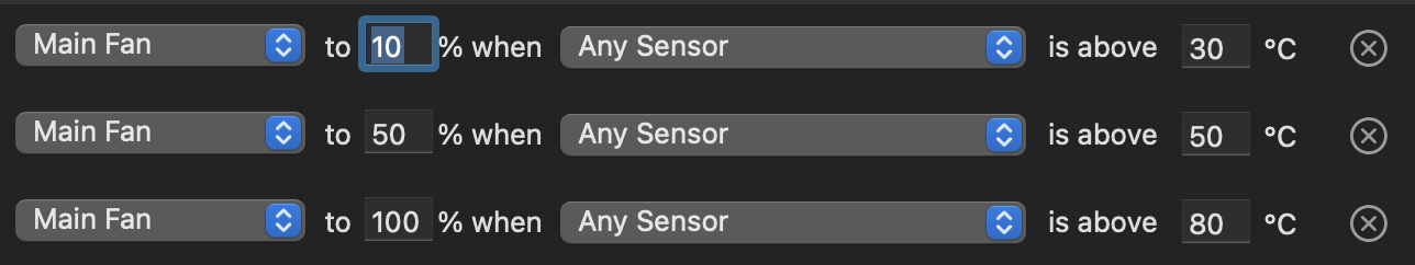

Very disappointed with M4 Mac Mini Pro thermals (64GB, 2TB). I'm a University lecturer in CompSci and part time Unity dev. Game Mode in the Unity Editor with a completely empty hierarchy and I'm seeing temperatures over 100˚C. No GameObjects (other than camera and single light), no components, no scripts, no Update code, nothing.
I've created a TG Pro profile as follows:
That keeps the temperature of a running empty project down to 74˚C on the GPU and 72˚C on the performance cores. Still noisy though with fans at 50%. Transcoding using Compressor or Handbrake fires the fan to max, naturally enough.

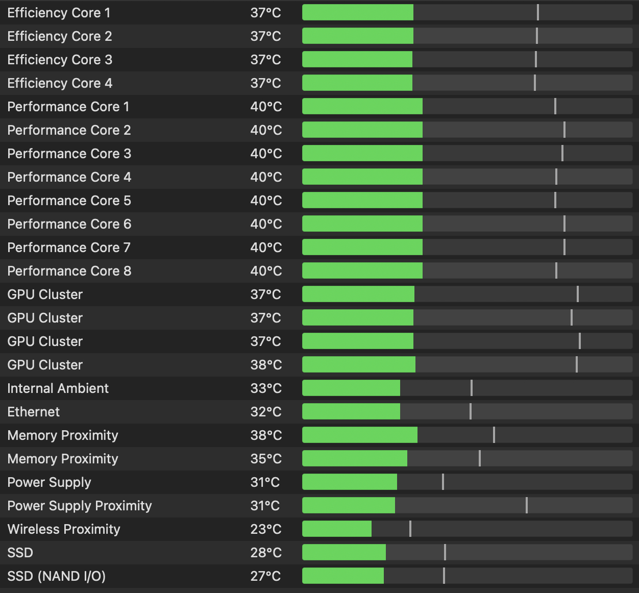

I'm seeing higher ambient than others. Efficiency cores 32˚, Performance cores 40˚, GPU 33˚

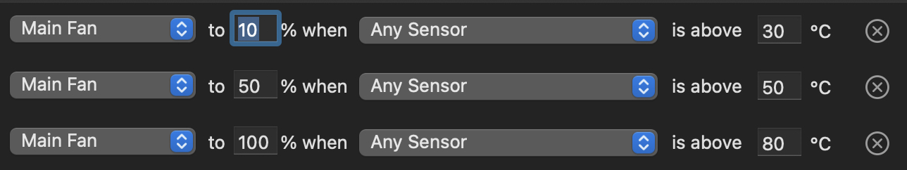

I've created a TG Pro profile as follows:TG Pro as well for this purpose, but also found the rules
I've been testing TG Pro rules as well, but found them either jo-joing with the fan revving up and once the temps have cooled down going silent again until the temps rise again …or too noisy with a constant high rpm.
I am now with the trial period of iStats Menus and find their graphical fan curve superior, levelling at lower rpms while keeping a steady acceptable temperatures.
I'm sure something similar could be achieved with adding even more fine grained rules, but the graphical fan curve definition is so much more user friendly.
TG Pro still leads the pack though with it showing all sensor temps with their max indicators, monitoring the effectiveness of any Fan Helper.

M4 Pro users - what CPU core temperatures do you typically have when the machine is mostly idle?
I can see the WindowServer and kernel_task processes are using around 20-25% & 15-20% CPU respectively, which seems typical, and a handful of other processes using 1-5% CPU (e.g. Avast antivirus, Safari) , but everything else is under 0.5%
I'm getting about 52C temps on most CPU/GPU cores, which is higher than I expected, given that some people are reporting temps around 40C.
My ambient temperature is quite high though (26-28C), so I would expect this to have some effect (maybe 2-3 degrees?)
The 50-55C temperatures are what I usually see on my 14" MBP M1 Max, so it's not a major worry, but I was hoping for cooler temperatures.
