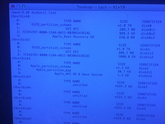

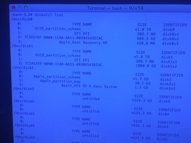

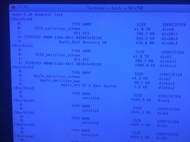

ok now that i spent all day getting the one up and running Im going to check out the other one that i haven't touched yet . this is what i see in terminal. Disk 2 is 1.3 KB 4-13 are all mb or kb.
i think i get it now. I went to reinstall the os and it wants to put it on the recovery drive. that just happens to be 128. im guessing thats the SSD i was looking for even though it doesnt say it.
Before you re-install anything, on the desktop finder, go to the Apple icon and select "About This Mac". Then click on Storage. It will list your internal drives (please disconnect all external drives to avoid confusion). Post it here if you can for us to see. If you have a Fusion drive, it will say so. If you have a split Fusion drive, then it will list the SSD portion as Flash Storage and the other as the 1Tb platter drive. Looking at your diskutil list result, I can only see 2 1Tb drives. If they are Fusion drives, the combined storage of 1Tb with a SSD, mainly the 128Gb version, would be 1.1Tb instead of just 1.0Tb as shown on diskutil.
Maybe I'm missing something? I think that if there are two mechanical hard drives in the Mini then it simply cannot have a fusion drive. AFAIK there is no such thing as "fusion drive", that is a marketing term. In reality there would be one hard drive and a separate SSD inside. That would leave no room for a second hard drive.
the operating system was erased before i got it , so i cant load it to see the desktop. when i go to repair i do see that 128 GB recovery drive and i cant figure out how to boot from it either
Something sounds wrong there. If it had two hard drives, I don't see how it could have had a fusion drive. For a fusion drive, one of the internal disks must be a SSD.
Agreed. Although, it could have been a concatenated volume. Apple's software RAID component does allow for that. You get the convenience of a single volume from multiple drives but no performance increase.

Now I have hooked up the second mini, that one has no OS. I did go to recovery, terminal. diskutil and those are the pictures I posted of the second machine. it also has 2 hard drives, same as first machine but i do not see any thing about fusion this time. so right now im reinstalling an OS on the second machine just so i can get in and look around.

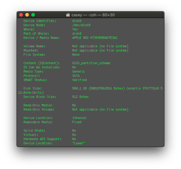

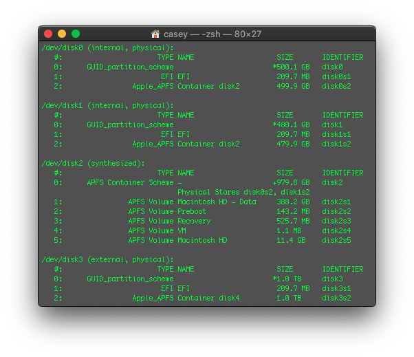

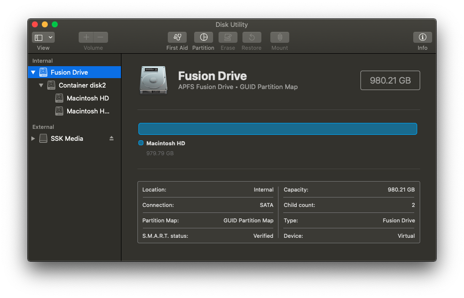

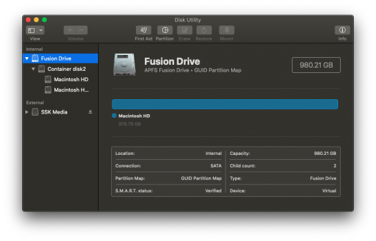

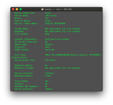

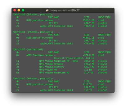

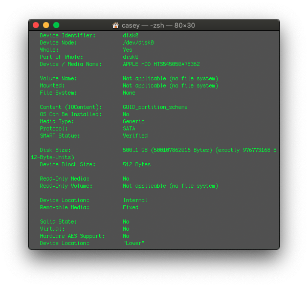

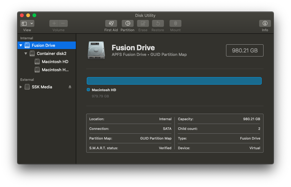

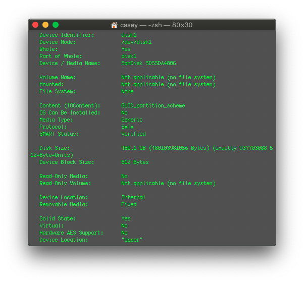

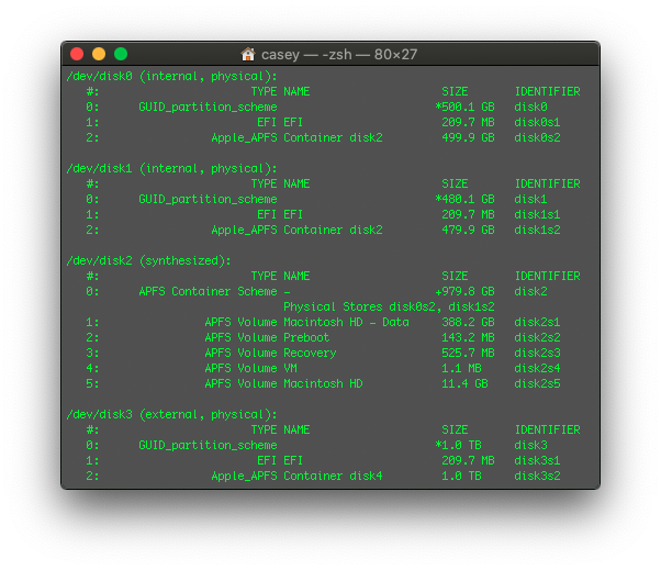

I didn't add any switches to the command, so maybe that's why. The diskutil tool doesn't report the drive type on mine. And, as you can see the screenshot, the Disk Utility GUI doesn't show the physical drives when in a Fusion configuration.

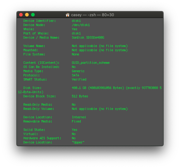

disk1 is an SSD. Bigger than what Apple would have included but slower, not PCIe -- speaking of such, I think, Apple only offered Fusion configs on Macs that had a PCIe and SATA connector for drives.
Of course, you can determine drive type by viewing System Information/Profiler.
View attachment 1736211View attachment 1736212
Try diskutil info disk1 which should tell you what type of SSD drive it is as diskutil list only list drive sizes. When the OP first installed the SSD in place of 1 of the 1Tb platter drives, the installer told him the Fusion drive is not setup, which was true because the SSD is not yet initialized. Apple Fusion drive is basically a 2 drive setup and not to be confused with the Seagate SSHD which is also a hybrid SSD+hard drive setup with a similar intent for the PC and Macs, but it is a one drive setup with the SSD built inside the drive controller of the Seagate HD.
