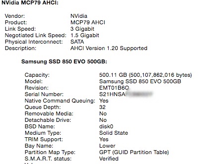

i have a late 2009 Mac Mini 2.53 C2D with the Nvidia MCP79 SATA
chipset. the original 5400 rpm drive showed a Link Speed of 3Gb
and Negotiated Link Speed 3Gb
after installing a Samsung 850 EVO I'm seeing a Link Speed of
3Gb and Negotiated Link speed 1.5Gb
any ideas ?
any ideas ?
you put a 850 in it is a sata III or a 6.0 the Nvidia chipset from 2009 was picky
So when it sees a sata III ssd it downrade you to sata I.
Your options are:
1)live with it and pull the drive when you get rid of your mac mini.
2)return the drive and find a sata II ssd usd on ebay
3)Return the drive and find a sata II ssd new on newegg
4)Return the drive and pm me I have multiple samsung sata II ssds 256gb in good shape.
