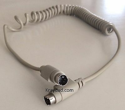

- Keyboard/Mouse:
Search Ebay! Actually, using the real model number of the keayboard usually gives you cheaper sellers compared to general "adb keyboard" searches.
For your LCiii that would be (I think anyway) the "Apple Keyboard 2" or model M0487
Same for the mouse!
Example, in my search a 19$ keyboard showed up! Just be carefull, those keyboards came with detacheable cable, so many are sold without the cable!
Don't be shy to use the "or best offer" option with those sellers!

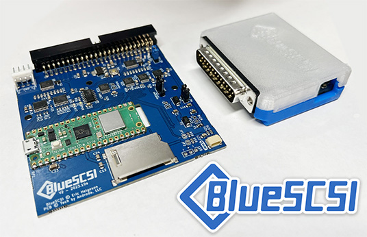

There are quite a few SD to SCSI adapters (actually better called SCSI emulators) on the market.
With your LCIII you have two options, an internal one, which hooks up to the SCSI cable now going to your existing SCSI hard drive, or an external DB25 one, which you can just plug into the SCSI DB25 port on the back of your MAC.
This gives you one heck of an advantage I will describe in the next item (Basilisk).
For your Mac, the BlueSCSI is becoming rather popular! They are a bit less expensive then the competition, but with the limitation that they mainly only work on Macs, and not so much on other machines with SCSI drives (like vintage synthesizers for example).
I prefer the external one, mainly for the convenience of easily popping in and out the SD card.
Find your seller here:
BlueSCSI is a modern, open-source SCSI solution for vintage computers. Powered by Raspberry Pi. Replace your old SCSI hard drives with a reliable microSD card.
scsi.blue

When all that is done, from the comfort of your fast modern PC, you can just copy the MacHD image onto the SD card, pop it into the BlueSCSI and boot your vintage Mac just like you booted the emulator from that image.
