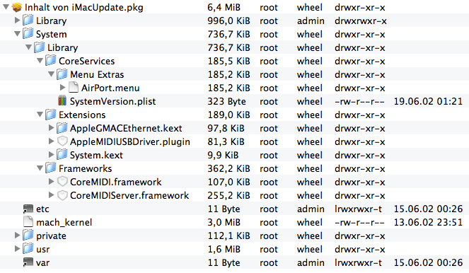

A little tidbit: There's an iMac Update 1.0, exclusive to 17in iMac's running "their" build of 10.1.5 (5T91). It's been archived - https://web.archive.org/web/20021010172152/http://docs.info.apple.com/article.html?artnum=120130 - but as the description says, the package doesn't contain any graphics-related things:
There's one interesting thing though: the kernel. It's the same version as in Server 10.1.5 for the Xserve but two days newer, possibly making this the newest Puma kernel out there :)
Code:
$strings mach_kernel | grep "Kernel Version"
Darwin Kernel Version 5.5.2:
$strings mach_kernel | grep RELEASE
Thu Jun 13 14:44:17 PDT 2002; root(rcbuilder):RELEASE_PPC/osfmk/RELEASE
Thu Jun 13 14:49:23 PDT 2002; root(rcbuilder):RELEASE_PPC/bsd/RELEASE
Thu Jun 13 14:41:19 PDT 2002; root(rcbuilder):RELEASE_PPC/iokit/RELEASE
Thu Jun 13 14:49:39 PDT 2002; root(rcbuilder):RELEASE_PPC/pexpert/RELEASE
Thu Jun 13 14:50:10 PDT 2002; root(rcbuilder):RELEASE_PPC/libkern/RELEASE
Thu Jun 13 14:50:32 PDT 2002; root:xnu/xnu-201.49.obj~3/RELEASE_PPC
Thu Jun 13 14:50:30 PDT 2002; root(rcbuilder):RELEASE_PPC/libsa/RELEASE
UPDATE: That update increases the build number to 5T95.
