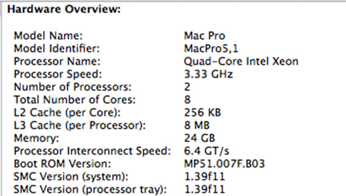

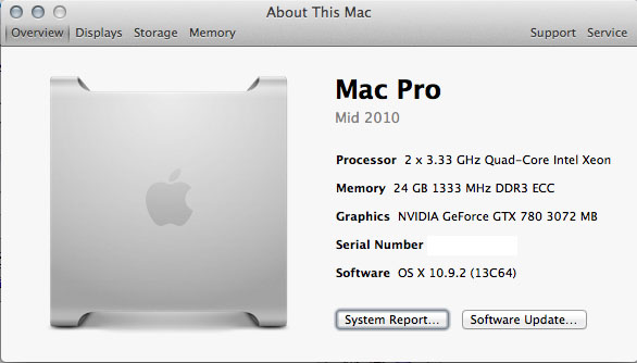

Very interesting! I would like to do this upgrade. The W5590 is the 3,33 MHz version, isn't it?
Does this CPU show up in the correct way in the "about this mac" Menu?
I hear there is a small correction neccesary in some command lines to have the right CPU indicated. Is that true?
Thanks!
1. Yes - 3.33 MHz
2. Yes it shows up correctly
3. No OS modification needed for this to work correctly in a 4,1 or 5,1 Mac Pro.
4. In a flashed 4,1 or 5,1 Mac Pro with 1333 MHz RAM the CPU change will allow the RAM to run at full speed.
Lou

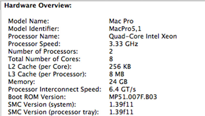

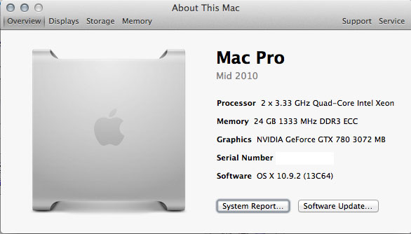

1. Yes - 3.33 MHz
Lou
