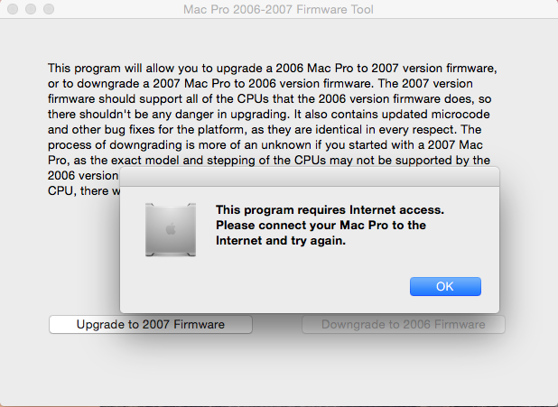

I downloaded MacPro2006-2007FirmwareTool which was posted by MacEFIRom from netkas.
But the software tells me "This program requires Internet access..." when I run it. I'm sure my Mac Pro 1,1 is connected to the Internet well. After I clicked OK button, the software closed automatically.
Have you met this problem?
