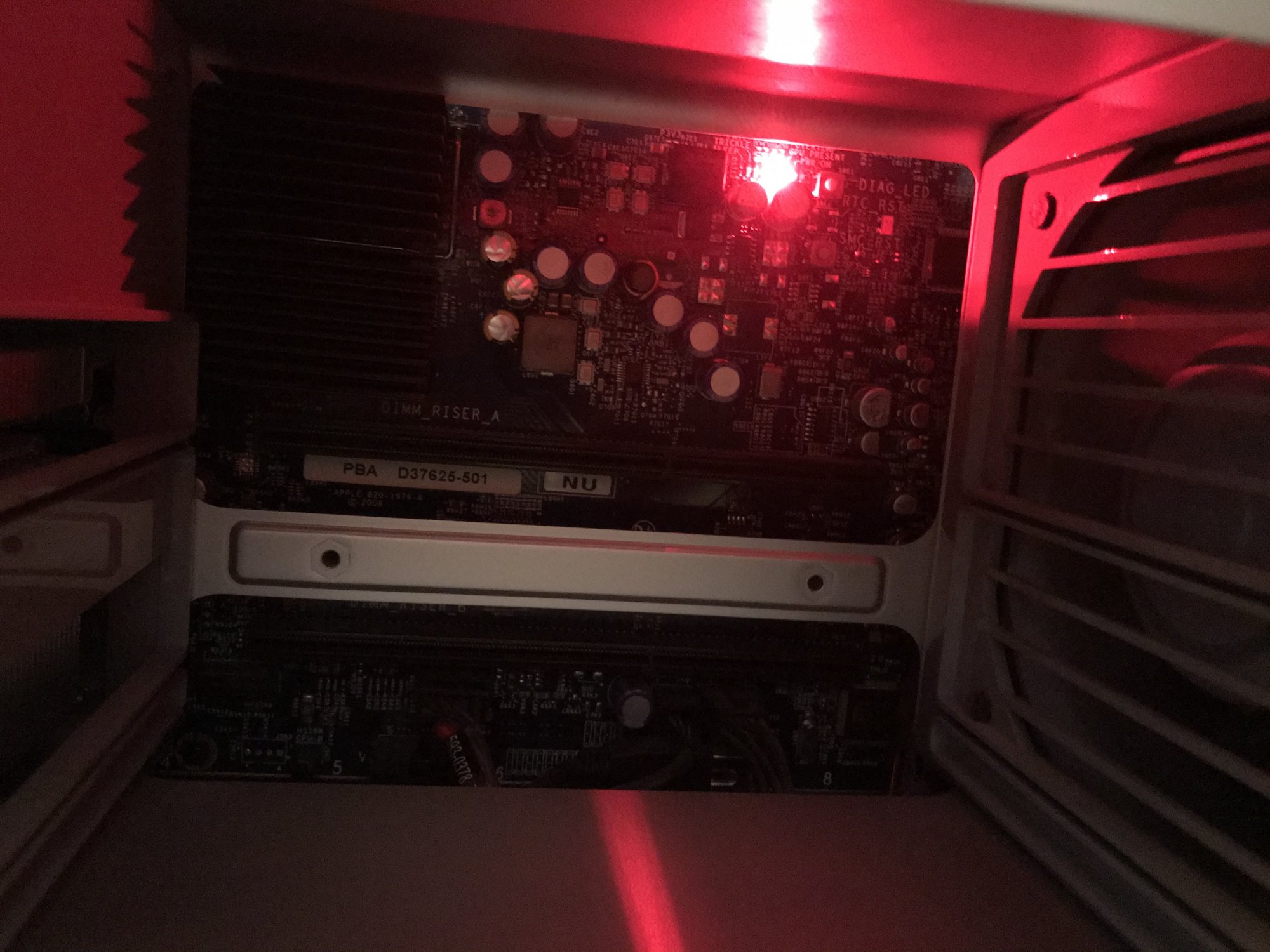

1) When I turn on the Mac Pro normally the white LED flashes but everything else is off.
2) When I turn on the Mac Pro without a power adapter connected, after always holding down the power button, I connect the power supply and check for a red light above the RAM that doesn't turn off even if I turn off the Mac.
I invite you to see the attached videos to understand better, what can I do?

I tried to remove both the ram and in any case the red light stays on as shown in video two. is it a ram problem anyway?

looks like almost all rams dims are dead.
remove all
insert one at a time, check red light on the ram risers. If lit this ram is dead, repeat with all sticks, one at a time

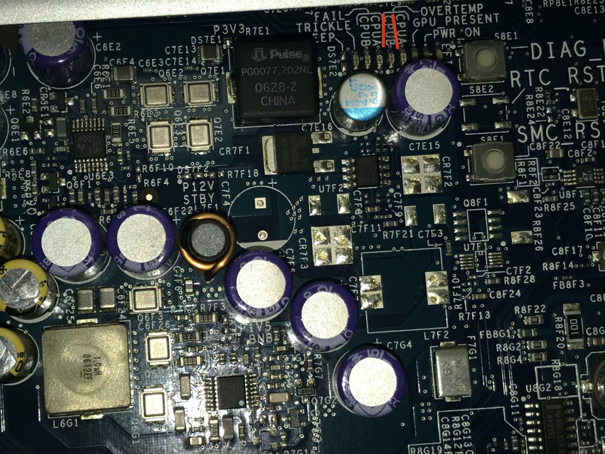

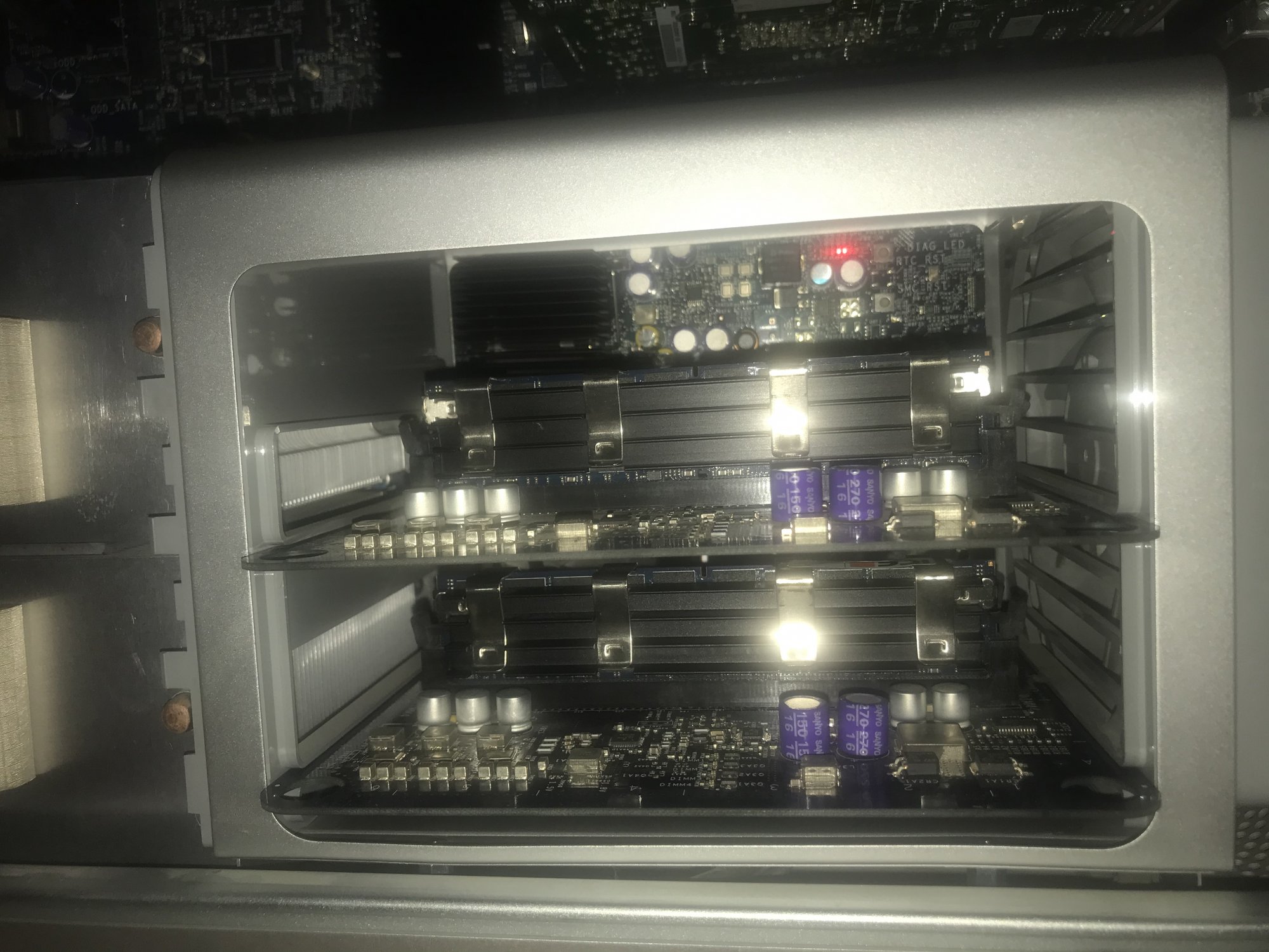

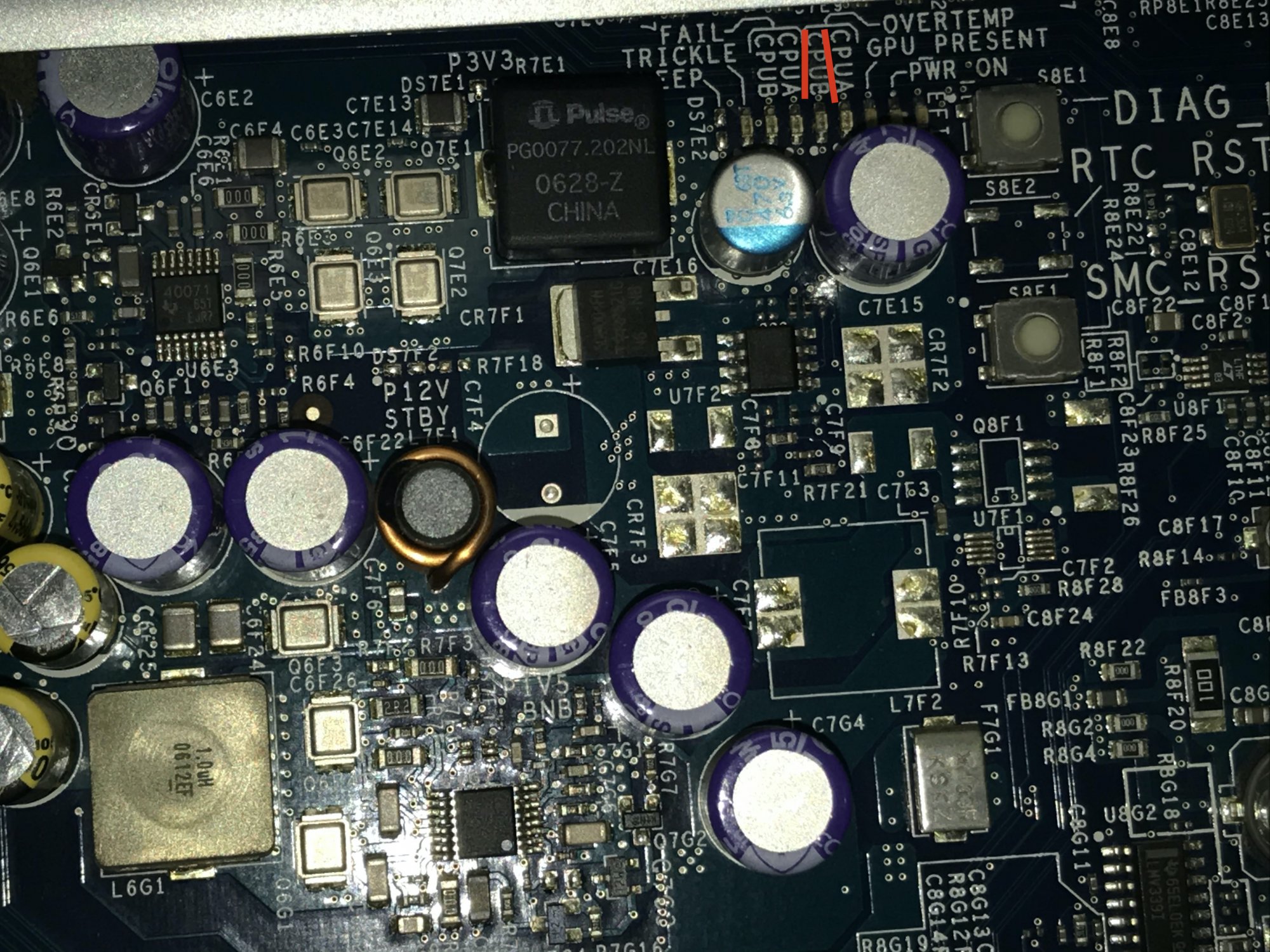

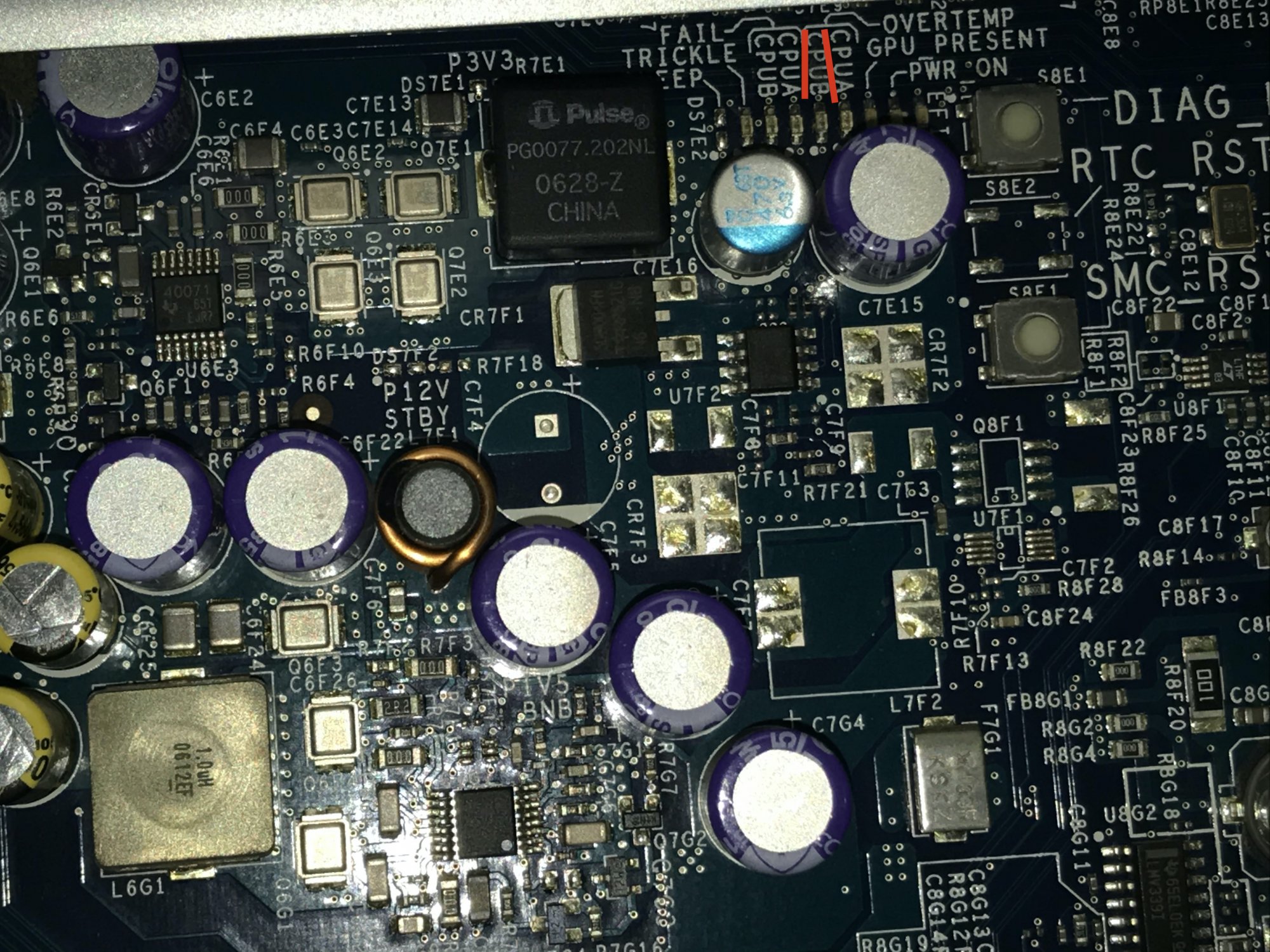

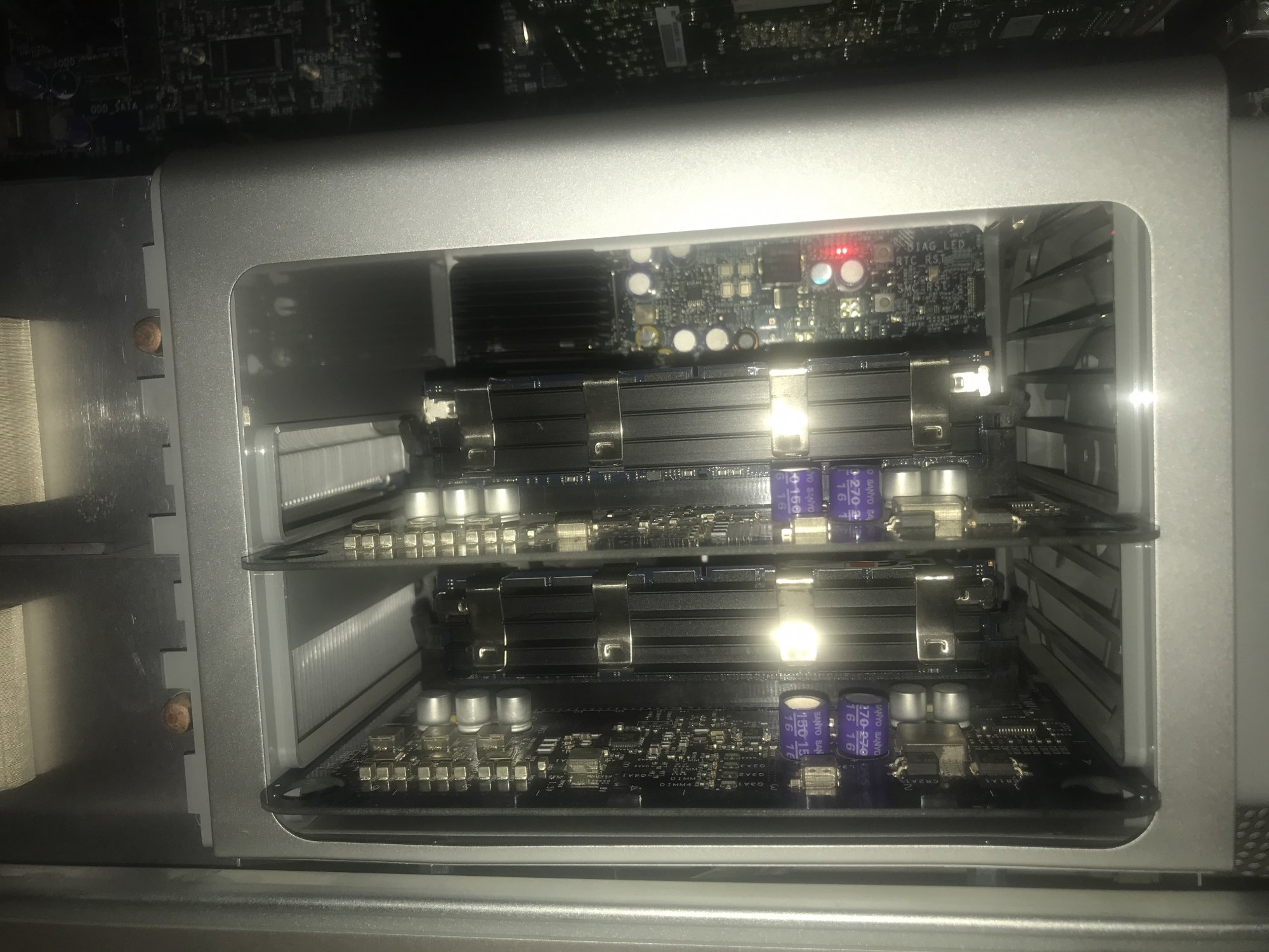

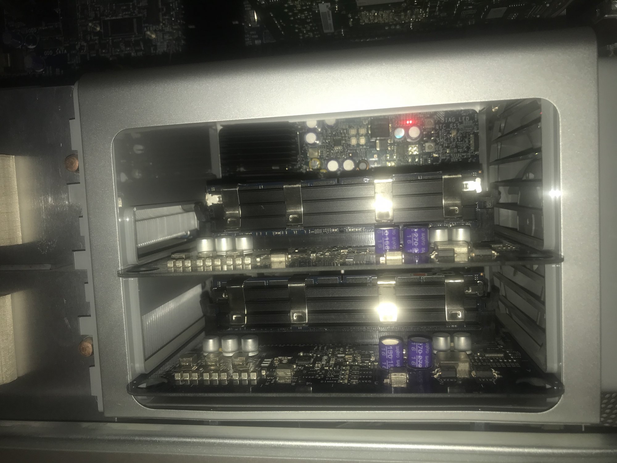

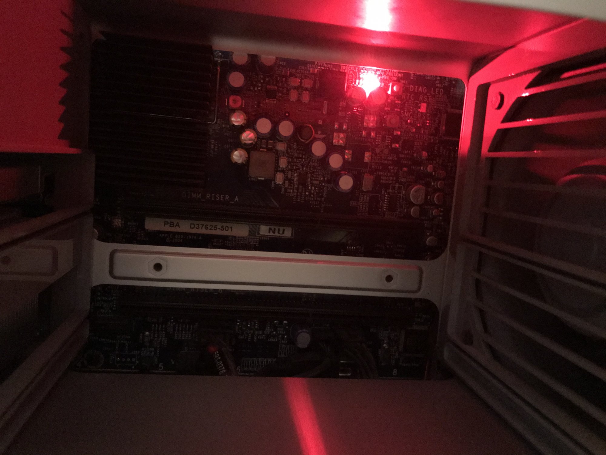

Hi, thanks a lot for the answers. Unfortunately I don't think it's a ram problem. I disconnected both the ram and started the mac in recovery mood and this light remains on (as you can see from the attached images). The lights on are above the words "CPUA and CPUB), so it's a CPU problem? I think my Mac is dead! Do you have any advice?

i linked the manual, look at it
for ram idk of my head do a serch here for macpro 1.1 ram
