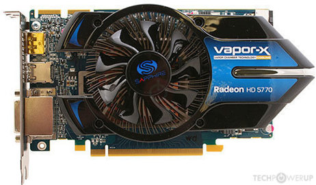

The 5770 pc card is a Sapphire HD 5770 Vapor-X
And have found all the bioses for 5770 and the Sapphire HD 5770 Vapor-X specific here
I'm going to try some of these bioses but my hopes are not high.
I get 3 green lights on vapor x so that means there is max power.
I think i overheated the gpu or the ram. The fact the info in gpu z goes on and off makes me think that.
But i have a SMD hot air workstation now so i may try that.
Could be some pins of the gpu and ram are disconnected from the pcb.
And reheating it with hot air may fix it.
