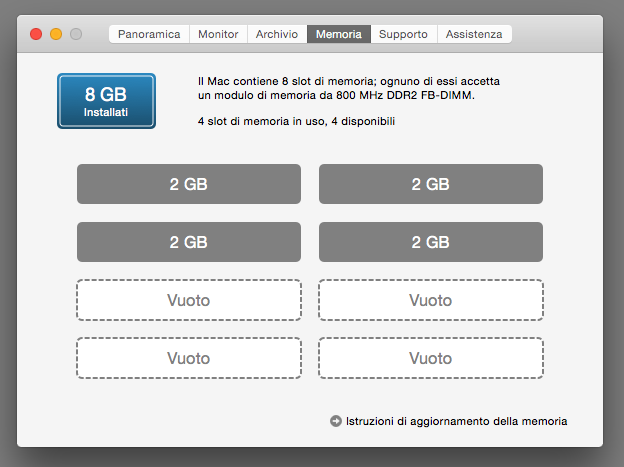

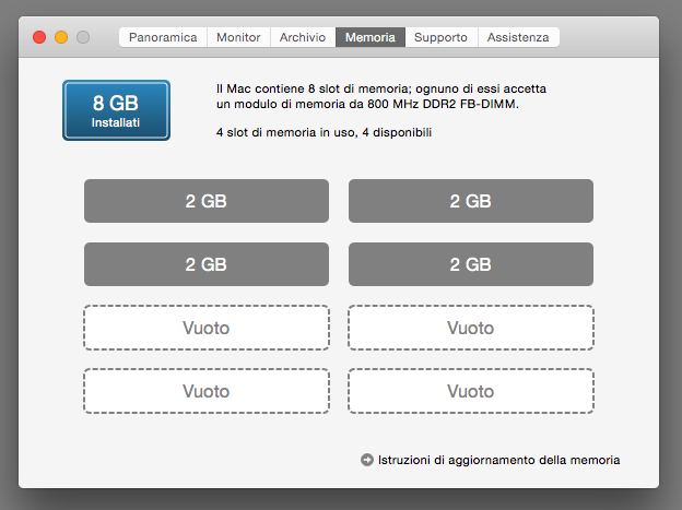

I did not understand one thing, as you can see in the attachment I have the RAM with 4 modules of 2gb each, I would like to increase the ram, in the empty places I can put 4 modules of 4gb each in order to have a total of 24 GB of ram?
Or must all modules have the same gb size the same for all? that is, all the modules of 2gb or all of 4gb or all of 8gb?
thank you
thank you
As far as I remember, you can mix different sizes of Ram. But usually there are certain configuration that are more desirable than others configured. Maybe someone else can chip in with a 3.1, I only know the 5.1 real good.
By the way, the MP3.1 is known to run its RAM very hot. Back in the day there was one famous cooling mod available. I found it again, you may want to know about it, see below.

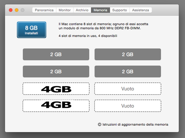

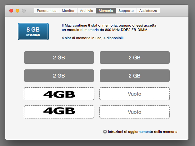

In this way it would be right to insert the new ram?

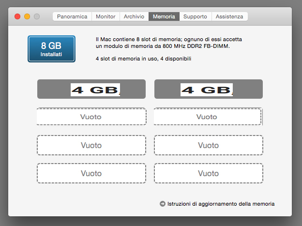

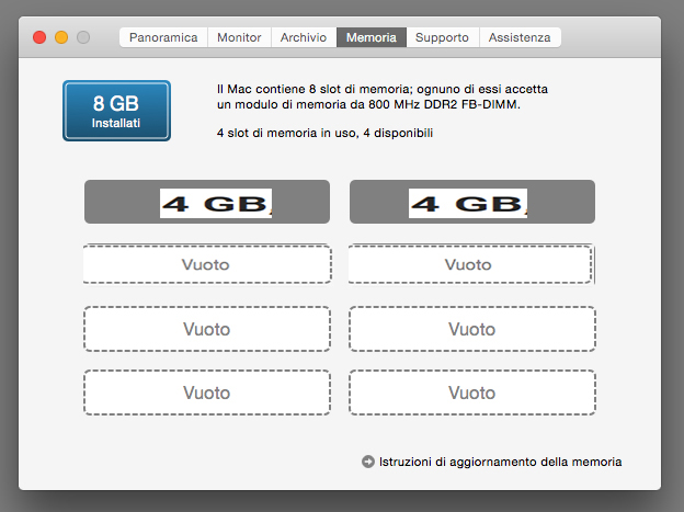

Or maybe better, throw in the trash and delete the 4 existing 2gb bars, and insert the 2 new 4gb bars in the same way as attached, is it a better system?

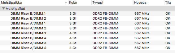

I've got 48 GB of 667 MHz FB DIMMs in my 3,1. Like those in your link and similar to those in the link below.

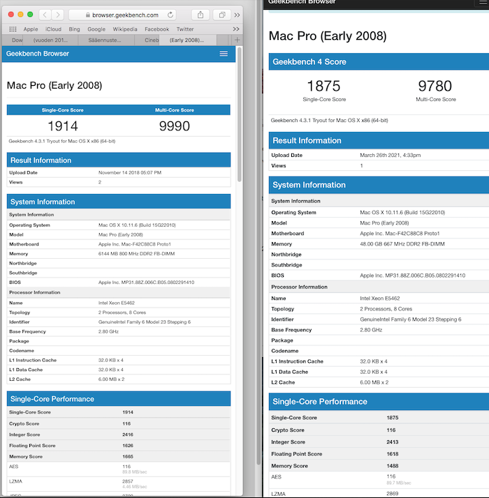

Ok I checked, and I actually did run Geekbench 4 at the time of purchase a couple of years a go (2018 it was). It was with 6Gb of 800MHz RAM. And just ran GB 4 again, see pic.
So there is a performance hit of course. But it's like 2 percent in overall score, and 10 percent in memory score alone. The megahertz difference would suggest 16,7 percent hit if calculated by the difference between those megahertz numbers.
I personally don't mind that much about it.
I arranged the dimms like:
