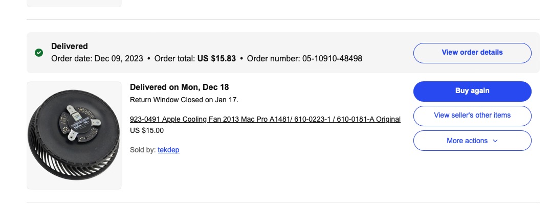

Got this fan just to have for a spare part, There are a lot of 6,1 parts around lately, Just had to replace a CPU board, They are going for $45 and the seller had 9 in stock

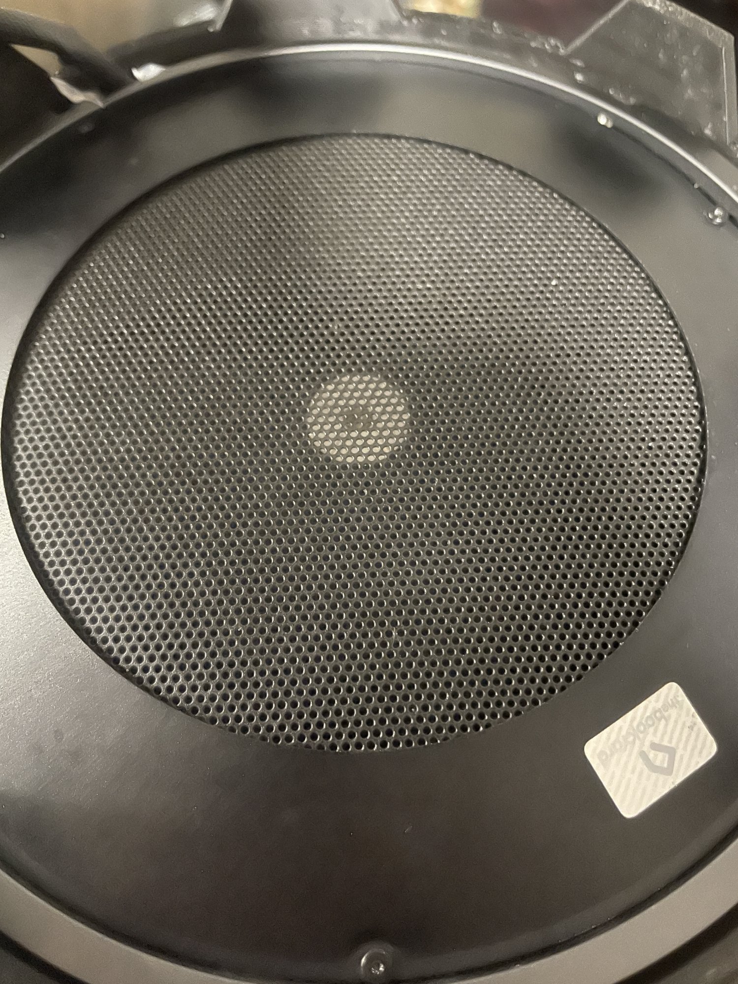

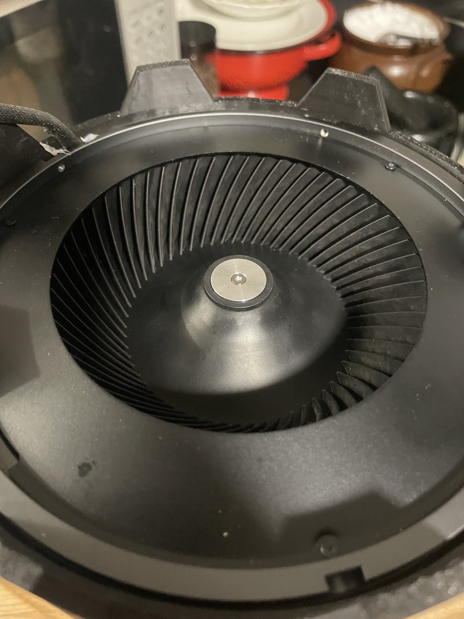

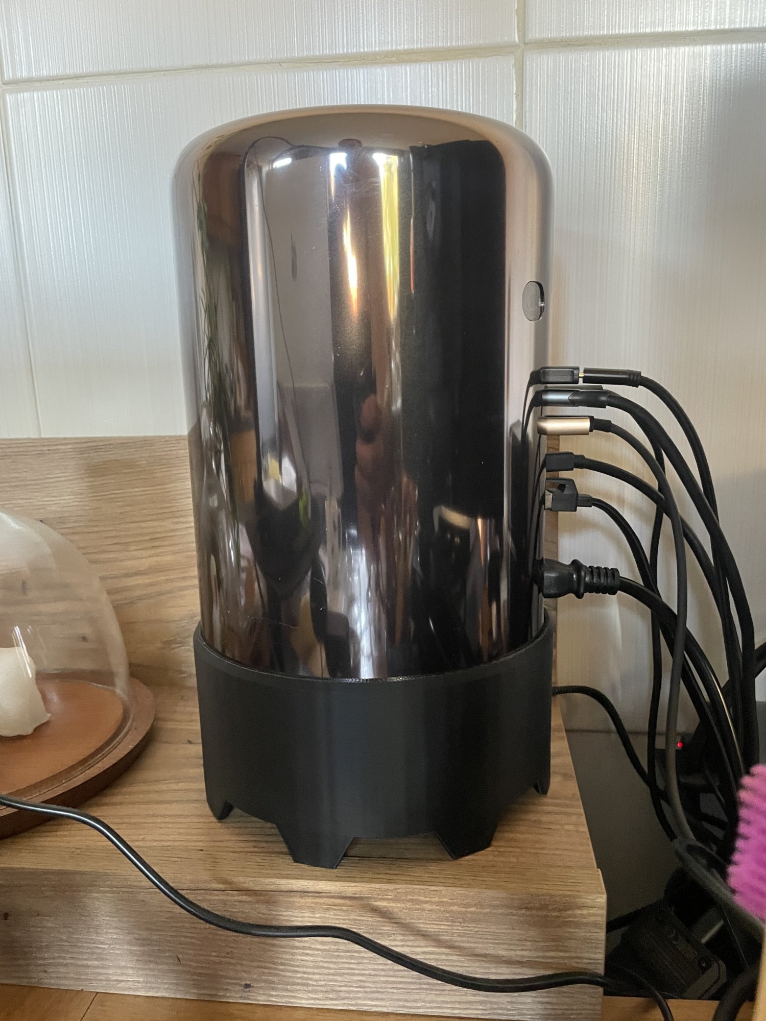

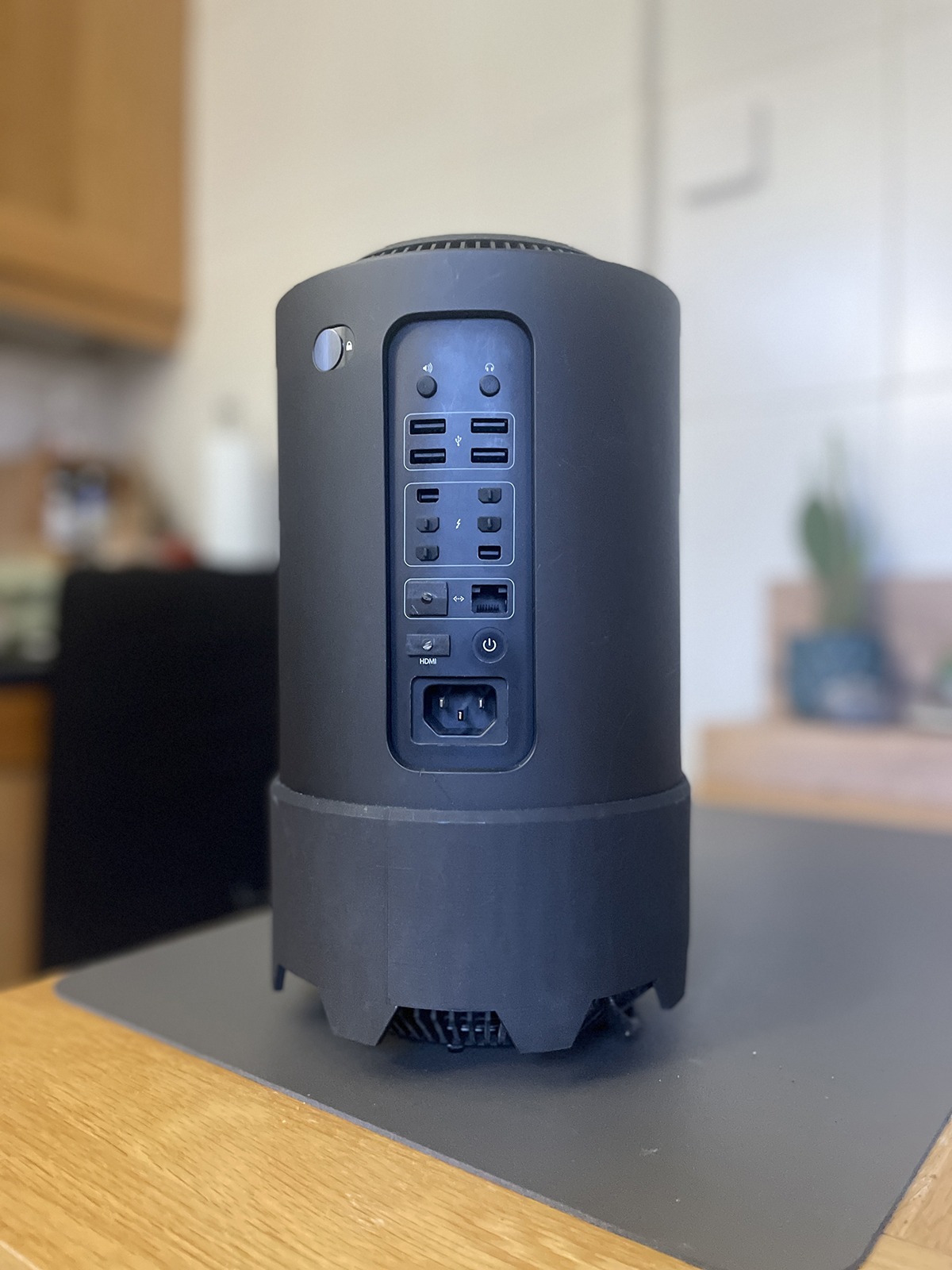

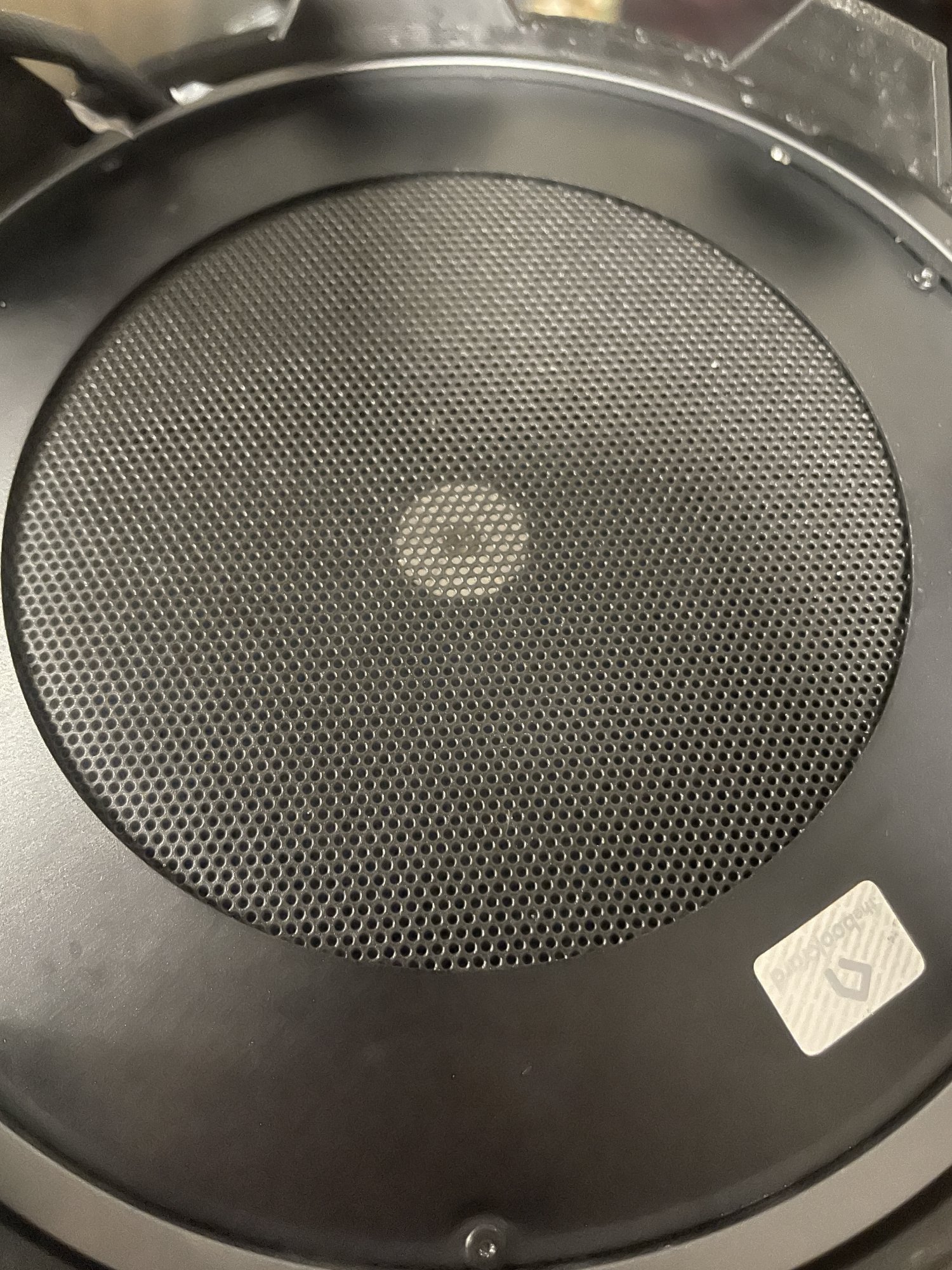

Hello everyone.

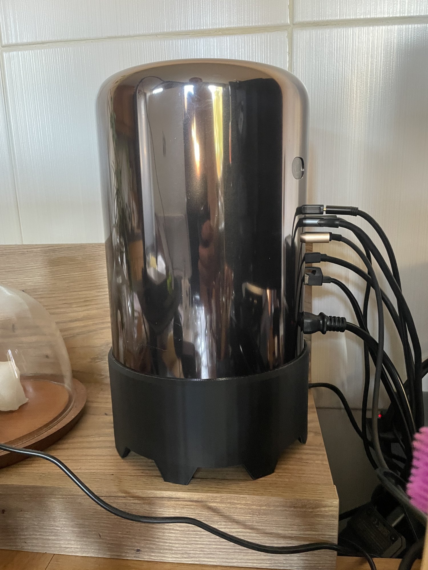

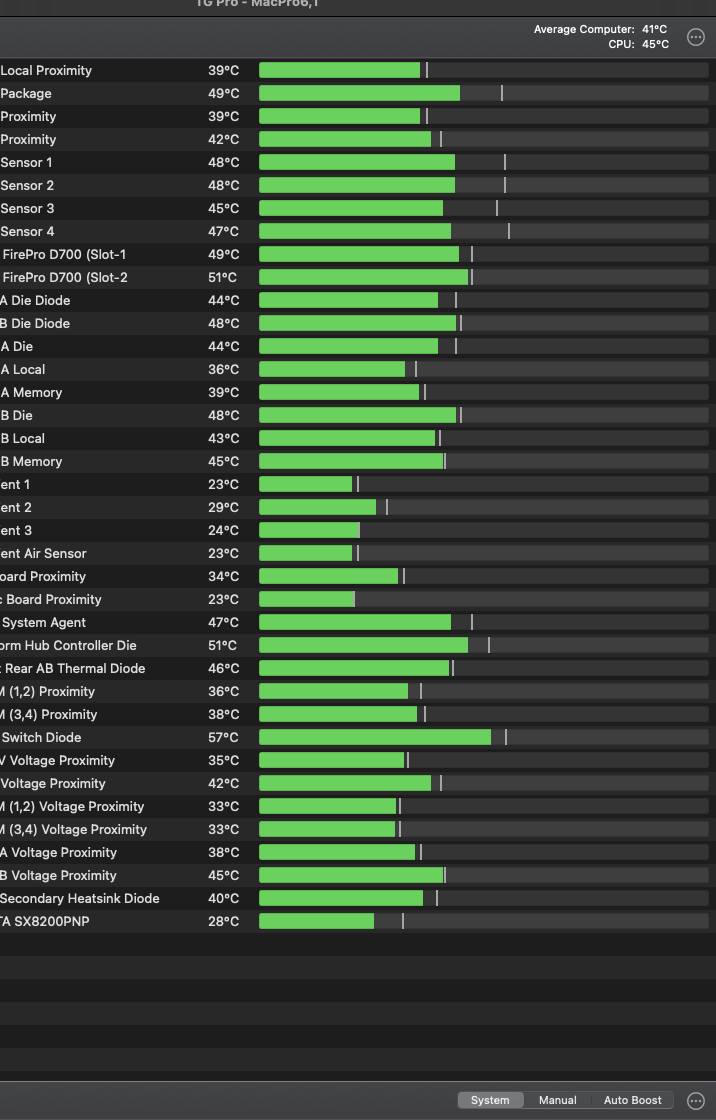

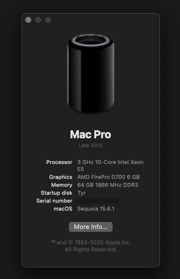

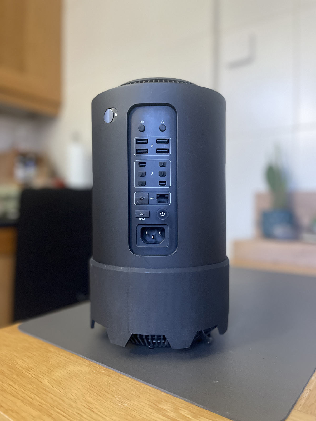

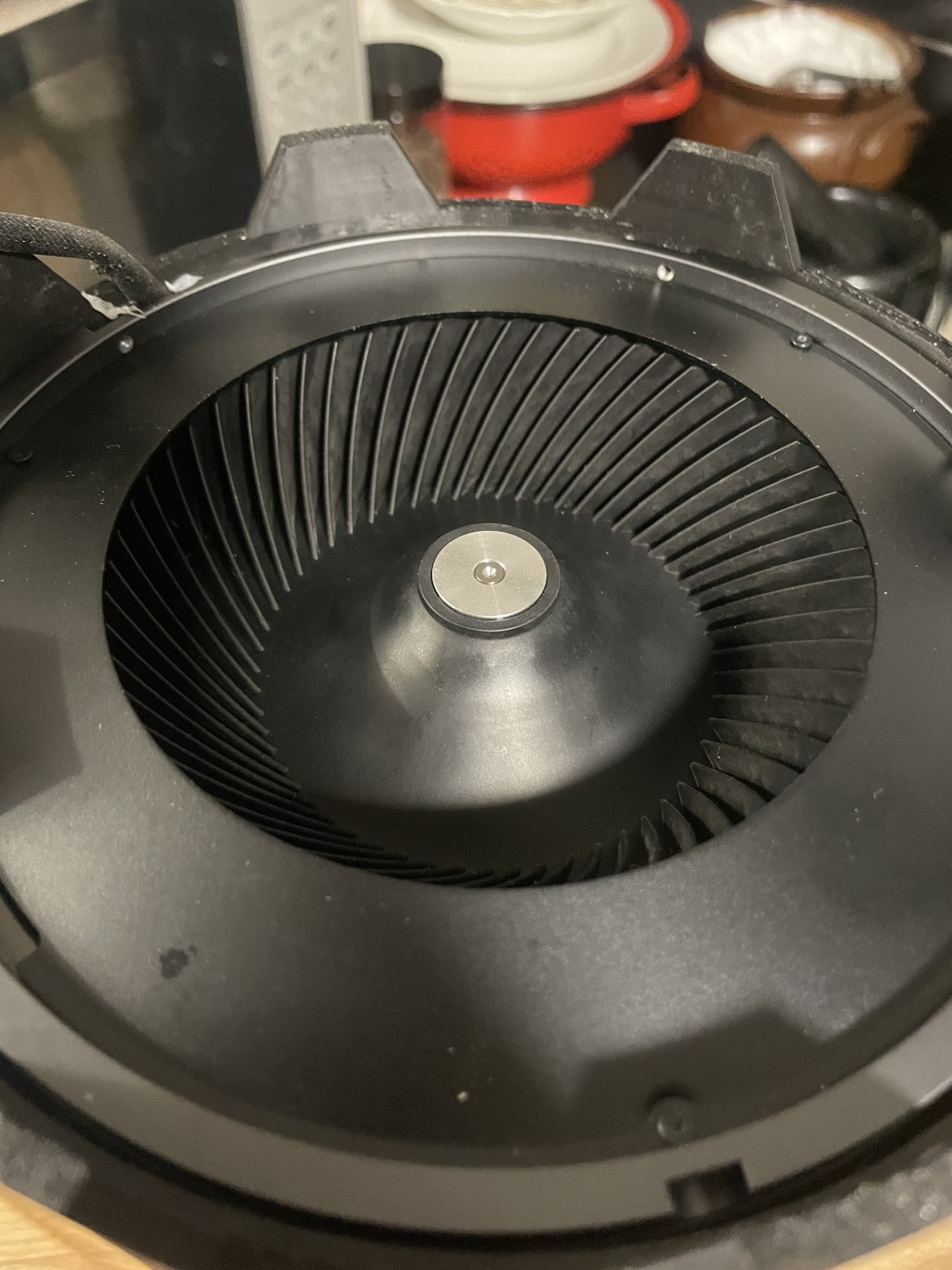

I also rushed to find a solution for the overheating MP6.1. I have the impression that OCLP, in combination with newer versions of OSX, which are more demanding in terms of system resources (RAM, CPU, etc.), cause older computers to work harder. I started looking for a solution and, using 3D and an additional original fan from the MP6.1, I achieved quite satisfactory results without the noise of an F-35 taking off. To improve airflow, I removed the original bottom cover, and the second fan is powered by a cheap 4-pin PWM controller. I soldered the cables into the fan's test pins and added a PVC mesh filter between the two original MP 6.1 fan diffusers.. At the moment, such a fan can be bought in the UK for £19, which is quite reasonable. If necessary, I also run TG pro on low settings so as not to drown out my thoughts :) I think that the whole thing doesn't look particularly awful and is quite compact compared to other designs 🤔

I'll add my two cents to this discussion. Could the operating system also have this effect? For example, while the machine with the latest Monterey support runs cooler, the open-core injected Sequoia draws warmer sensor curves. Could this also be a factor?
Hello everyone.
Final version and definitely last.
