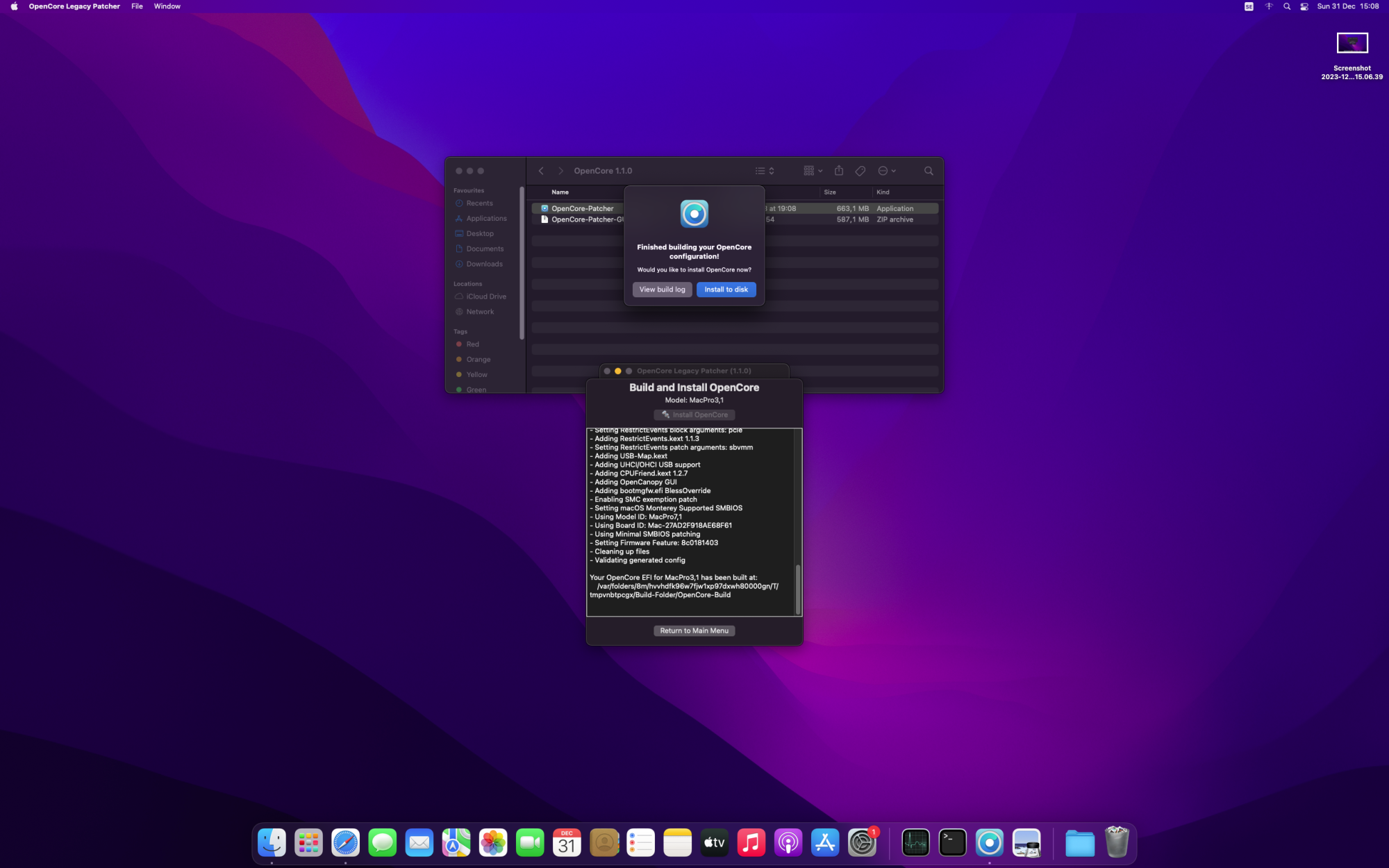

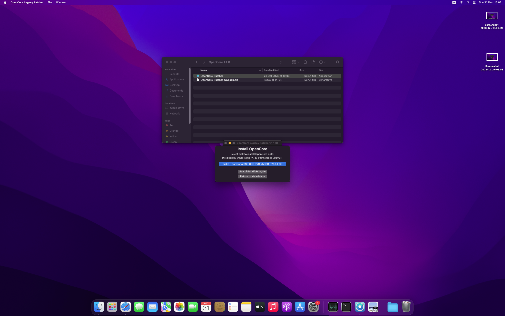

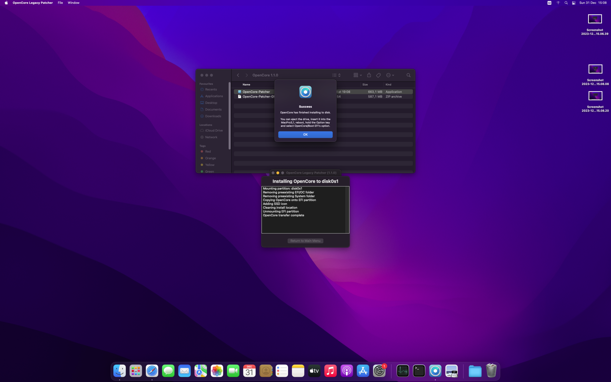

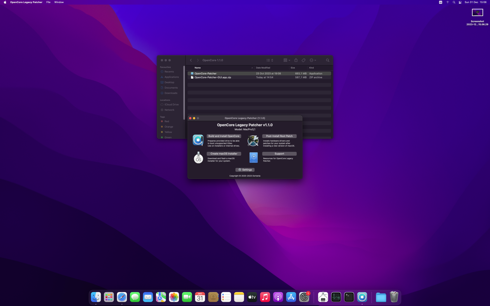

Progress so far. I will now reboot with OCLP 1.1.0.

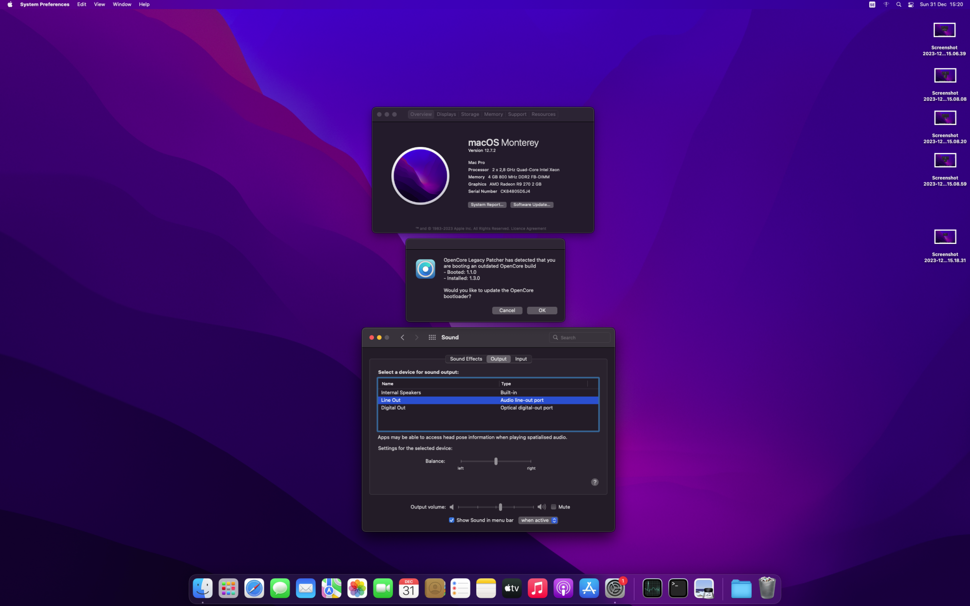

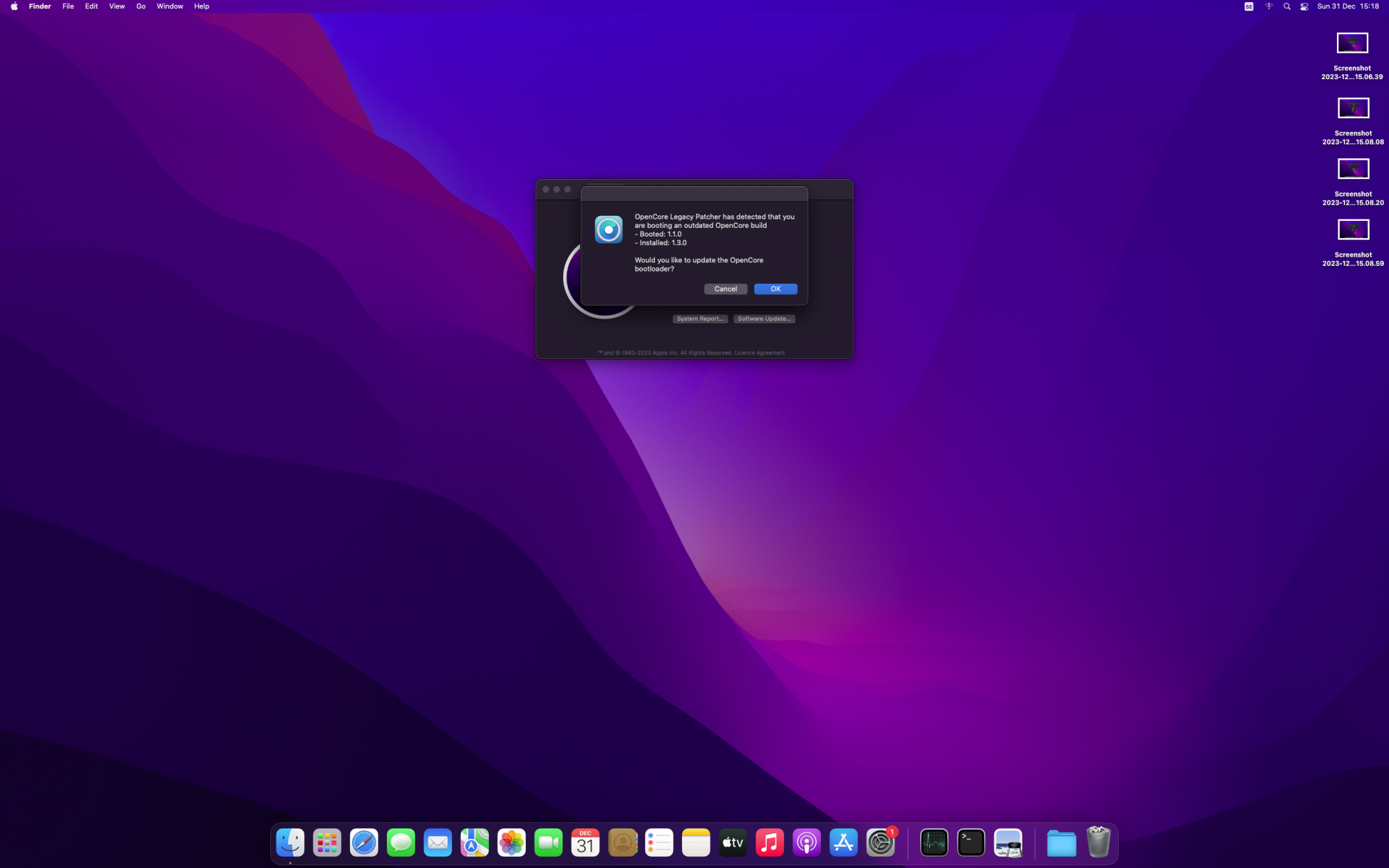

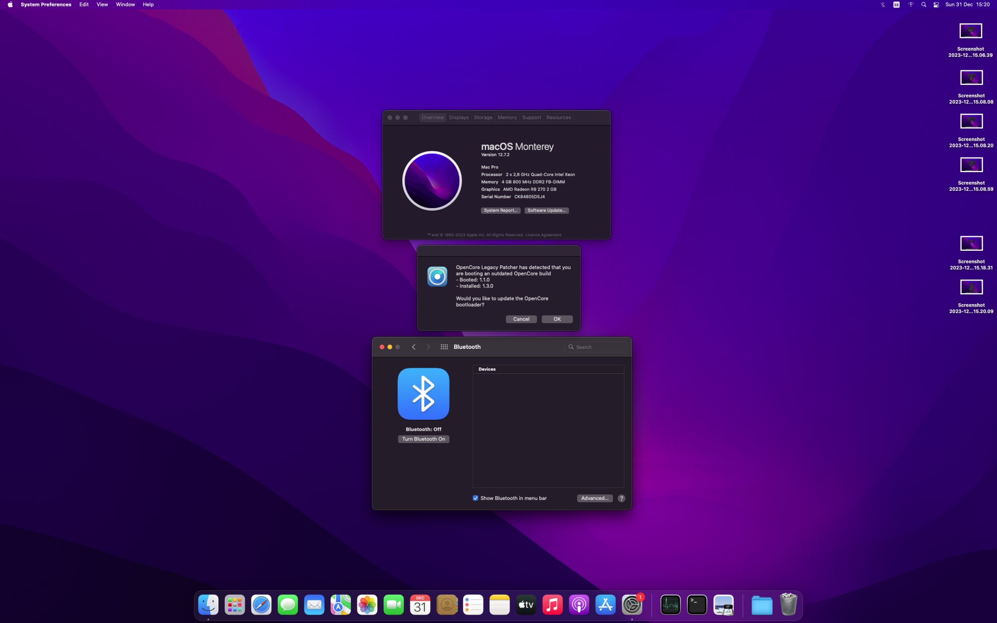

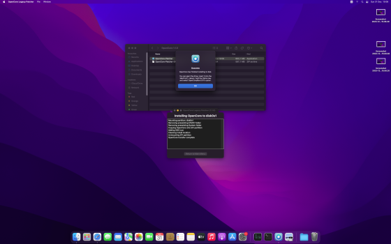

Progress update.
After OCLP 1.1.0 was written to the internal SSD, upon reboot, the system did not start. A shutdown with the power button on the front of MP 3,1 was done. A new boot and the system boots into the macOS Monterey login screen. However, this time, the OpenCore icon was visible during boot and also the "macOS boot progress bar" with black background. After 25 seconds, the system is online again.
Observations:
* OpenCore intuitively asks wither you would like to update from 1.1.0 to 1.3.0 directly after login. Actually great - knowing 1.1.0 did install to the bootable SSD.
* The graphics is now identified as "AMD Radeon R9 270 2 GB", not as "AMD Radeon HD 7XXX". I will revert with any possible glitches if identified. Worth mentioning, single screen setup works, two displays to be active might have required reconfiguration of the display ports, now using 1x DVI and 1x miniDisplayPort to Dual Link DVI-adapter. (Pre 1.1.0, I used 2x miniDisplayPort, so the graphics now being identified as R9 270 could have loaded another driver.)
* The audio is back (!). Quick test via volume up/volume down-buttons and Youtube via native Safari.
* Bluetooth is (still) not functional.
* "Computer sleep" via "Apple Menu  > Sleep" does not work, neither via Terminal ("sudo pmset sleep 1"). When using
 > Sleep, only the display dim, yet the system still runs with fans on both CPUs and graphics. (On my other MP 3,1, when selecting Sleep, the system dims the screens and it takes about 5 seconds for the fans to shut down and relays "click" in the MP 3,1 for a Sleep. The same system can also be woken up by Bluetooth, the Apple Wireless Keyboard and Magic Mouse.)
At least one item on the list from the previous that was not working seem to be functional. Please see the attached images for reference.
"Optimally", to be able to resolve the Sleep-issue would be fantastic. Again, one can "survive" without Bluetooth.
