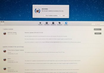

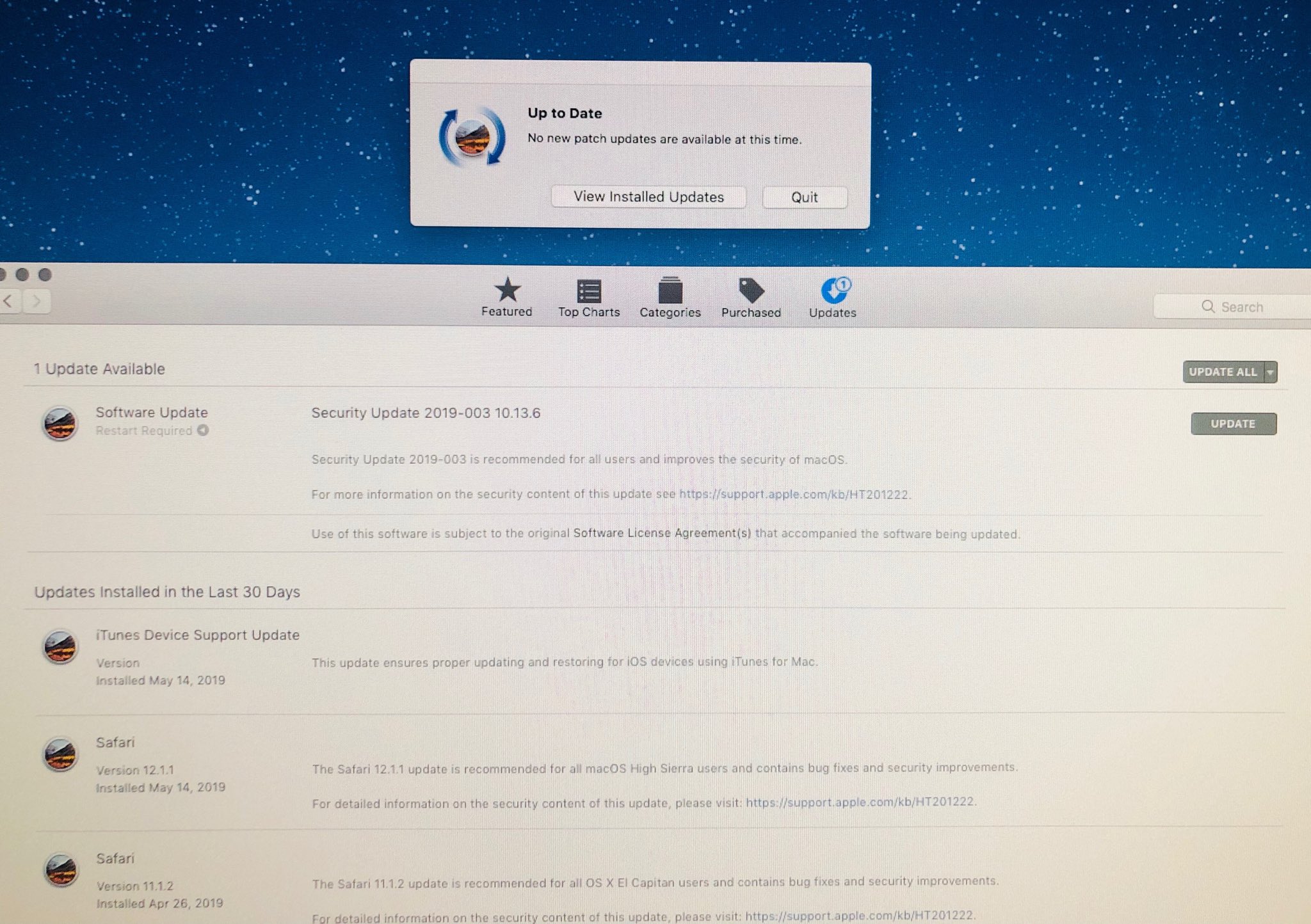

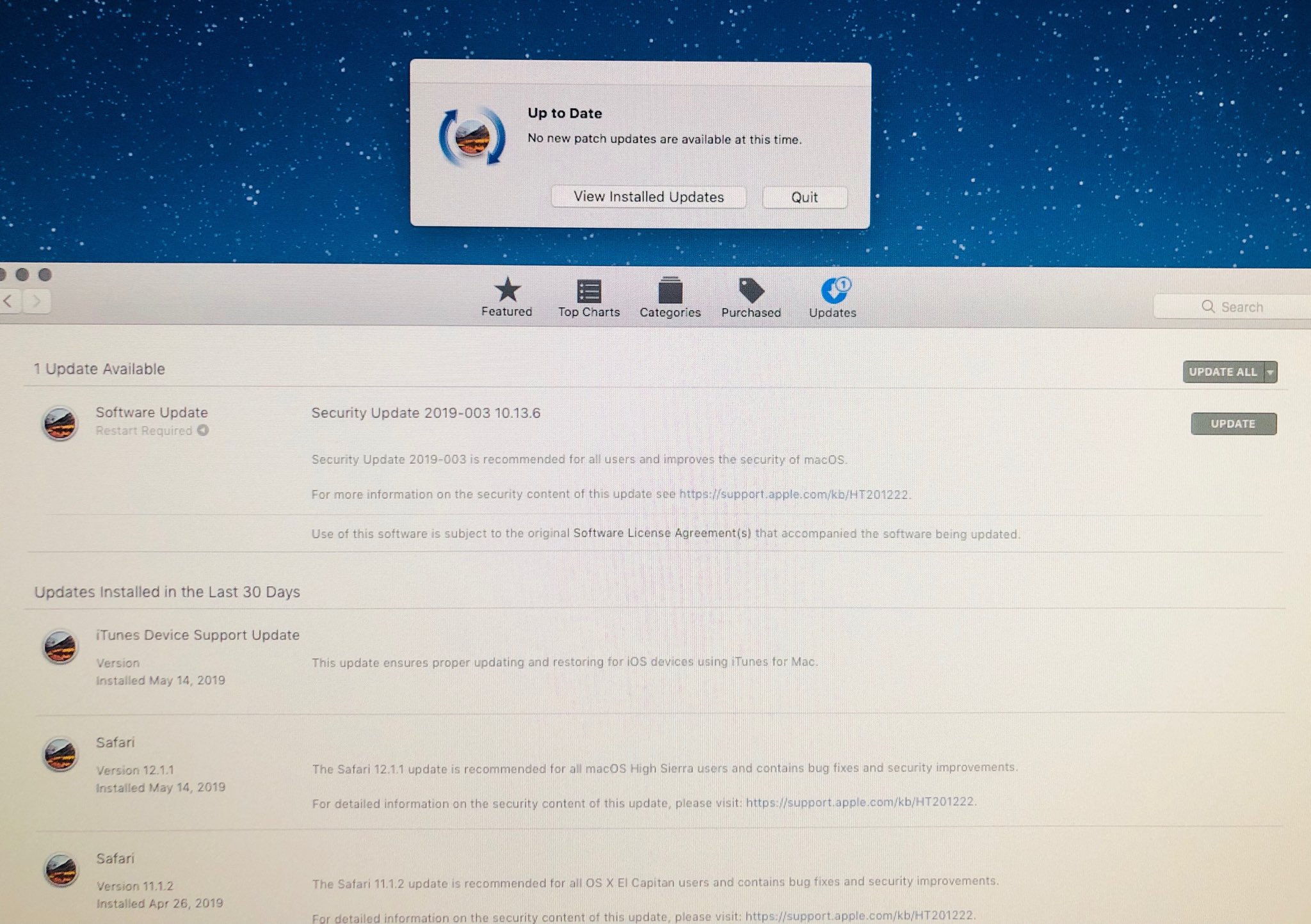

I just purchased a new (to me) cMP 3,1 and went through my first run of DosDude's patch to install High Sierra. I followed all of the instructed and did the post install patches but still have a question. Towards the end of the instructions page for High Sierra after item 11 is "Additional Info," see below:
  • If selected in the macOS Post Install tool, your High Sierra install will have a program named "Patch Updater" located in your /Applications/Utilities folder. This program will alert you when new updates to patches are available for your machine, and will prompt you to install them. If you do not have Patch Updater installed, but would like it, you can download and run the script found here to do so.
After I ran the post-patch tool and insured the necessary items were added for my 3,1 which included "Install Patch Updater" which is not located in my Utilities folder as version 1.1.0. Upon reinstall, it did launch and alert me a Dark Mode patch was available and I applied/restarted without issue. Now there is a Security Update via the Apple Store but not the Patch Updater. I believe I can run via the Apple Store and if it doesn't reboot properly to boot from my installer USB stick and run the Post-patch process again as described below:
  • If the machine does not start up properly after applying a system update, you will need to boot off your patched installer volume, and re-run the post-install patch on your High Sierra volume. Ensure you select "Force Cache Rebuild" before rebooting.
Before I did, however, I wanted to check with others who have surely run into this and know the proper route to take.
