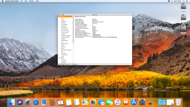

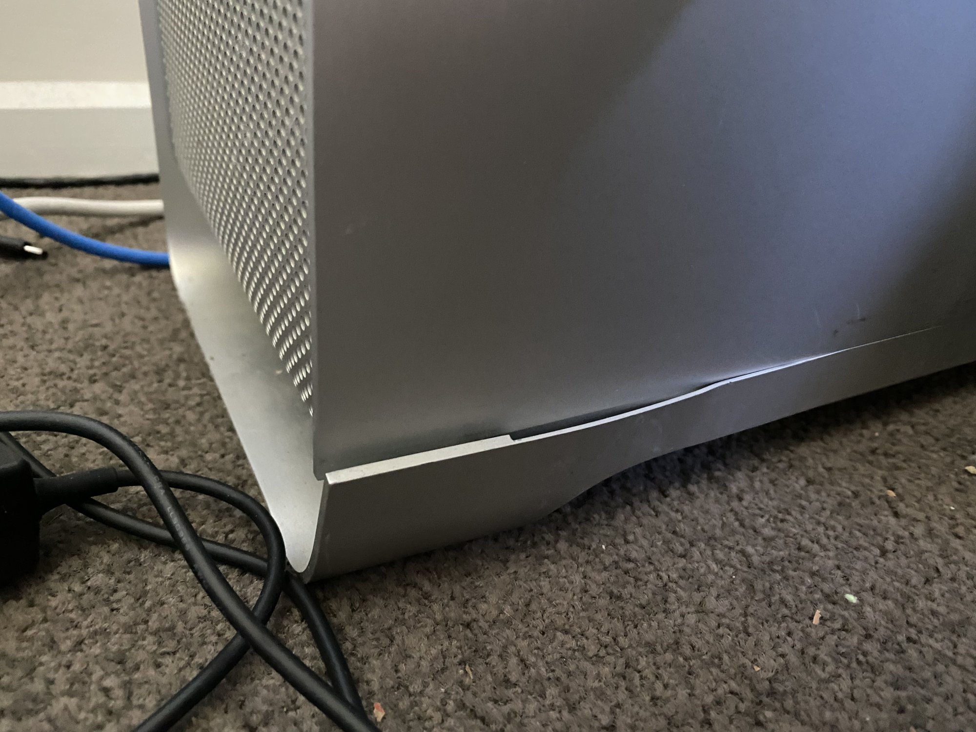

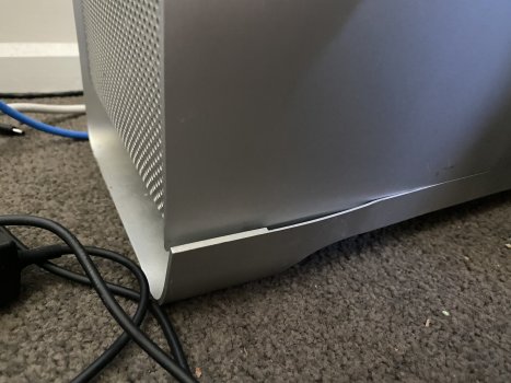

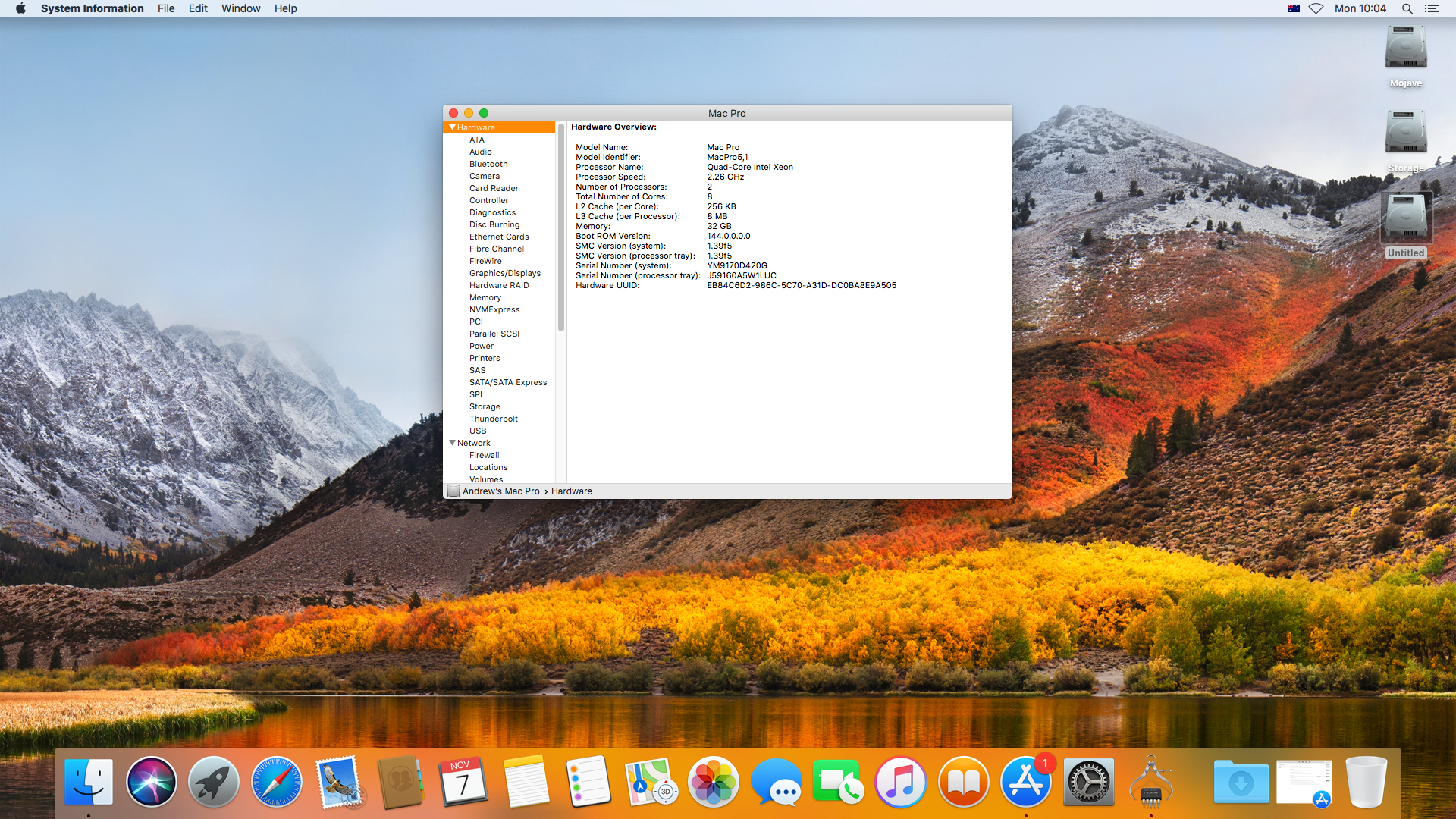

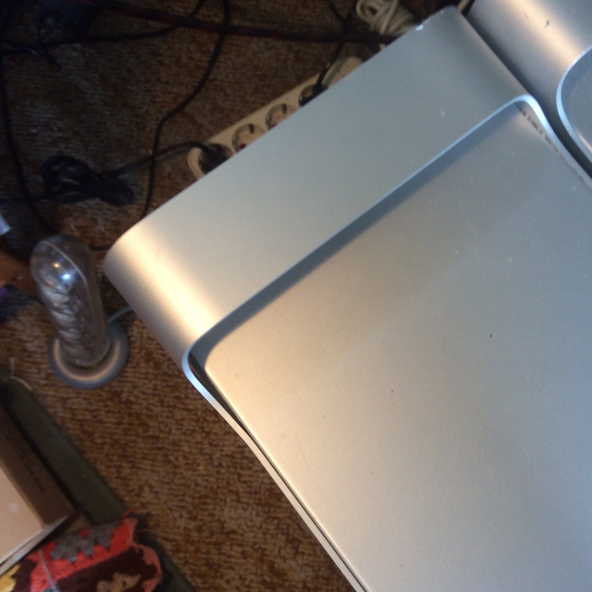

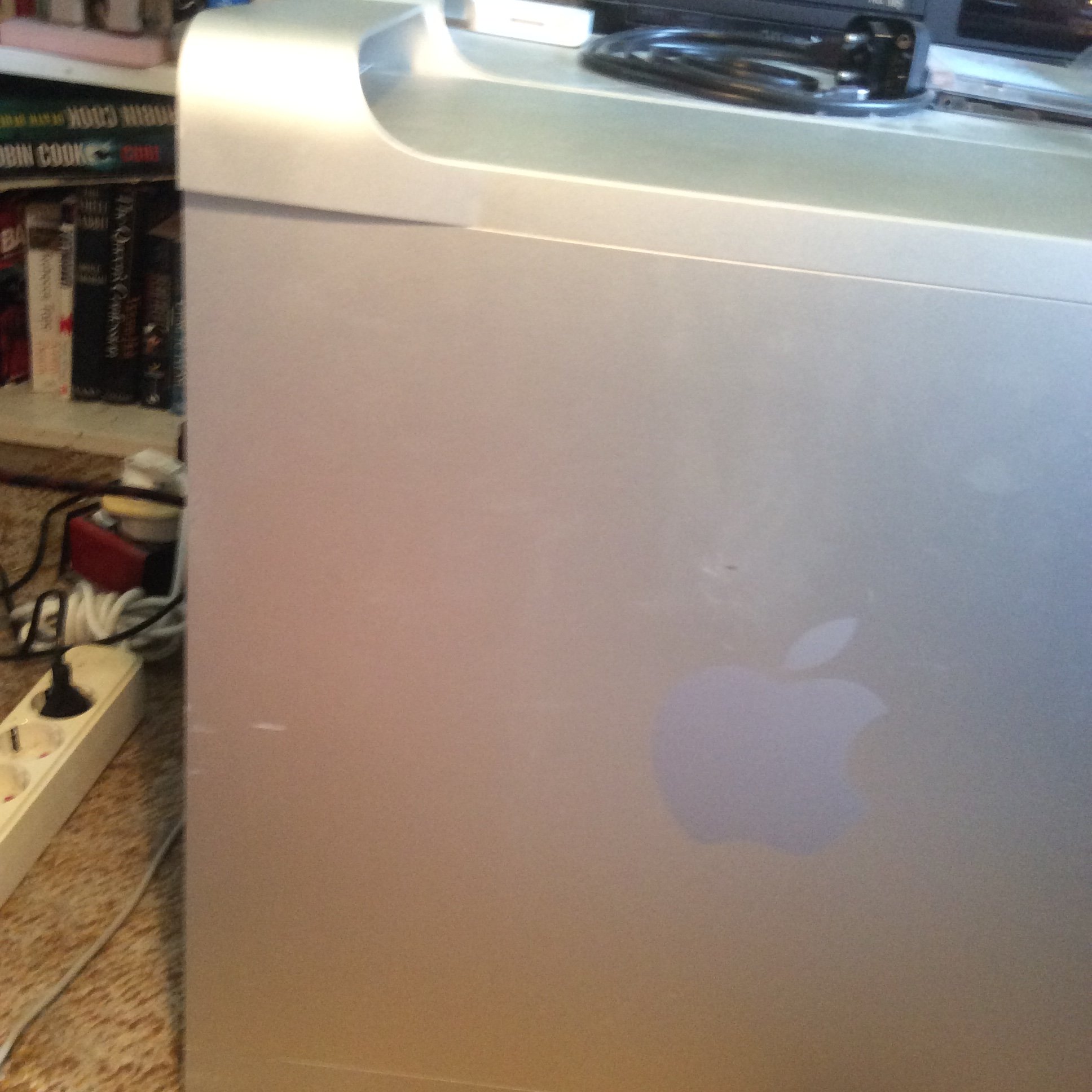

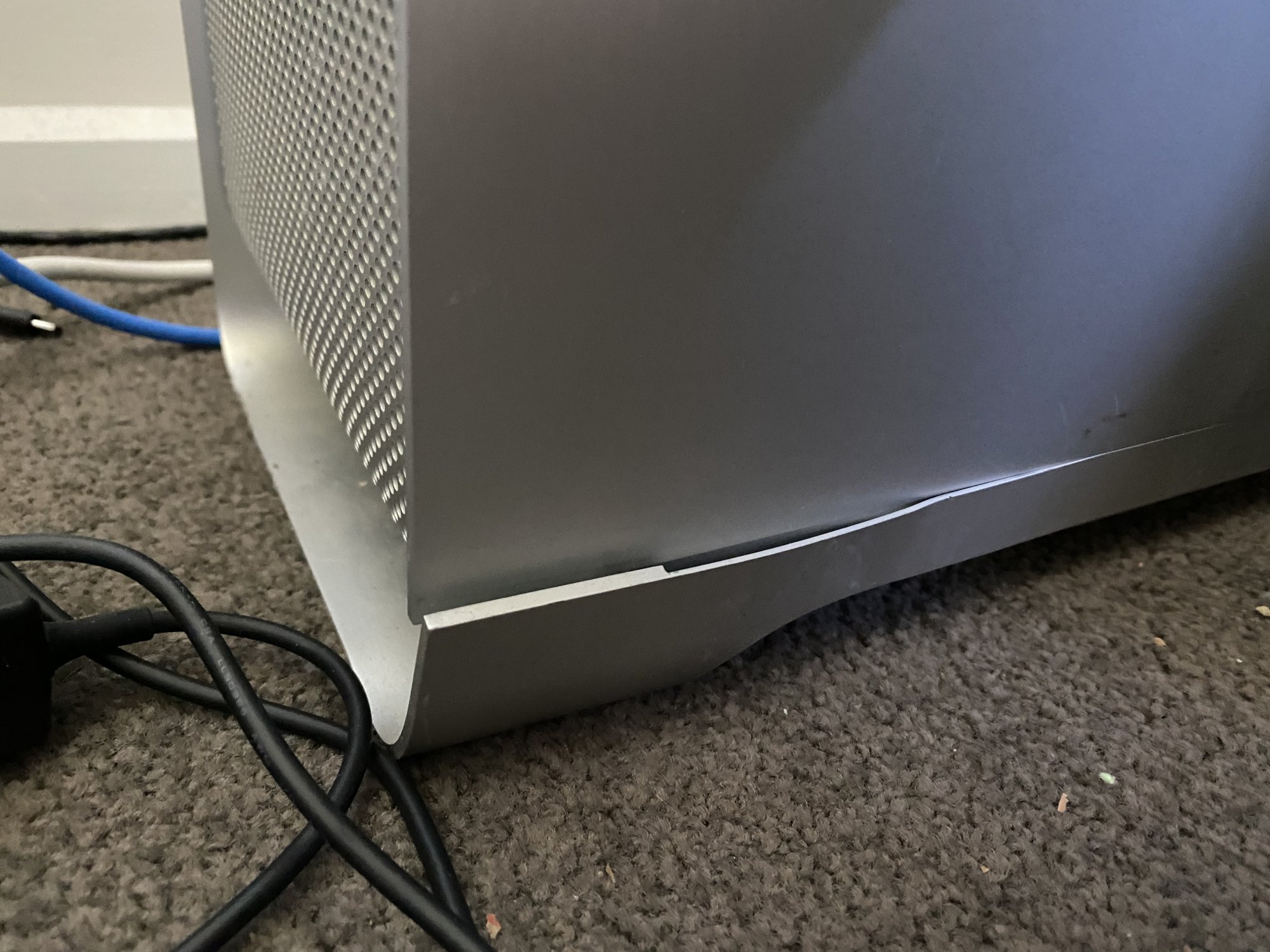

Recently took possession of my 4.1 which has been upgraded to 5.1 and the firmware is the last and desireable 144.0.0.0.0.
However when I received it it appears to have been in a physical fall or drop or something.
Separation is 5mm at the top near the DVD area. See pics.
When i started it it was very twitchy for a while when i was looking at the GPU and checking the RAM.
At one point there was a red light at the RAM point (front) and I received RAM errors on several restarts and omitted to count one of the RAM sticks.
Then it seemed to calm down - yes a very technical term, and upgraded to the last iteration of 10.13.6 High Sierra without any issues.
i know the Ethernet port works and the wifi installed card works so far etc.
The issue now apart from sourcing all my hardware upgrades is whether to attempt some panelbeating or panel replacement assuming that is a thing, or send it back or make an insurance claim.
Is there a schematic about the hardware case construction? Can it be repaired?
It seems the courier company was rough with it and I am trying to find a solution.
What can you recommend in this instance?
I’ve had the same poor handling with cMPs that have been couriered to me. Insurance may be limited to the carriers limits (NZ$1500 I think, but you’ll need to check). For me, I got the seller to send me another cMP (which arrived with a dead backplane!) so I got a refund in the end on a replacement backplane and kept both machines as part of the remedy.
I didn’t bother to panel beat my damaged cMP frame much because the rivets were pulled through. Make sure you remove everything (backplane, PSUs, fans - and of course CPu cage and back and front I/O boards) if you decide to do any panel beating - before you take a hammer to it. I’ve just lived with my handles being a little askew and lisping to one side. But luckily there was no actual damage to the components, surprising given how the bad the drop must have been (butchers).
Yours doesn’t look too bad cosmetically, but you’ll need to test it thoroughly.
I don’t have a schematic for the cMP housing/frame but if you want one for the service manual I’ll send it to you.
