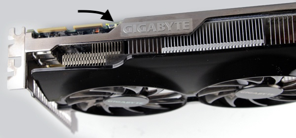

So those cards do they have a switch on the side? That switch when flipped can give you Windows UEFI boot. But you will loose boot screen. Don't flip the switch while running.
Reactions: explit
So Windows on the NVMe need UEFI. And UEFI Windows installation could harm Bootrom. Right?
So Windows on the NVMe is NoGo on the Mac Pro?
The BIOS switch on R9 980X cards should be set to Position #2 prior to starting any flashing operation.
The same goes for HD 7950 & HD 7970 cards.

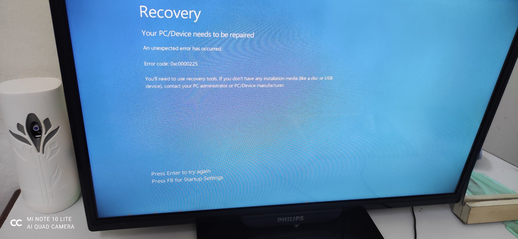

I have a flashed r9 280x and had no idea why my Windows partition wouldn't start. This thread mae it clear. I ended up pulling the drive and connecting it to my Macbook Pro via usb and booted into Windows. After that I ran AOEMI Partition Assistant and converted it to an MBR partition from GPT.
I placed it back into my Mac Pro 5,1 and held Alt/Option and selected Windows. Was getting errors that the drive was inaccessible but had the old Windows Safe Mode Selection menus. Decided to randomly boot into Safe Mode with Networking. At this point I was resigned to the fact that it was fubar. Lo and behold on the next restart, it booted up perfectly fine using a flashed r9 280x.

Bro how to bro pls tell me me to some problem
Pls tell r9 280 not boot screen windows how to fix this problem bios apple fine work but he not working how to clear fix pls tell me guys
