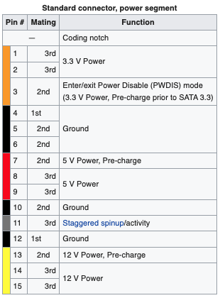

For the sata connections, all I see online are 15pins, how does that work? Or must it be 22 pins
15 pins.
You would want a 2x SATA power to 6-pin cable though.
One can not know if the GPU will pull more than 54W (1xSATA power max spec) at its 6-pin connector, so you better feed it from 2x SATA power (=108 max spec) just to be at the safer side of not burning anything.
SATA Data = 7 pins
SATA Power (standard connector) = 15 pins (3.3V, 5V, 12V)

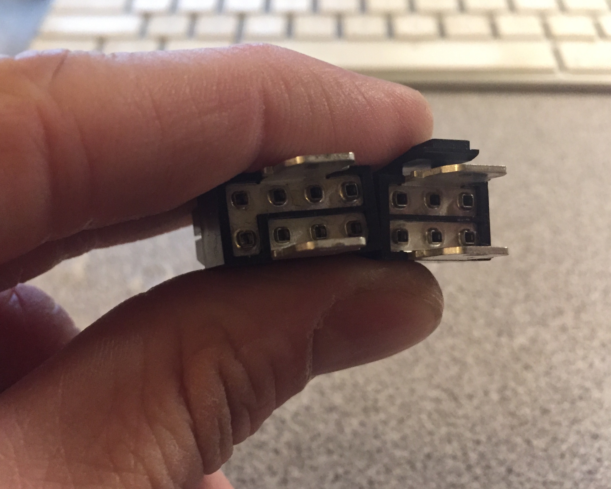

The Mac Pro 4,1 | 5,1 will provide 150 watts for each 6 pin plug. Why? The 8 pin plug has 3 - 12 volt pins and provides 150 watts. The 6 pin plug is specified to only have 2 - 12 volt pins and provides 75 watts. But many manufactures deliver 12 volts on all 3 pins on the 6 pin plug. So why is there an 8 pin plug if 6 pin plugs can give you 150 watts. Because not all 6 pin PCIe AUX plugs have all three power pins connected. But in the case of the MAC PRO 4,1 | 5,1 all 3 pins are connected, the same 3 pins on the 8 plug. 8 pin plugs are only around to ensure pin number 2 is also powered. It is my understanding many manufactures connect pin number 2 in the 6 pin plug, but it is not guaranteed. So thats why we have 8 pin plugs.
[doublepost=1488680084][/doublepost]
Again this is on the MAC PRO 4,1 | 5,1. All three power pins are connected, the same three pin on the 8 pin plug. So yes you will have 150 watts from this motherboard. You just need the correct 6 to 8 pin plug. In the picture you can see the additional pins are just jumpers.
