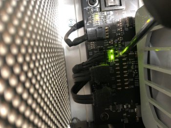

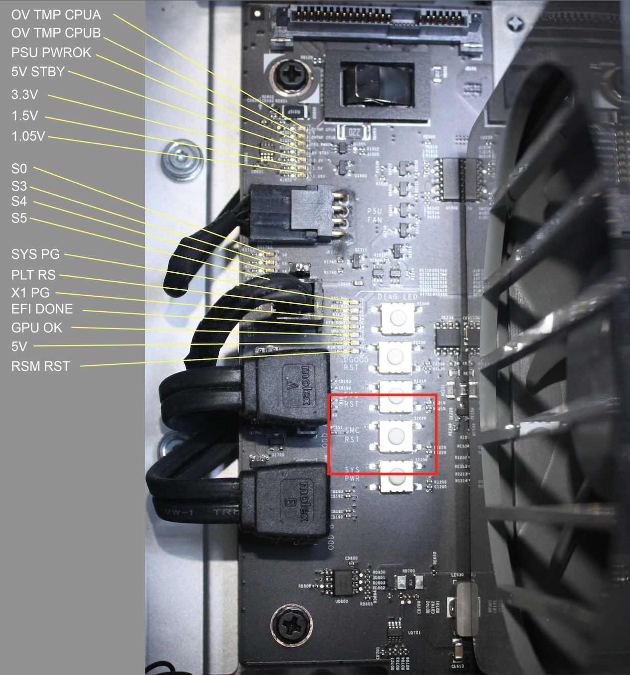

I have attached a picture of the diag light, if that helps.
The OVTMP CPUA and OVTMP CPUB LEDs do not flash red when a power supply is connect or disconnected.
There is power in the USB ports, but can't seem to get the Mac to react to it.

But now it seams to flash red when I plug it into a power source

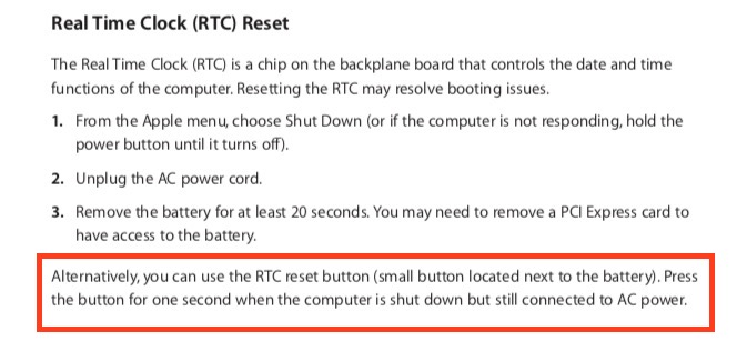

@krakman
please don't spread nonsense!
this button has nothing to do with the SMC.
the SMC reset button would have to be soldered first!
and with the power unplug and the 15 sec before replug you do the SMC reset ; -)

If I don’t have a solder SMC can I jumped with screwdriver or something else?
SMC auto-reset itself if you disconnect the power cable from the PSU for 20 seconds. SMC button was only needed while Apple developed the SMC firmware, no production boards have it and you don’t need to short-circuit the pads, just remove power.
