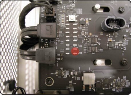

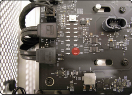

I cannot turn on the computer the leds on the motherboard of cpu A and cpu B flash but when I press the button on the computer does nothing it does not start. when i press the button on the motherboard i have the 5v stby led which lights up in orange. is the food that is dead?
Try jumping the sys_pwr pads with a paper clip or wire. If the computer turns on then you have a bad front panel board.
when I press the button, the cpuA and cpuB indicator lights remain on and no longer flash.
otherwise the paperclip I put it between the two points which are in the red circle.
