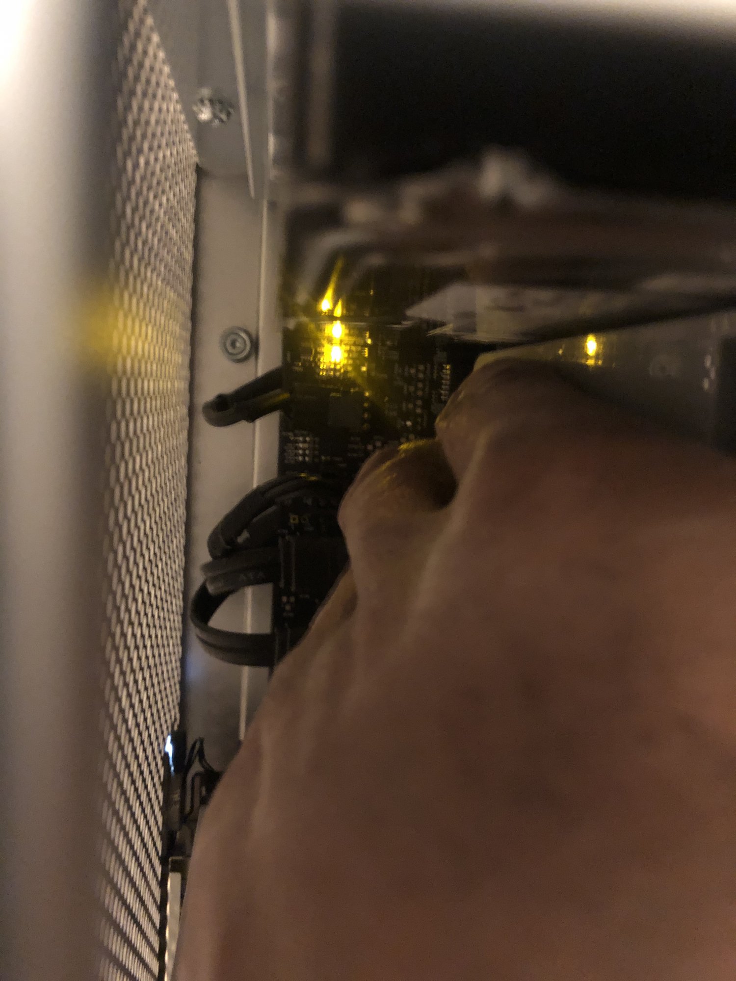

Same problem here as well with my Mac Pro 2010 5,1. Did you ever find a solution. I have swapped out the power supply, mother board, power switch board (but not the actual button) and CPU tray using another Mac Pro and still nothing happens when I push the power button. When I push the diagnostic button inside the yellow LED lights up and when I plug the power cord in I get a red light on the mother board to flash. Thoughts

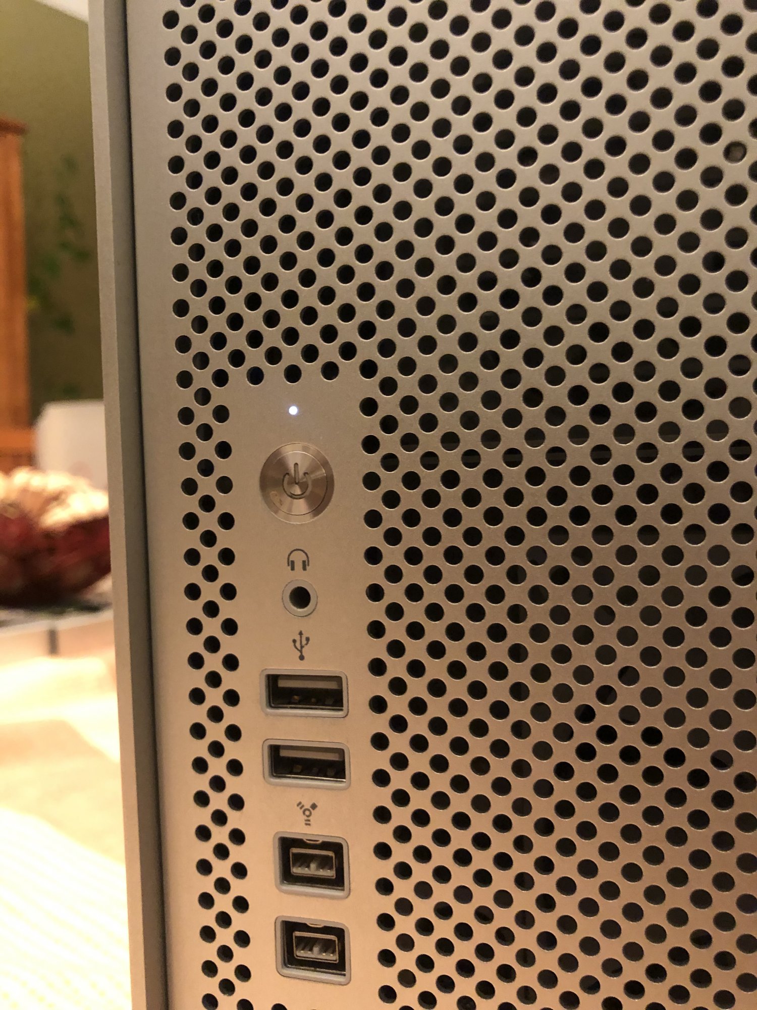

Narrowed it down to the power button. Replaced with one I had in an older 1,1 it but now both machines have power button lit when plugged in and they don’t power up when I press the button. At least they both have the same issue. Tried different power cables with no success but will go through diagnostics tomorrow. Maybe the power buttons are plugged in upside down?
