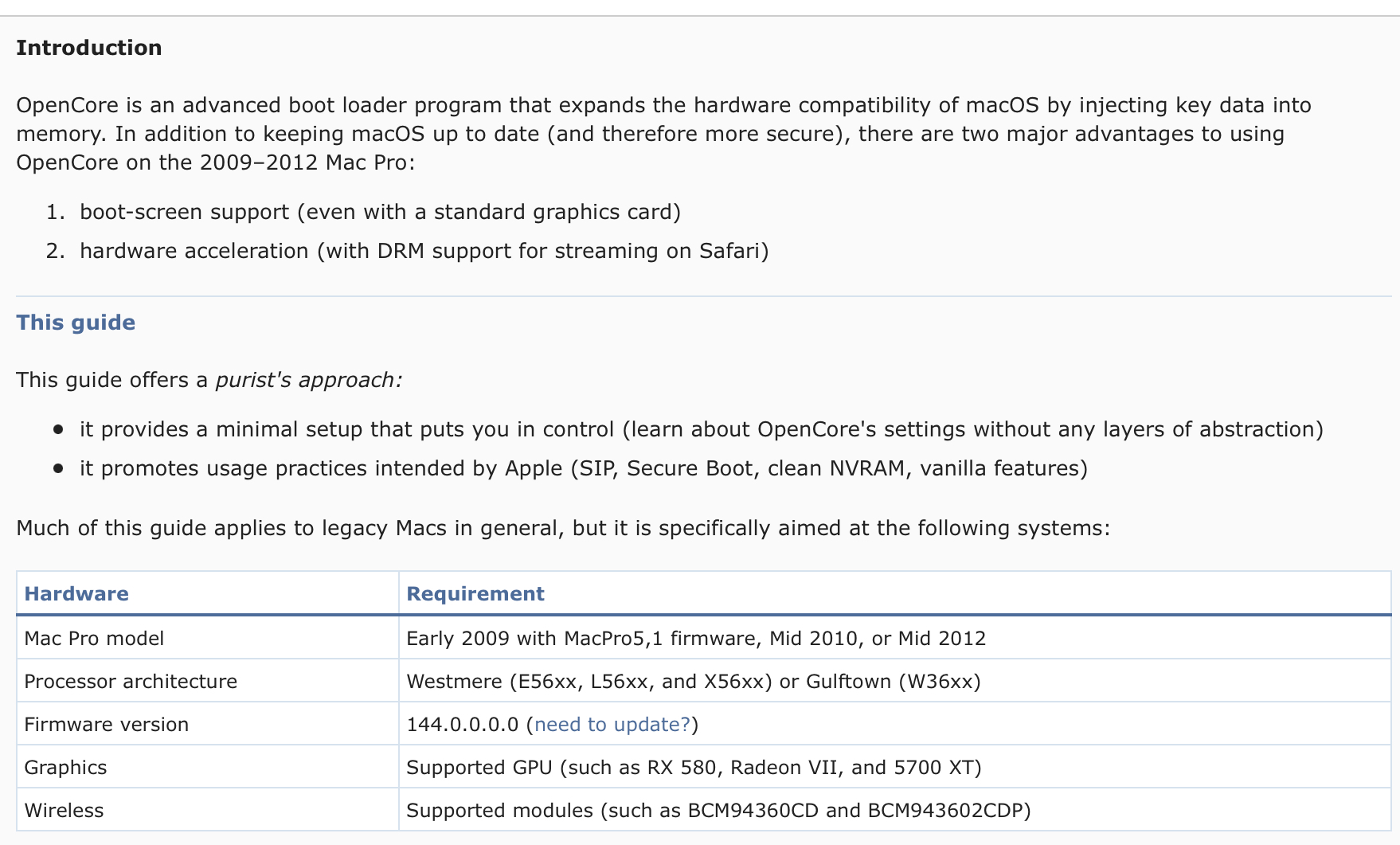

From what I have read in the wiki (on THIS site) it says otherwise in the 'requirements'.
I have only quoted what I have taken to be correct information.
(if it is wrong someone should update it).
All you have done is point to requirements for ONE (1) specific way of implementing OpenCore out of several. Regardless, what it says is that while that way works for a variety of units, it is targeted at those with the parameters listed. It doesn't say OpenCore does not work on those that do not have those specs (actually implies it can be used on such) and not sure how you came to that conclusion from what was written.

@Dayo In fairness to @MarkC426, I re-read the wiki post containing that table and I also found the phrasing a bit unclear. I edited the post and clarified (I hope) that those are not OpenCore requirements and are simply assumptions about the user's hardware when following the guide. I hope this is helpful to others in the future.

Unfortuantely, your edit has wrongly changed the meaning of what was originally written.
The information there was always talking about that guide and that guide alone. It said the guide generally applies to legacy Macs but is specifically targeted at those in the list.
You have now changed this to basically say while OpenCore works for others, that specific guide only works for units with the specs in the list; which is inaccurate.

The meaning of the original phrasing was extraordinarily unclear, especially given the table header that lists certain hardware as a "requirement" when in fact that hardware is not a requirement of either the guide or OpenCore. If you wish to make further changes, I suggest changing the table header.

The meaning of the original phrasing was extraordinarily unclear ... I suggest changing the table header.
It is only unclear when the lead-in sentence is not read or misread.
The sentence had a subject, "this guide" and not "OpenCore". It said the subject of the sentence, "this guide", applied to legacy Macs in general. However, the subject of the sentence, "this guide", was specifically targeted at stuff that met the requirements set out in the table that followed.
I suppose the use of "requirement" in the table was not the greatest choice but minor unless the lead-in is ignored or another totally different subject arbitrarily inserted as seems to have happened.

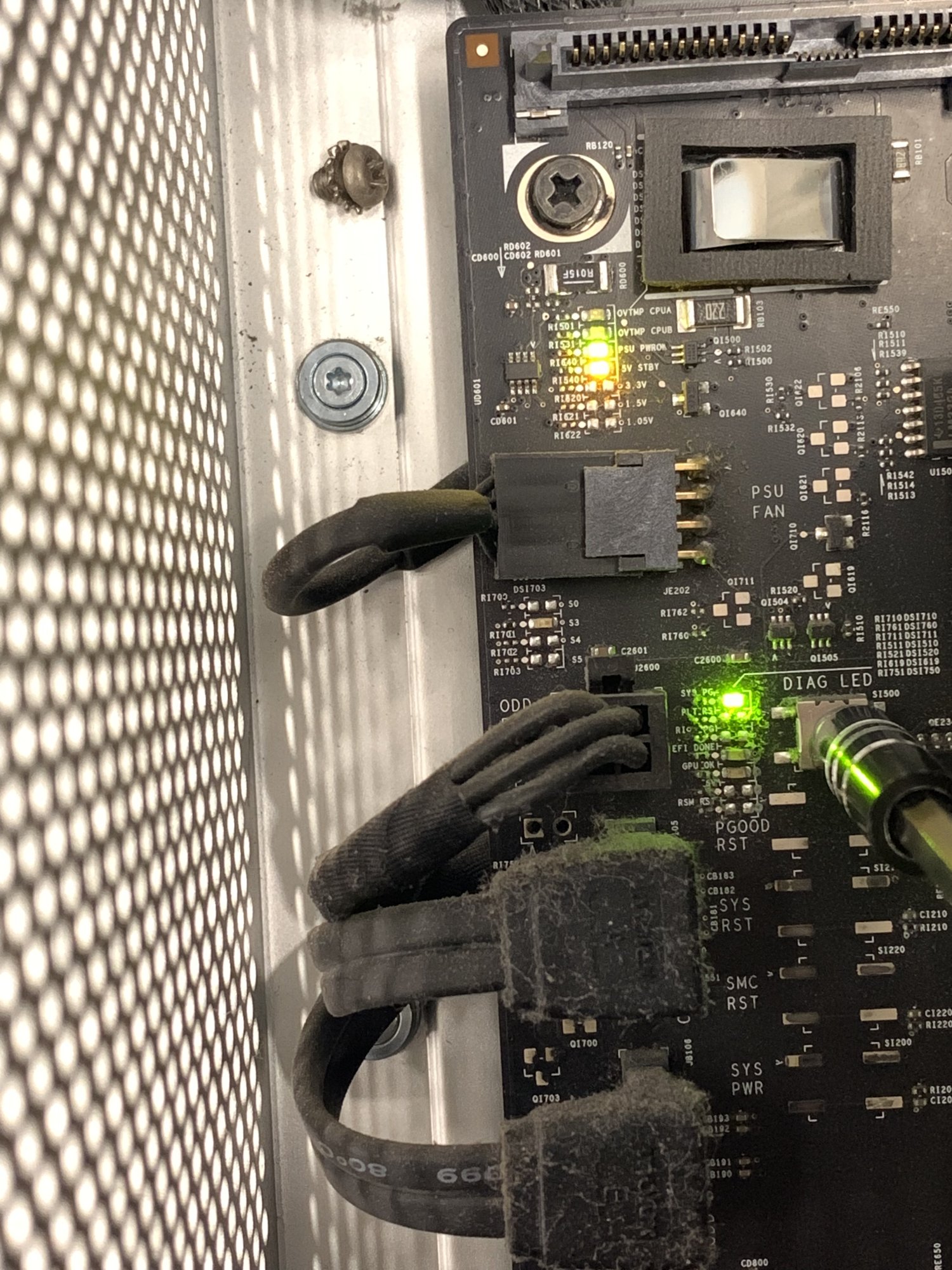

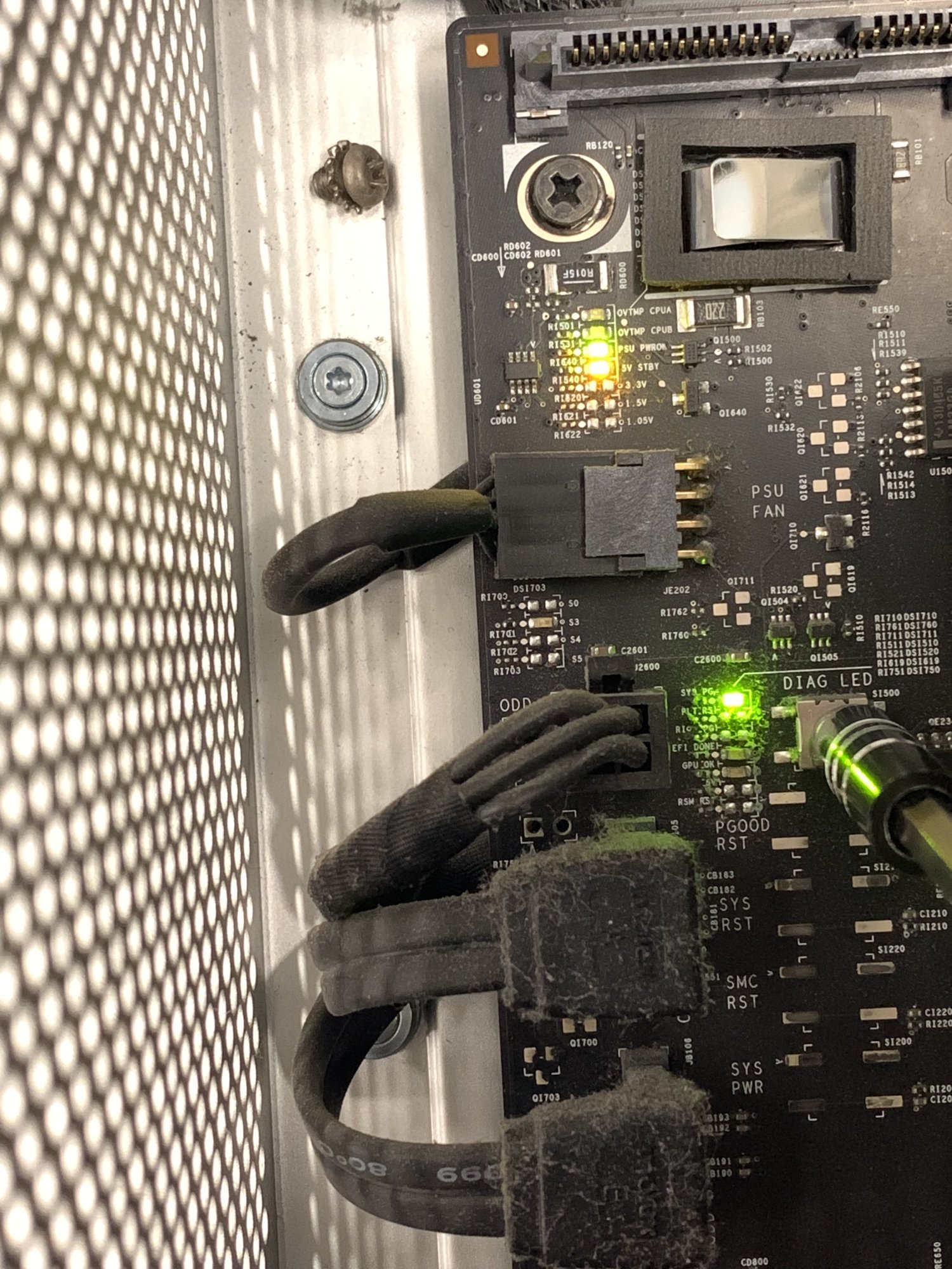

I tried the nvram reset and still nothing. Does the diagnostic lights show anything?
Did you hear a chime ? If so, how many?
If not chiming, as seems likely given the lights, then the issue is not just with the GPU stuck on the Start Manager which it cannot display and you instead likely have a brick. You will need to send a PM to @tsialex in that case to go through your options. If not chiming though, not sure how you did a reset.
