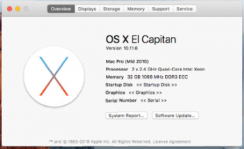

New update: Mac is now booting into Mac OS and I've been able to remote in with work's remote access software but no graphics card seems to work (have now tried the original 5870, my 7950 and an r7 240), also it doesn't recognise any of the GPUs, nor the serial number of the machine in 'About This Mac'. That could just be because I pulled the hard drive out of an old iMac to save re-installing the OS + it already has the remote access software setup on it.
I'm still leaning towards a bad GPU but can't understand why neither of the other two work? Does anyone have a 5870, 5770, GT120 etc or something flashed I could buy as the ones on eBay are ridiculously expensive?

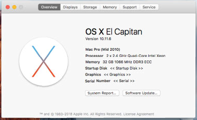

Save a SystemReport, compress it and upload it here - something is very weird.

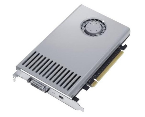

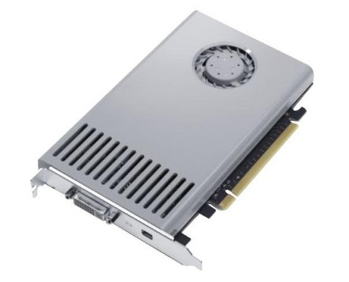

An Apple sold GT120 has the EFI . It looks like this :
They are cheap and will boot any macOS on a cMP , although with Mojave it will have very low performance .
This card does not allow you to install macOS Mojave , though .
An EFI GT 120 will install Mac OS X / macOS 10.6.4 to 10.13.6 on a Mac Pro 5,1 . It will also allow you to install the Dosdude patched version of Catalina onto a cMP .

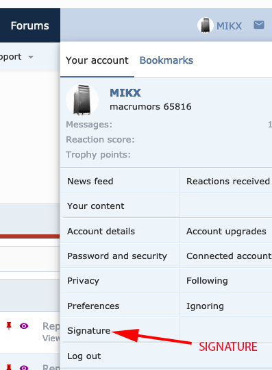

You could also go to your Macrumors Member profile. . look for "SIGNATURE" and type in everything important about your Mac Pro eg :
Which mac OS is installed
What is your current Bootrom version ?
Which GPU is installed; Brand & maker & RAM
etc.
My SIGNATURE is displayed at the bottom of this post

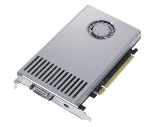

Hi, I've had a look for one of those thinking it would be the cheapest option but could only find one on eBay for £45 which is a bit much just to test this machine with and probably will never be used again.

I agree, thank you for having a look at this for me. 🙂
Besides having a lot of old cruft on your disk, I didn't found any immediate motive for this weird AboutMyMac screen.
Why it's not detecting any PCIe cards? Did you tried installing on the other slots?
Your Mac Pro BootROM is from 2010, btw.

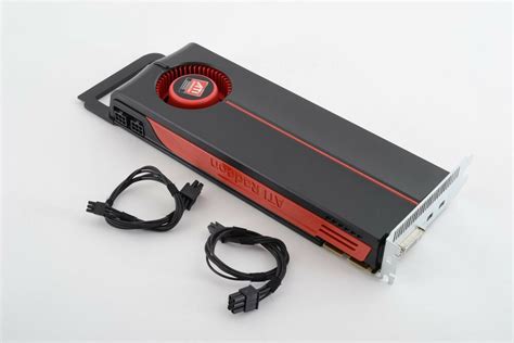

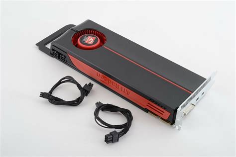

An Apple manufactured ATI 5870 looks like this . It has a distinctive port configuration ( One DVI and two mini-Display Port ) . This card will have EFI :
If your card looks different , it did not come with EFI from the factory . But it might have been EFI flashed afterwards .
Thanks for that, it's the same as the one you mentioned so it must be the the original or at least a compatible replacement.

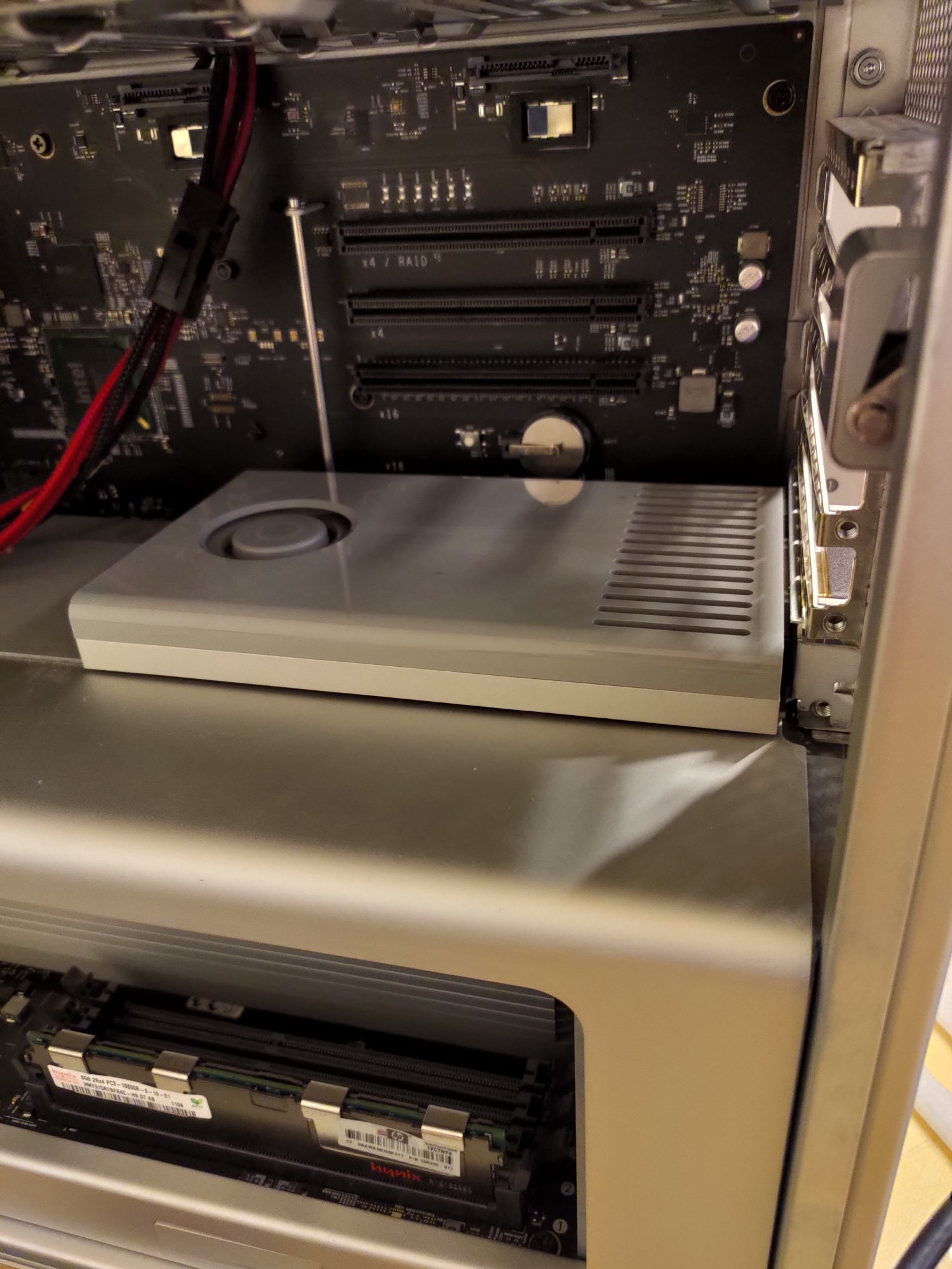

I realize I'm a little late to the party, but thanks to Snow Tiger I got this machine up and running again. I had the same problem as all the other guys in all other threads, until i was reminded how the O.G. display adapter looked (gt120) which I had packed away long ago.
Plopped the card back in and booted right up.
Running 10.13.6 for nVidia support and while setting this PC up as a gaming machine for my sis it suddenly blacked out. I tried all the tips and tricks but nothing but replacing the GPU with original mac graphics would help..
This will mainly be a windows machine so I'm not too worried it'll happen again, but now you guys know.
It works.

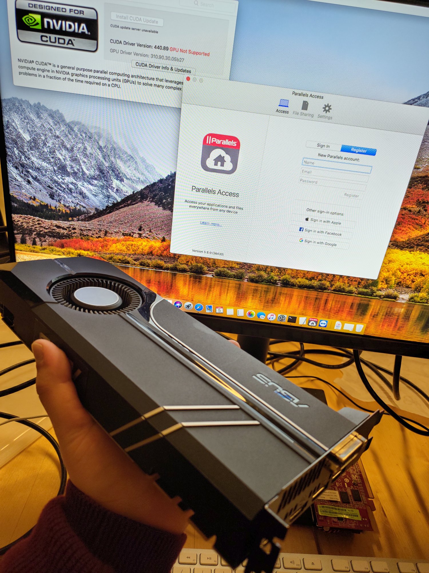

I have had a very similar issue as well. I bought a SAPPHIRE Radeon 11265-05-20G Pulse RX 580 8GB GDDR5 for the transition to a metal capable operating system which I didn't do yet. I'm using this on a Mac Pro 5.1 High Sierra 10.13 -I only had this installed for about a year and mid use my monitor went black. Tried all sorts of fixes, reseting tricks unplugging, holding down power button for programmer tone, switching locations for the SSD and GPU ect.
I've kept my old ATI and put it into the machine and it booted up properly and everything works. Not sure what the problem is but this is very disappointing for such an expensive piece of hardware to conk out after 1.5 years of use and have my old one still working.
