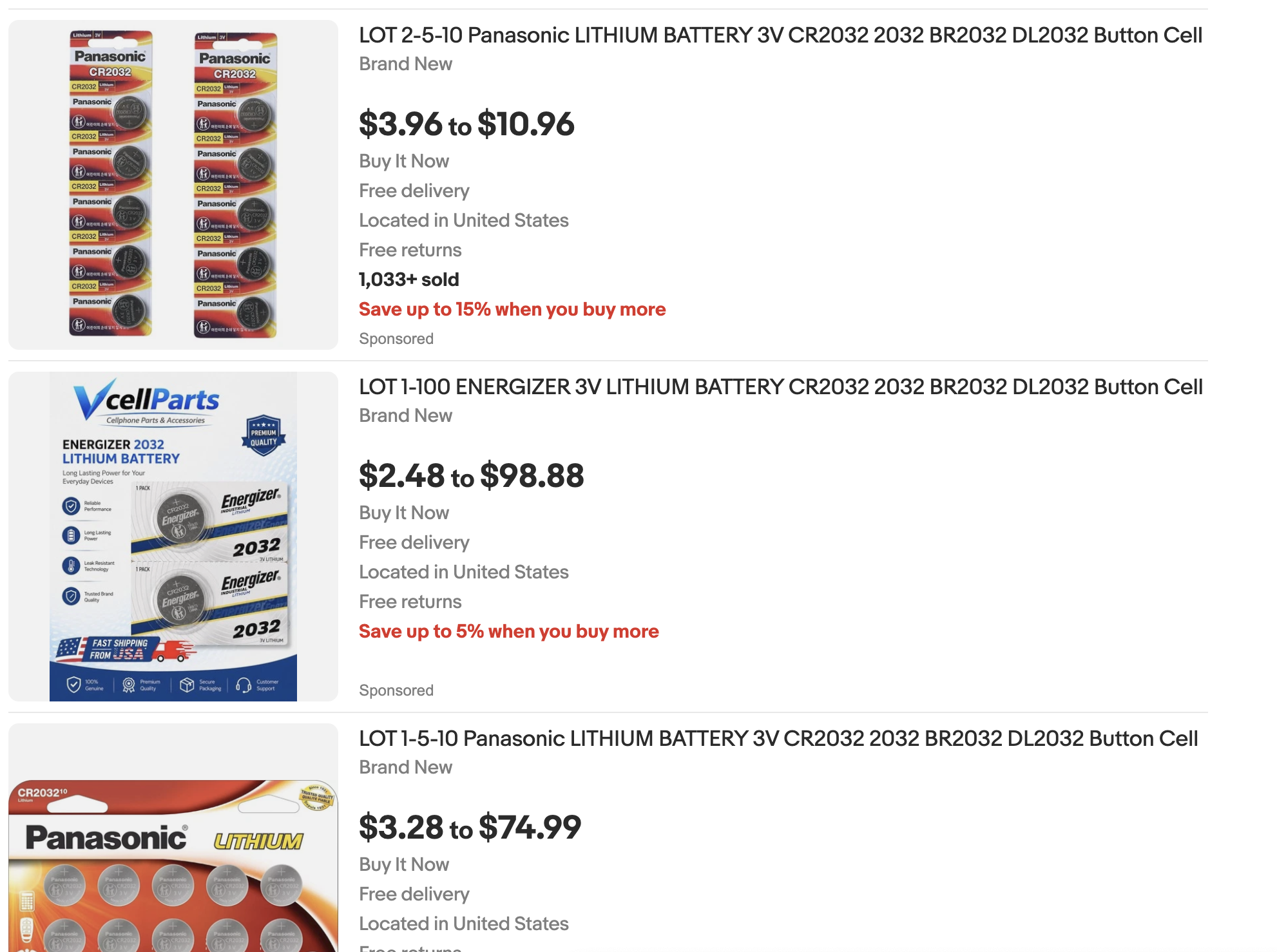

I am looking at these batteries on ebay, listed as though a batter can be a BR2032 and a CR2032 at the same time. How can I be sure I have a good enough one of these batteries?

As to eBay, if a battery says it's both, then it's likely a CR2032. They are interchangeable - the only difference is the temperature rating is higher for a BR. Check the product pic - if the product doesn't say BR, it isn't one. Scroll down the listings - you can get actual BR2032 batteries. They're just buried amongst all the CR2032s.

All consumer batteries (Duracell/Panasonic etc) will list multiple specs, but they are not suitable.
You need an ‘actual’ BR battery.
