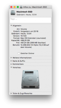

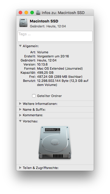

I tried it today! HFS+ (Mac OS Extended (Journaled)) don't make any difference. I have the same problem.
The terminal command is also a bit different, I had a bad syntax: no such file or directory!
The best to avoid this path error: drag and drop the USB Installer into the terminal!
It gives u the right path and then add at the end: (--volume /Volumes/(name of ur SSD) --converttoapfs NO)
So it must be something else. I thought its a good idea to try it, because I had that feeling it worked already once, when I switched from Captain to High Sierra, but I was not sure. Now I know: COMPUTER SAYS NOOOO! ;)

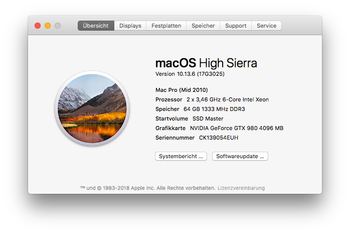

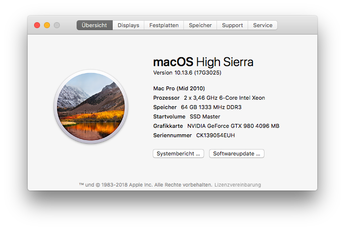

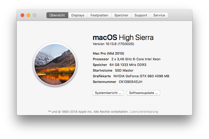

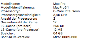

I have to press the "alt" key to select my SSD drive where High Sierra is installed and then he starts as usual. View attachment 804052 View attachment 804053
If you are able to get to the Boot Selection screen with the Option (or Alt) ⌥ key, then highlight your boot drive using the arrow keys on your keyboard, hold the Control (or Ctrl) ⌃ key and the the up arrow ⇧ will change to a reload symbol ↻, finally hit enter or hit reload symbol ↻, this should make the Boot Selection permanent.
Hope this works for you.
No luck!
No info!
Did you hold control? Did the reload icon appear? Did you click the reload icon? Did you Mac boot? Did you try restarting?
sorry my bad... ^^
yes the reload icon appears of course! i tried it few times...
my mac boots, but after a restart same thing again!
btw: like other people already metion, i also thinnk my gpu is not flashed correctly!
thanks for helping!
