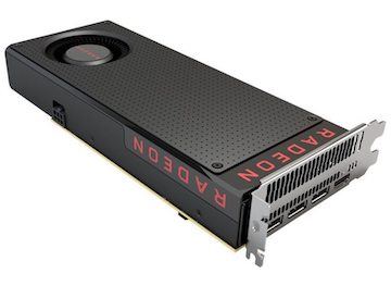

A used RX 480 8GB blower fan type GPU . Rebuild it with a fresh coating of Arctic MX4 .
Each one will give you three DP at 4K 60 Hz and one HDMI at 30 Hz . Requires only one 6 pin PCIe booster power cable . You can install two of them easily , if you have the slot space .
It's only 10 percent slower than a RX 580 , but it will not exceed the double wide space available in PCIe Slot 1 of the cMP . The official Sapphire RX 580 unfortunately exceeds the space available in that slot , so that card might press against an adjacent card .
Blower fan type GPUs will help cool the cMP , compared to open air fan type alternatives .
RX 480 Looks like this :
I’d love to use 2 of these, but have NO idea how rebuild them as you mentioned…
