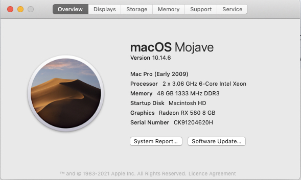

Hi there,

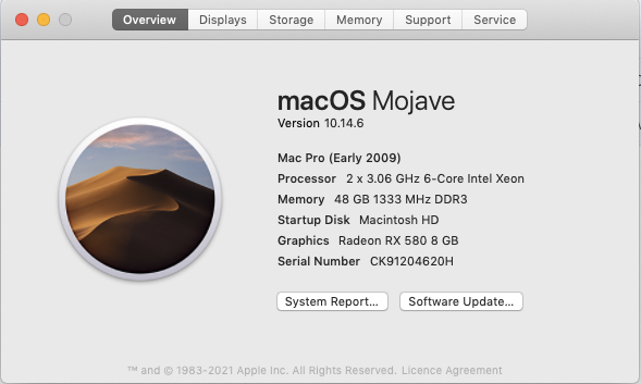

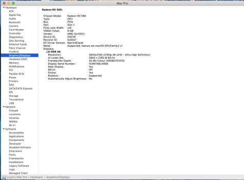

I'm hoping someone can help - I'm experiencing a strange fan issue with my graphics card that I purchased in 2020. It seems to intermittently turn on at the highest speed at random intervals - I've also noticed that just one fan does this instead of both. In fact, one fan isn't even spinning.
Any idea how I remedy the issue?

Then it may be overheat related. If one of fan doesn't move at all. This explain the cause of overheating and why the other fan have to work harder.

Again, thank you for your reply. If overheating is the issue, how can I check temperatures and how can I fix this problem? Any thoughts as to why one fan isn't even spinning?
From memory, Mojave can read the RX580's temperature natively.
You can try this command in terminal.
Code:
ioreg -l |grep \"PerformanceStatistics\" | tr ',' '\n'|grep 'Temp'
I don't know why that fan doesn't spin. May be bearing issue, may be loose wire, may be the motor is dead...

Thank you, kindly - I shall give this terminal command a go. I may need to contact Sapphire for further help if the card is faulty.
