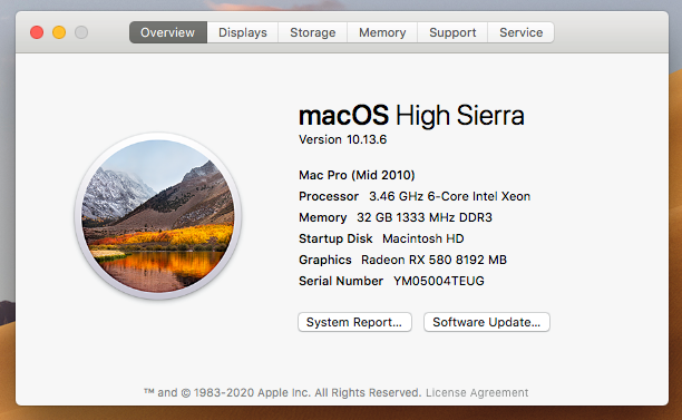

I recommend the 580 too, but I was lucky enough to buy one during summer 2019 for 180€. Right now, they are veeeery overpriced.
